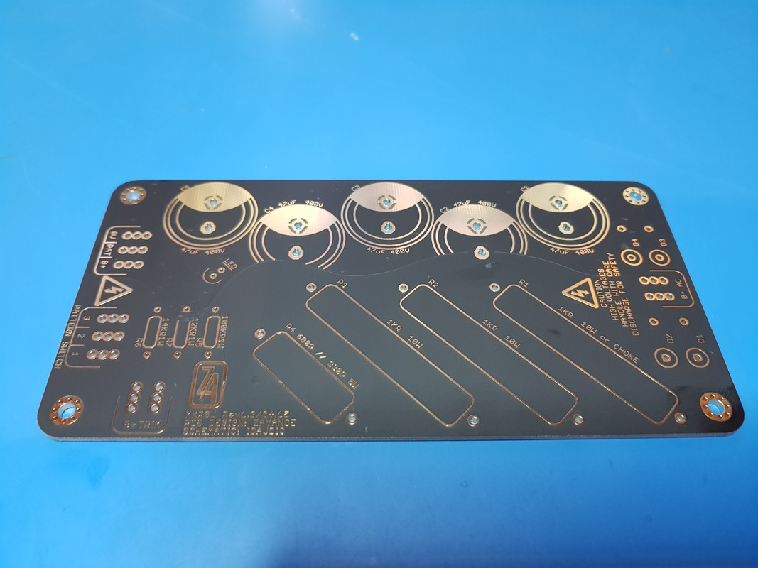

Tony,
Received the MK47 pcb yesterday.  Looks great and sturdy too!  It will be stuffed into Dan's psu case (just received as well).
Looking at the pictures, Questions
Does R4 have both the 680 ohm and the 330 ohm together?
R1 does not have the 1K ohm resistor, Just the choke connection, or both?
Hi Winetree,
Yes it means both together for R4 k ( or only one of them if during testing you need to tweak), the double slash is for saying in parralel, and it's true that I could have written "or" on R1 silkscreen to say resistor OR choke, but I tought that would have been obvious.
T.
Hey Zayance,
in case i don't need a pattern switch. which parts don't have to be soldered to the board?? can i leave some out??
i have a 2nd question regarding R6. is a 14kOhm with 1/2 Watt ok also?? i have two 1 Watt resistors which will add to 14,28 kOhm when soldered in series. will this work, too??
thanks
Hi There,
Depends on what polarity you want.
iirc Terminal block contact 1-2 gives Cardio
                                        2-3 gives Omni
I guess you want Cario and not Omni, and then you'll need to leave everything in place, but just jumper 1-2
I don't get your question, you mean you have a 12K resistor and want to add 2x 1K to get to 14K that's right?
Yes it's possible but that's a lot of resistors for getting there, values in parralel it will be more elegant onboard, any other combinations you have in stock? close to 28K in // maybe?? etc...
It will work, your .28 is just tolerances that are found on all the build, and builds allover this forum :)
Best regards,
T.
                                        2-3 gives Omni
thanks. good to know. but to explain my question a little bit. the pattern switch will be on the mic itself. therefore i need no pattern switch possibility in the psu.
so my question is, if i can leave out the 12k and the 14k resistor on the pcb?
my problem with R6 is, that i don't have any combination of resistors available that will give me exactly 14k. Which tolerance is alright for this resistor?? when i know i can measure my resistors and do some math to come close  ;)
or do you think a 1/2Watt 14k resistor is ok??? i have one of those around.
all the best
Yes you can leave R6-R7, but you'll need that voltage divider inside the mic then, well if you want to use this one for ioaudio's upcoming mic body and so feeding his reed relay? If not and you just want to redo an original deisgn, then you don't need that, and just feed the B+ inside the mic etc...
No it should be at least 1W.
all the best
I hope  :)
yes you're right. the psu will be for ioaudio's upcoming U47 clone/body. the latest info ist, that he will make the pattern switch under the grill of the mic, like it is on the original u47.
Well not sure if he will drop the reed relay, so for now better just wait and see, but the PSU won't differ i think, only pattern switch connector will be left out, and if somethings change for the "newer" model concerning it's PSU, with his approval, i could redraw the thing.
T.
