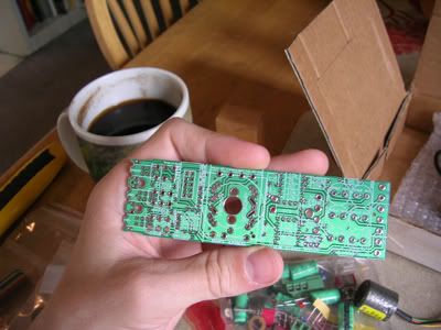

Here is the bare PCB and should give you an idea of how small they really are:

Note that there aren't any specific schematics for the configuration I have, but both have plenty of info to draw from and should be sufficient. Or they would be if I didn't have my head up inside myself. So here are a couple questions:
Should I be installing the zeners, resistors, and regulators in notes 2 and 3 of the first ("full") scematic? I'm using the 48v supply here. I am of course trying to find this info myself but perhaps having it here will help others...

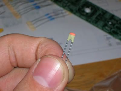

Here is a small capacitor and my dirty fingernails :oops: :
There are two of these. Are these the 0.1uf's that mount near the opamp? I've been trying to look it up but there are no other markings, and I cannot even tell what color that is.

The cap you are holding is a 47pF k series ceramic. This has text on one side in yellow but they are hard to read at the best of times but great caps otherwise.
The 0.1uF mono chip cap is a yellow or blue bead type in the baby animal kit.

You can actually see remnants of text on that cap in the picture better than you can see them with the naked eye. Does the color on top denote anything? I tried looking it up but found nothing relevant (just some stuff about old paper and mica caps).
I also see the 0.1uf cap (mine is yellow). That one actually has text on it that I should have looked up :oops: . I actually had some of that stuff printed out before but lost it.
