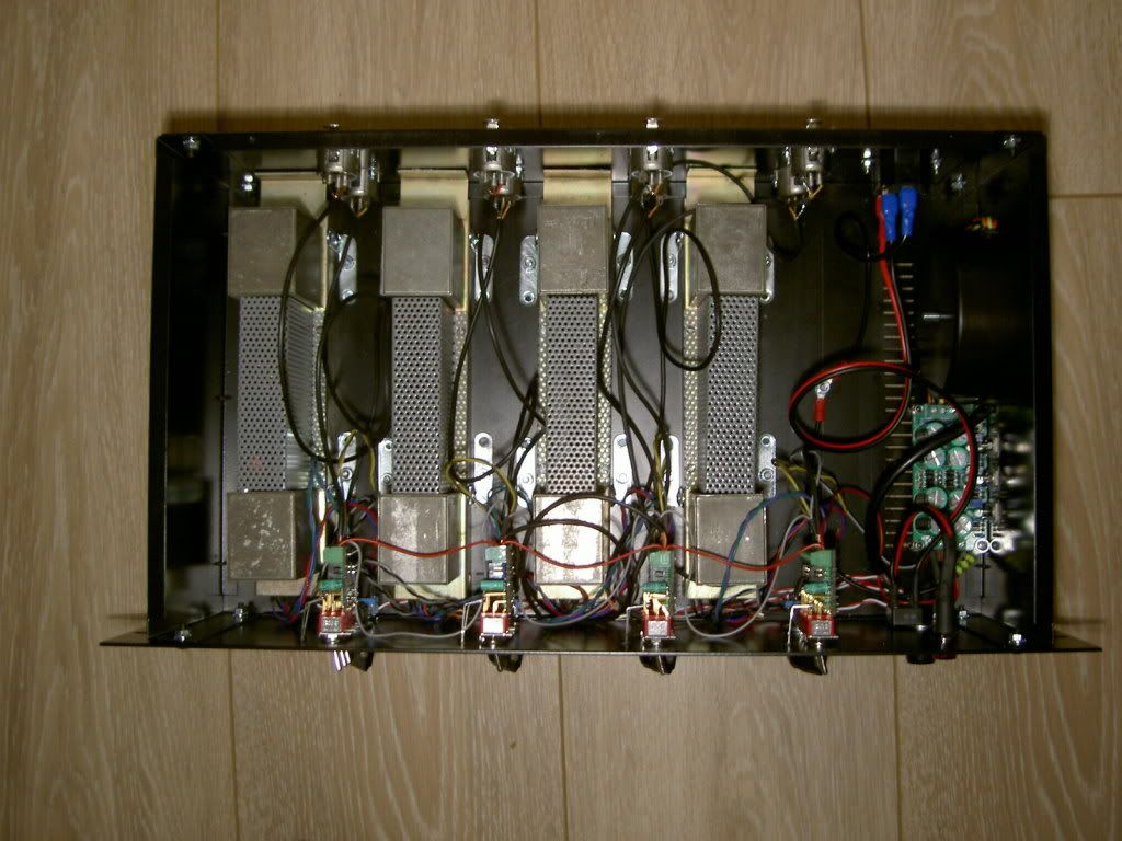

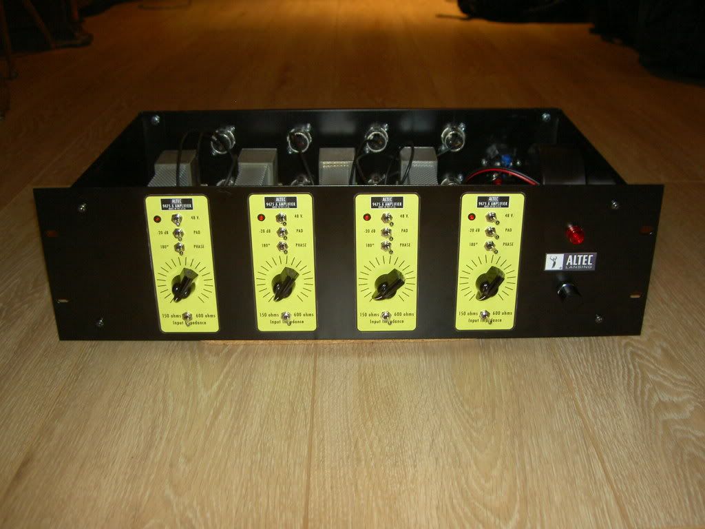

Hi !
So I've finished racking up four Altecs 9475A, there's still a couple of things that need to be taken care of (like channel 4 buzzing a little, will have to screen the toroid, clean the cabling etc...) but in the meantime here are a couple of pictures, please react !!!
I've used both JLM Audio's AC/DC power supply and Go-Between input switches, a toroid that's probably too big (50 VA, each channel needs 130 mA at full output, + 27dB...), the unit is dead silent except for channel 4, close to the transformer...
I haven't recorded with it yet but it seems promising from what I've heard so far !!!
If you have experience in screening toroids, I'd really like to hear it... Thanks !!!

looking good.  Put a solid sheet a metal between the PSU and preamp areas.  leave only the smallest access hole for the wiring to pass.    That big excess loop of mains wire is awfully close to channel 4 input circuitry.
Wow, you had to wire it the hard way, no trays!
« Last Edit: October 28, 2009, 04:56:48 PM by emrr »
Piotr
Re: Altec 9470A / 9475A rack-up
« Reply #22 on: October 28, 2009, 05:28:32 PM »
Hi Doug !
Actually I had two trays...but four preamps !!! And the trays wouldn't have made it in the rack, so yeah, wired it the hard way. I've deliberatly left too much wire so that I could open the rack and test and debug it, which I should be able to do in a couple of days, then trim everything aftertwards. I'll probably try a smaller toroid like 30 VA, which should be more than enough (this one was a spare from another project) and maybe reduce the buzzing. I'll try to screen this one anyway and see what happens !!! Cheers, Piotr.

My Reaction is:
Awesome job!!!  These look great - I really like the faceplate layout/build.  Altec all the way.
Congratulations on a job well done!!

Love it!! Thought I'd join the party with another 9475A rack-up.
