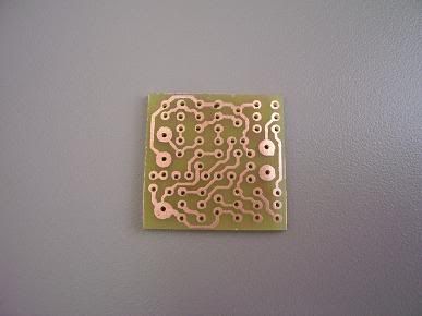

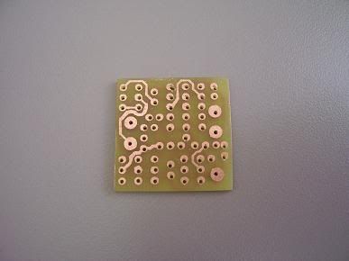

Thanks to Audiox PCB layout, successfully made a dual sided pcb today using laser toner transfer method
which works very well and much cheaper than any other method I've used to date. Still need to stuff the board,
then test. Used API footprint on both sides to keep the alignment of the traces & pads as close as possible. Had
to predrill two of the holes and line up artwork by eye before heating the last negative to the top side of the board.
Then final stage into etching solution. Last step drill all holes with PCB drillbit smaller than  #60 I think. Holes are little
off center in some places , but once solder coats the pads, traces and components everything will be fine. The
top pads without traces are of no use I suppose. Need to figure out a method for doing a sheet of these boards
and keep them all aligned, instead of one offs like below. Board measures 28mm x 28mm.
