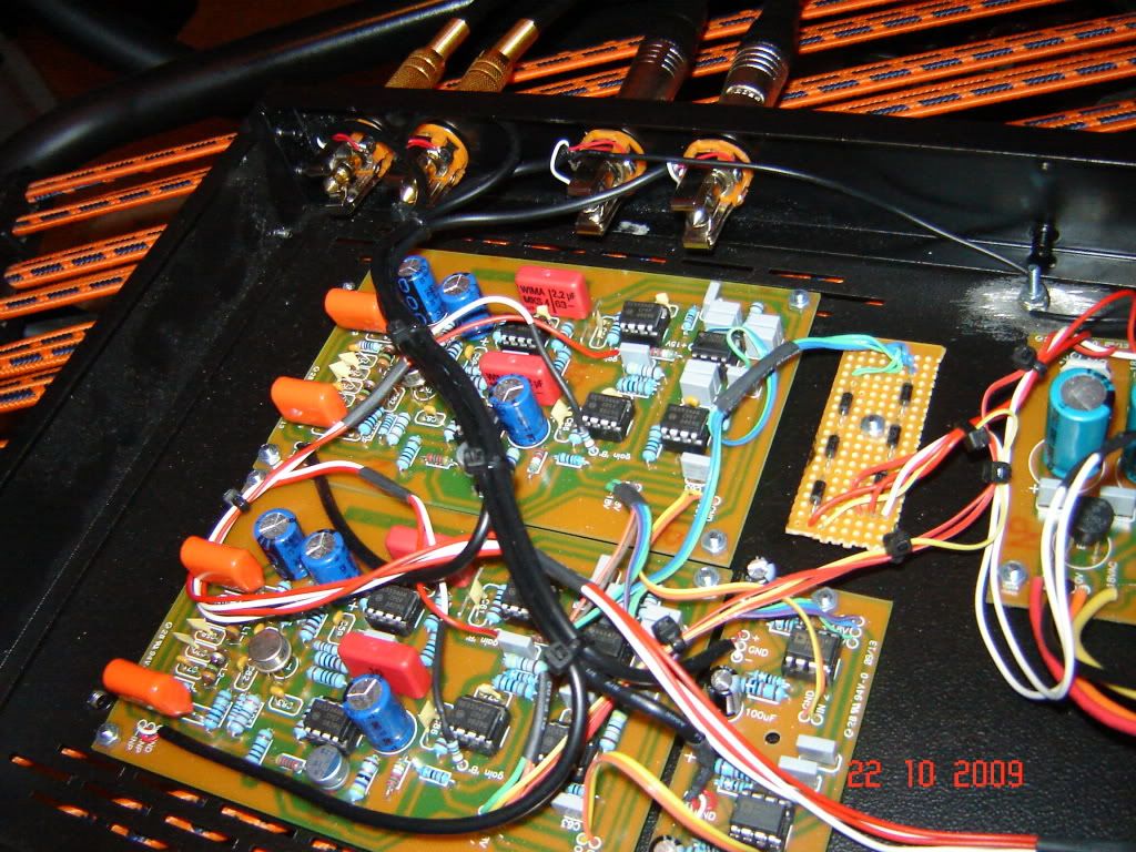

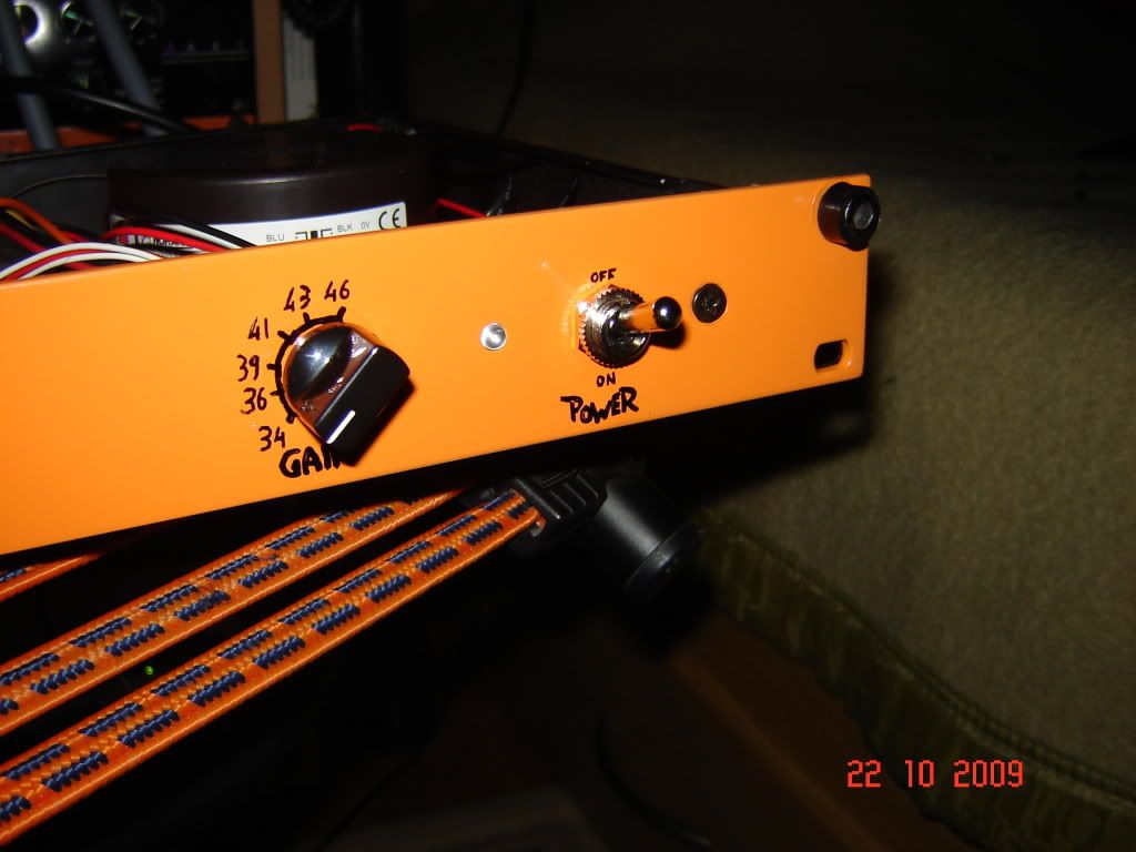

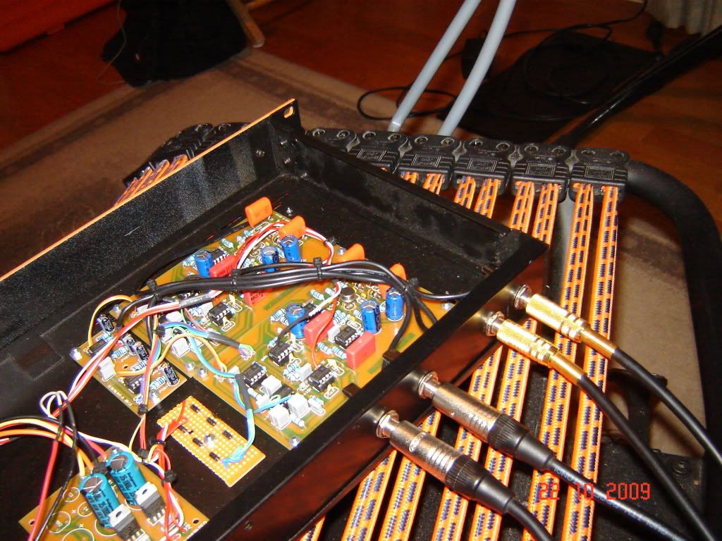

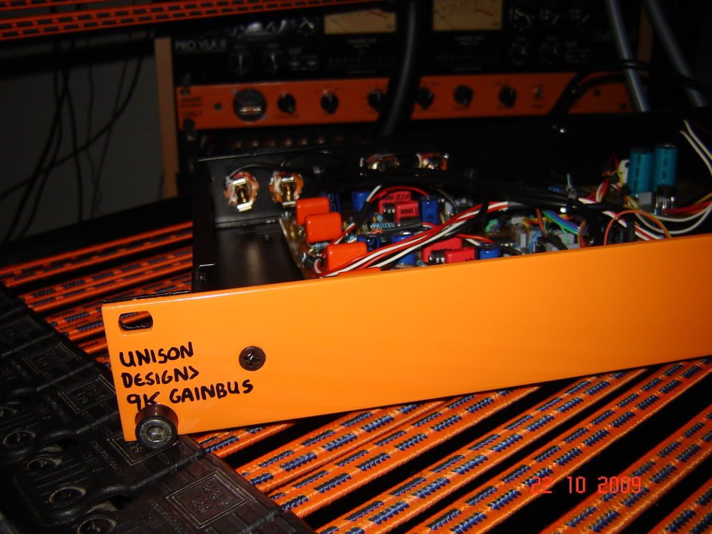

Here it is, the 9K "stripped down" with no +48V, no pad, no phase rev. and only 6 position gain switch, ranging from +34 to +46 dB, controlling both channels simultaneously (one pole per channel, "gain A" is fixed). Its purpose is to make up for my summing mixer's -40 dB loss. The paint job went pretty good, but I changed the marker over the one I used in gssl and it wasn't quite comfortable, so the labelling is not really that good compared to my gssl. Sorry for the crappy quality of the photos, too. Oh well:

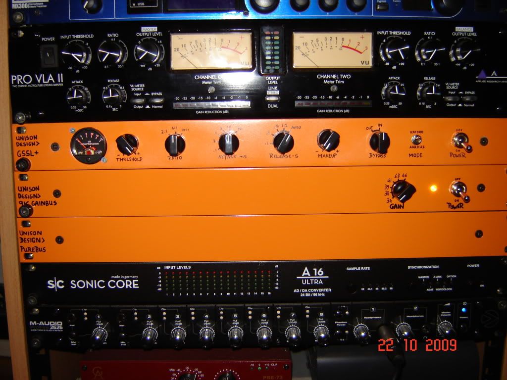

And a photo with its happy DIY companions  :) That makes three of them in two month's time (since I registered in the forum)

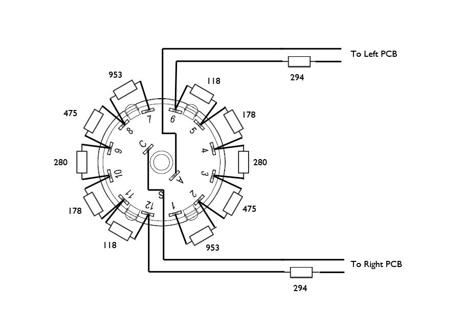

Here are the resistors I used for the gain switch:
6STEPS (34-46dB in 2.5dB steps)
Gain A (Fixed):
Ra   82R   28dB
Gain B:
Rb   294R
                Res.       Gain.     Total Gain.     Actual Resistor
Step1         952R      5.4dB    ~34dB          953R
Step2         477R     7.9dB    ~36dB           475R
Step3         278R     10.4dB   ~39dB          280R
Step4         176R     12.8dB   ~41dB          178R
Step5         117R     15.3dB   ~43dB          118R
Step6         0          17.8dB   ~46dB
And the equivalent drawing:

It sounds AWESOME, and I want to thank everyone for advising me to use that particular preamp as gain stage for my passive summing mixer. It is what I wanted, only better!!
Worked on first powerup, too!! Absolutely no troubleshooting was required. No hum , no noise, everythink worked right away. One moment I am checking the voltages, and the other one I find myself mixing with it!  :o :o Talk about lucky...

Thanks a lot Harpo, and thank you for your awesome advice on the gain switch thing! Having Ra fixed was a great idea!  ;D ;D I even hand-matched the two channel's gainswitch resistors (yeah I went crazy with that for no apparent reason)
