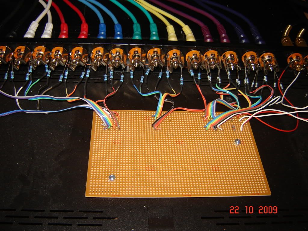

Not really much to say here.. Just the fact that I was going for the "Bus-Bar" thing that a lot of people do around here do, using some (tinned?)copper wires that stretch them across some chassis-mounted connectors (I don't know what they're called). But I couldn't do it right, it was really messy and I decided to go with a veroboard. The type that has parallel lines of copper. I couldn't find a smaller case that had the same faceplate with the other stuff I have built, so I got the same one and wasted a lot of space, but whatever!

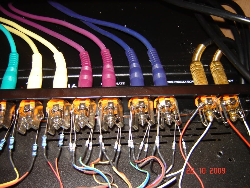

It has 16 inputs and 2 outputs (duh!), as usually, they're stereo pairs (1-2,3-4,5-6 etc) only the last four inputs are routed to both output channels. I did this because I don't want to waste stereo buses to put some things dead-centre (bass,kick,snare,vox), plus this way they're summed OTB, so I think this is great economy, since once I am done with the "mono" stuff I have 6 Stereo Groups to do the rest. I have made quite a few mixes in which 2 or 4 channels remain unused, so for busy projects this suits me just fine.

Nice summing box. Great job! I've been meaning to make one of these too. I don't understand how you routed the last 4 i/p's to both L and R out. Doesn't that affect the gain structure? the voltage would be halved, right? And the idea of a summing box is to sum instruments into a stereo group (so drums, gtrs, vocals, etc.). why would you want to have a separate i/p for kick?

Thanks a lot! The gain structure isn't affected if you use different values for the resistors in those channels.
The idea of a summing box is to have a better summing than the crappy algorithm most DAWs have. You can route through it anything you want clear with better definition and seperation. Instead of having the kick, snare, toms and OHs summed but the DAW isn't it better to have transient types of instruments into individual channels? The difference was breathtaking the first time I tried it. The way I built it, I think of it more like a console, but with controls in my DAW  ;) If I want, say, a guitar solo (not likely, but for the sake of the example) to cut through the mix without boosting its gain, maintain its spectral content psychoacoustically regardless of what the other instruments are playing, and make it really seperable from the rest, I might as well route it through a bus by itself. Like I said, this is a pretty fictional scenario, but you can imagine how good will that be for the vocal track, the transient stuff (kick,snare), and the god-awful bass hot notes. They all feel way less washed-out. Sometimes I even route my reverb by itself though a bus (helps retain the tail A LOT)

If anyone wishes to replicate this, this is the schematic:

I know this is an old post but it seems to be a good thread on summing mixers. I want to build one of these but am a little wet behind the ears when it comes to modifications. I would like to include an input level pot on each channel.
My question is, where would I insert the pot on the schemo and what value should I use? Do I replace the resistors that are already there?

Looks great.  Do you have the board insulated from the chassis?  It looks like it is bolted right up against the painted metal.  Make sure there is enough spacing or proper insulation away from the metal.

Those pix are a few years old...
To add some simple input pads, add dual pots, with the Rs tied to each wiper could add a variable pad to each mono input..
The stereo inputs could alternately use the dual pots in a variant on a H pad to trim the stereo levels.
