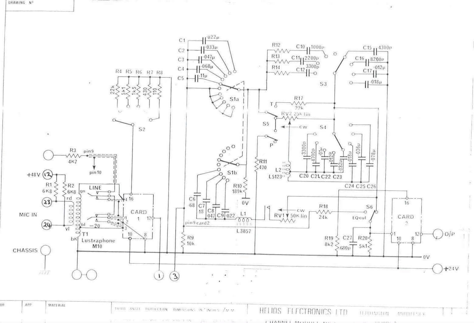

Sooo....I will have some time this weekend to start PCB design.
Need some input from you, lady's and gents.
My guess is:
Choice of input transformers for mic pre;
Same mic input amplification stage like used in older consoles (3-transistor's circuit);
Optional DI (HI-Z buffer) before input transformer;
RM-8 or RM-10 layout for HF inductor;
AFAIK the LF inductor originally done on iron or nickel lamination, small size core like EI-24...
if someone can put lite on this?
As line out amp, I'd used prooven second half of BA-283....fat, Class A, etc...
This will make actually a bit different thing, not like already commercially available
and will reduce headache caused copy-paste-righters....etc.
Insert after micpre? Line input option?
And, replacement for Elma switch to something cheaper, as well as (maybe) use of Lorlin switches+resistors
instead of potentiometers?
Your input wellcome. I think this can be really nice project.
Ah, yes....just a thought....Lunchbox format card wit EQ only????

It can be good to know material and core size for LF inductor.

LOL, I'm very interested. I've got a pcb layout for those amp cards and two sowter lustraphone copies waiting to be used. i even bought a small coil winding machine and i was just about to order some formers and core to try winding that low freq inductor.

What value is the LF-inductor?

i simulated the schematic a few months back with the values from various schematics and i got a value of 10H (this was confirmed in one of the posts here IIRC). I can't run the sim right now coz i'm at work so i don't know what the value is for the mid-band. But IIRC the mid-band inductor got varied in quite a few versions so there's no telling what the actual values were but i remember the values for the 2 tap inductor in one of the versions was more or less correct but i was planning on winding an inductor with more than 2 taps to match the values of the styroflex i have lying around.
for people that want more info i suggest searching the B-B-B-Big helios picture thread on Pro Sound Web. I'm still looking for the schematic that was posted on vintageking for the 2004 helios reissue, i found the first page, but if anyone has the other 2 pages could they be so kind and email it to sureshotstudio -AT- gmail -dot- com .

In case you wound inductors youself, $20 max for pair.
In case someone else do it....$40-50 maximum for pair of inductors.

Mabye Carnhill inductors from Audio Maintenance would be a good option. VTB 9043 for the bass, and VTB 9048 for the midrange. ca. 34€
Its hard to get the Bass cut/boost done without a expensive rotary, unless you limit the choice to two cut and three boost steps (read lorlin 6x2)
j
