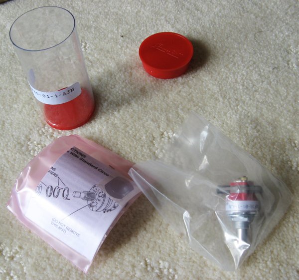

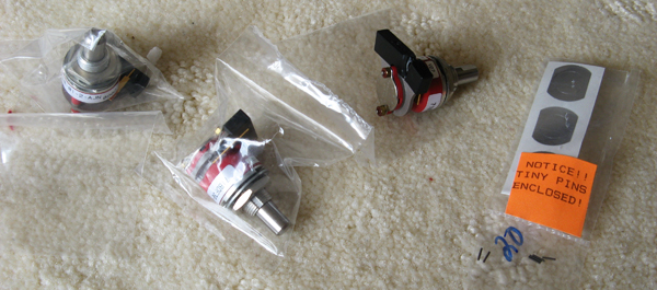

- 3 X GRAYHILL 71BDF30-01-2-AJN 6 way rotary switch
- GRAYHILL 71BDF30-01-1-AJN 12 way rotary switch
Should have stop pins for this rotary switch, either sent as;
- individually packaged in a round plastic container which contains the switch, stop pins and silver label
- bulk packed.... where we have to pack the pins and silver label seperately....

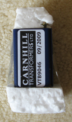

- CARNHILL VTB9046 Input transformer

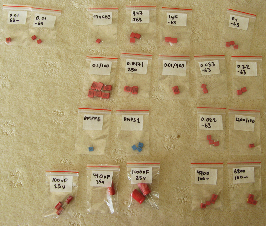

- Various Caps
DU-09-002 Capacitor: 100uF 25V 105 Deg C - Radial 3
DU-09-012 Capacitor: 1000uF 25V 105 Deg C - Radial 2
DU-09-018 Capacitor: 470uF 35V 105 Deg C - Radial 1
DU-09-1-1500 Capacitor: 1n5F 100v Polyester 5mm pitch 1
DU-09-1-15000 Capacitor: 15nF 100v Polyester 5mm pitch 3
WI-09-1-10000 Capacitor: 10nF 63v Polyester 5mm pitch (MKS2) 2
WI-09-1-100000 Capacitor: 100nF 63v Polyester 5mm pitch (MKS2) 3
WI-09-1-1000000 Capacitor: 1uF 63v Polyester 5mm pitch (MKS2) 2
WI-09-1-22000 Capacitor: 22nF 63v Polyester 5mm pitch (MKS2) 3
WI-09-1-220000 Capacitor: 220nF 63v Polyester 5mm pitch (MKS2) 2
WI-09-1-33000 Capacitor: 33nF 63v Polyester 5mm pitch (MKS2) 2
WI-09-1-47000 Capacitor: 47nF 63v Polyester 5mm pitch (MKS2) 1
WI-09-1-470000 Capacitor: 470nF 63v Polyester 5mm pitch (MKS2) 3
WI-09-2-10000 Capacitor: 10nF 400v Polyester 10mm pitch (MKS4) 1
WI-09-2-100000 Capacitor: 100nF 100v Polyester 10mm pitch (MKS4) 6
WI-09-2-47000 Capacitor: 47nF 250v Polyester 10mm pitch (MKS4) 2
WI-09-3-10000 Capacitor: 10nF 100v Polypropylene 5mm pitch (FKP2) 1
WI-09-3-2200 Capacitor: 2n2F 100v Polypropylene 5mm pitch (FKP2) 1
WI-09-3-4700 Capacitor: 4n7F 100v Polypropylene 5mm pitch (FKP2) 4
WI-09-3-6800 Capacitor: 6n8F 100v Polypropylene 5mm pitch (FKP2) 3
Translating cap values written on the capacitors as explained by Collin which I found very useful!
Also use your multimeter to confirm the values
It is normal to write the values in short form on the capacitors because of their size.
For example....
470nF would be written as either 470n
or
u47 (ie 0.470uF... but they never use a decimal point... so they write u470... but that is the same as u47)
Next there is a letter (J or K usually) which states the tolerance
then the voltage rating... so;
u47j63 means 470nF 10% 63volt
15nj100 means 15nF 10% 100volt
1n5j100 means 1.5nF 10% 100volt

"As you can see... the input transformer needs to be wired 4:1... primaries in series and secondaries in para.
2 goes to IN+
5 goes to IN-
7&8 go to OUT+
9&10 go to OUT- Ground"

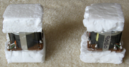

Hairball EA-1166 Output Transformer arrived and well packed!
Wiring:
Bottom of pic:
P+ = Brown
P- = Red
Right side of pic:
S- = Grey
Next to S- = Violet
S + = Green
Next to S+ = Blue
