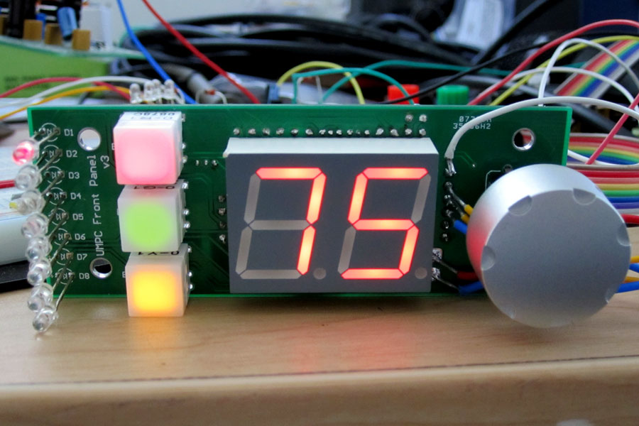

Hi All,
I've designed this a while ago but just now had time to build a prototype:
Basically, this is a QFN to DIP32 adapter but with integrated bypass caps as close as possible to the package pins. I've also separated the power supply pins of the 1570 and 5171, so one could run the 1570 at +/-18V and 5171 at +/-17V to maximize headroom, etc... If you don't want to do this just connect the same supply to these pins and you're good to go.
For people not familiar with this killer mic pre chipset - check it out here - http://www.thatcorp.com/DigMicPre.shtml
Pinout below has original pin numbers in () as per THAT's datasheet. This is a 15.24mm wide DIP 32-pin package, very easy to pop into any breadboard, etc.
Given the DIY difficulties to work with QFN packages, would people here be interested if I offered this package for sale in the next month or so? It would be the entire assembled adapter as on the picture above:
THAT1570
THAT5171
0805 X7R bypass caps x6
0805 C0G bypass cap x1 (for RFI protection, per individual request could be omitted)
Gold plated pins for DIP socket
Thoughts?

promixe
Re: THAT1570/5171 DIP Adapter - Digitally Controlled Mic Pre
« Reply #2 on: December 27, 2010, 11:27:43 PM »
Thanks! I have an SMT reflow oven and had a stencil laser cut for this project.
Have you looked into the digital control of 5171? Would you use a rotary encoder or buttons to switch gain settings?

promixe
« Reply #4 on: December 27, 2010, 11:53:43 PM »
We should probably have a new thread about this at some point (when a few people have this DIP adapter in hands) =) But...
I'd use this one - http://www.bourns.com/data/global/pdfs/PEC11.pdf
It's over $25 cheaper, takes less space and has the pushbutton integrated as well. I think for this particular application there is no point in going this high-end (i.e. optical AND Grayhill =).
I found that having less detents per revolution is a better feel for gain setting. Also, as far as the quadrature decoding is concerned, there are dedicated chips for this (like this one - http://www.usdigital.com/products/interfaces/ics/lfls7184/) or you can go Atmel's Xmega as it has built in quadrature decoding interrupt-free system. Otherwise there are some limitations with regular uC implementations, although some people might argue. Like having a plain RC filter on signals before entering uC, etc... I think Igor did his Wiregain PGA2500 pre with a rotary encoder, let me see how that's done...

promixe
Re: THAT1570/5171 DIP Adapter - Digitally Controlled Mic Pre New
« Reply #18 on: February 09, 2011, 05:55:12 AM »
Hi Delphi,
A couple of updates:
- Yes, I've ordered a new version of the adapter PCBs and should be receiving them by the end of February. The new version is optimized for performance a bit more and has some additional features I've been requested to add. More on that later, when I receive the boards.
- I also designed a PGA2500 adapter as DIP-28 and it's being manufactured right now as well. The adapter has the same exact pinout as the chip itself, but it's quite more than just a SSOP-DIP generic adapter you can get elsewhere. It is made with audio performance in mind and features bypass caps as close as possible to power pins and a split digital/analog ground with an option to stitch them together (which I prefer, and which PGA2500EVM doesn't have).
- Both adapters will be available for pre-orders on my website, which I'm currently building for that purpose. I'm thinking hopefully in a week or so, I'll launch the shopping cart and will post here, so people can start ordering.
- I've been working on a Universal Mic Preamp Controller for a while and am now putting finishing touches on it. It's a very cool chip as it will allow one to control up to 8 channels of EITHER THAT1570/5171 OR PGA2500, all selectable through a configuration menu, within a single chip. All one would need to add to it would be a 2-digit 7-segment display, two 74HC595's, 7 resistors, 2 transistors and a rotary encoder. No more then $5-10 of parts. It will be IS available for sale along with the adapters at the end of February.
- I have made a front panel board for this controller and will be manufacturing it ASAP as well. The board is pretty flexible as it allows for two types of 7-segment displays (0.56" and 0.8" sizes could be used) and two types of buttons (MEC 3F and alike, or Omron B3W-9000 series buttons). It can suit several brands of rotary encoders as well and is just 120 X 36mm. Again, a single board/controller can work with up to 8 channels. You cannot mix PGAs and THATs in one design, but any number of one type up to 8 channels. There will also be a Front Panel Express template for this board so people can make their own front panels to align perfectly with the board.
Hopefully all of this will make some DIY people drawn more to these really cool chips, as the two hardest parts (that is reflow-soldering QFNs/SSOPs and UI/SPI-controlling them) will already be done with. =)
