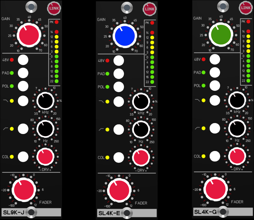

Hi Friends
Since the last weeks i'm redesigning this loved SSL Preamp(s) I also build and own them from the beginning when beloved Joe Neil designed them for us. I thought about to make them more versatile for more recording and live situations
i used the shematic of the 9K, 4k transformerless(4K-G) and 4k Transformerbased (4K-E)
Stepped recallableSwitchable Gain on all Modules with Grayhill Switches
1646 Output,
48V, PAD, POL,
frequency selective HIGH and LOW CUT,
Colour Option (DIYRE) also include a colour mode without adding an extra colour module.
Output Fader
Level Indicator Meter switchable After Fader or after Preamp.
Peak LED after Preamp
I use AS194H in 4k-G and 9k-J
Its running on +16V/-16V+48V in the VPR or 51X Rack
Will open in next days when prototypboards are here a new thread, thinking about to offer full kits
Interest?

Very Nice that you included an Output Level control,
I love to drive into distortion the 4K G Series Mic pre.
As for 4K transformer less Preamps, there's 2 if I can remember correctly. There's the E-series Transformerless (Last Version after the transformer based) and the G Series .
Really Nice Work,

Kevin you are incredible !!!
Waiting for a 4k for years!

I've never needed a Low Pass filter for tracking tho... but I guess it never hurts to have it in your toolbox.

yes please

To clarify a bit I use
SSL 82E149 transformerless thats formerly also a E Series but with two LM394, The G series is a bit similiar from that circuit design.
SSL 82E01 Transformer based with JT115K-EPC like the original used on the cards
and the SSL 9k found in the SSL tech docs
I will use switches for gain for all my designs
Not as used or useful has the HPF in tracking but still it's useful and doesn't hurt to have it.
Ex:
- shave some high end on E Guitars above 5Khz if it's an heavy session and you need space on the top end
- take some high end off the Bass, or even make it muffled if you want
- Make a condenser mic sound more like a Ribbon, or reduce Brilliance in any over bright source or mic
There's many more uses that I can't remember right now,
It's a tool, I think it's nice to have it, but what really does it for me in this project is the Output Volume control,
that one I really missed in previous 4K preamp projects

Hey Kevin,
Due to Italian endless lockdown, I'm working on kinda the same thing since last summer, with different (let's say) extras tho  :D
Let's see what we get

I like the visual look of these.  What software are you using for the 3D mock-up?

i would definitely order at least one kit

Hello Kevin,
how is the development going on?
If you offer full kits or front panels, could the the color be Grey (SSL eisque) instead of Black?
The Grey color could be more interesting
Thanks, Best regards
