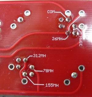

Inductors.
I used local supplier for inductors, and added VTB9054 package on PCB which one of guys shared with me.
I never tested the EQ with 9054, as I wrote.
So...here we go.
I will order 30 inductors this week, they will be ready within a 10-15 days; a part of them will go for my use,
the rest will be offered for low as possible cost at web store, it comes up with all possible worst case conversions about USD35/pair.
The PCB, BTW, shows inductor's values,
And of course, you can use your DIY inductors as well.
Take a core, wire, make 100 turns, measure, calculate Al, here we go...at all, this is DIY.
Please note the dot and right placing, if use my inductors:

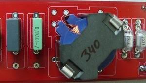

Here are some pictures of another assembled unit (I did 5 till this moment).
http://s251.photobucket.com/albums/gg291/diy33609/PULTEC_MS/Pultec_SugarHill/
You can use these photos as "build pictorial".
Mind the power trafo placing, this way, I got best possible S/N.
Here, Ed Anderson's transformers are used, and they sounds awesome. The input is MIC INPUT (EA10468) wired backwards.
It's "secondary" used as primary, holds 20Hz, +18dbm with 0.4% of distortion. Good point to get some nice color from pushed hard unit.
At +4dbm, the low freq. distortion is absolutely negligible.
Both input and output tranny's have perfect windings symmetry, this allows to have
about 75 db L/R separation after LR-MS-> MS/LR processing, which is nice spec for passively MS'ed unit.
