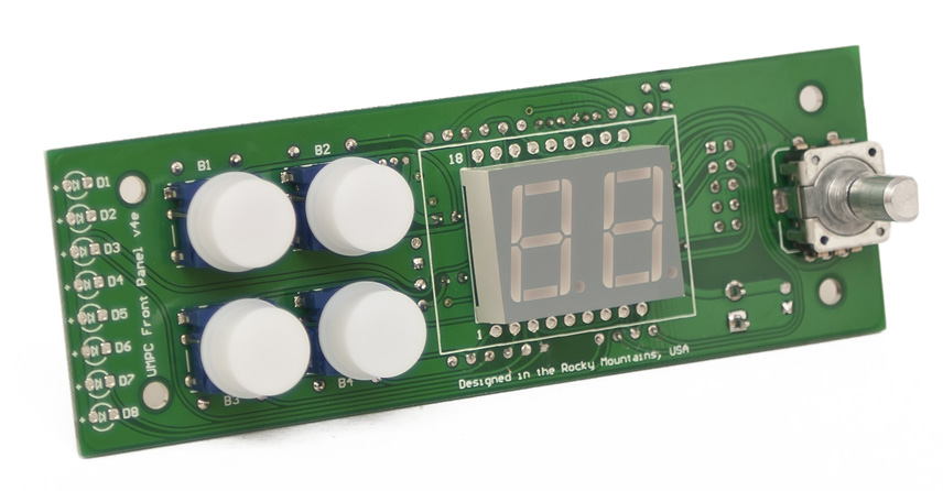

Essential UMPC Front Panel info:
You basically push all four buttons on the front panel, then turn on the unit and hold the buttons until the animation is over (about 2 sec. or so). Then you are in the configuration menu:
-A: Global mode of the firmware: "TH" means standalone mode for THAT5171 - use this mode when not using the MIDI Remote board and controlling the preamps directly from the Front Panel. "FP" means the Front Panel is in slave mode with a remote board attached to it acting as a master. Use this one in conjunction with the MIDI (or the upcoming Ethernet) Remote.
-B: The number of channels in the system + Connectivity Test: When in standalone mode this selects the number of channels in your build (then the firmware knows how to cycle between channels correctly). Also you can "sweep" all of the channels to check for connectivity with the THAT5171 chip. If your addressing on the preamp PCBs is done right then each channel # is going to display a dot "." next to it - this indicates that it sees the chip and can read from and write to it. If there is a "E" next to the channel # then the firmware can't talk to that chip. Either your addressing is not right, or the channel is simply not there. When the Front Panel is in Slave Mode ("FP" in menu A) this entire menu B is not available because the MIDI Remote automatically discovers number of channels sequentially upon startup. Which means that if you number (via resistor addressing - see Lucidity docs) your, say, 4 preamps #0, #1, #3, #4 then the MIDI Remote firmware is only going to discover the first two because when #2 is not responding it stops discovery and works with what it found so far.
-C: Adjustment of the displayed gain: You use this one to set the top gain value offset that your preamps have. Useful if you customized the line driver stage to boost or attenuate gain past the preamp and want the gain to visually represent this change. The bottom limit of the gain is calculated automatically by subtracting 55 steps from the top value. THAT5171 actual gain range is 13-68. If you used the values for the line driver from the schematic you set the menu C to either 70 or 75 (because the line driver has either +1.4 or +6.4 dB of gain past the preamp stage) and it is then accounted for in the UI. This is a global setting - you cannot have channel based adjustments for this one.
-D: Recall preamp state upon startup: If set to "Y" the firmware will recall all of the settings for each channel (gain, GPIO, last selected channel) when powered up. When set to "N" it will load default values (no GPIO, gain set to minimum, channel #1 is selected).
-E: Exclude GPIO from being recalled: Use actual GPIO buttons to set up a filter of which GPIO to skip recalling upon startup. Say, if you wanted to recall everything BUT the Phantom Power state (because you don't want to damage your mics on power on) just push the Phantom button and it will recall everything else but this function. This menu doesn't work if "N" is selected in menu D.
-F: Firmware version: a simple way to check the version number of UMPC Front Panel firmware.
-G: Group button behavior: When "G3" is selected the GROUP button (bottom right on the PCB) switches GPIO3 output of THAT5171. Use header H5 on the preamp PCB to utilize this function to switch custom things like an insert, etc. When "GP" is selected the GROUP button groups channel GAINS together. GPIO functions remain separate. The grouping behavior is what I call "Soft Grouping". Aphex 1788 user manual does a good job of describing this on page 33:
"..computes the modified individual channel gains in an invisible workspace that can retain over- and under-range values. This allows the unit to be able to restore the channels’ gain relationships if you reverse the direction of group gain shift after one or more channels have limited out."
To exit the config menu you reboot the unit. Hope this can get people started. Good luck! =) Questions - ask away here! =)

Also, make sure that you solder the uC socket on the front panel BEFORE the LED 7-segment display on the opposite side. Otherwise it's impossible to assemble. =)
Another important thing: You should cut pin 7 of the LM2676 before you solder it to the PCB (or after you solder, doesn't really matter except that it's easier to do before soldering). Pin 7 is the on/off pin, rightmost one if you are looking at the front of the package (closest to C21), and if it is left connected to the PCB the reg will go into standby mode and not output anything. Took me a bit to trace, and I will fix this with the next revision of the PCB. =)
Also, to make the bipolar rails as symmetrical as possible you should match R4/R6 and R3/R5 with a DMM as close as possible. Not the absolute resistance values but just so these pairs match each other's values as tight as possible. Not a requirement, but I think it helps.

Btw the red Omron switches were out of stock with a very long delay. I took this model instead http://www2.mouser.com/ProductDetail/Omron-Electronics/B3W-9000-RG2N/?qs=EHIUIbu4Vmga69L8Ovky9BEPnglzbO77
in the same serie...
It's a two led model (red/green). I was hoping to make it work as a single red switch by letting the green led unused. Do you think it could work. I've looked at the documentation but I  can't be sure...
Yes, it should work. You have to find the right legs for the RED color (test with a battery+resistor) and cut off the GREEN legs and then orient it the right way prior to soldering to the PCB. Just take your time with this one and pay close attention to how to solder it in the right way. But I don't see a reason it shouldn't work. =)

FIY, the UMPC Firmware chips - the one with the white marking (ATMega48) goes to the MIDI Remote board and the one without the marking (ATMega88) goes into the Front Panel.
Also, before you plug in the PSU: you need to insulate all four regulators on the PSU from the heatsinks and each other. Make sure they are not touching neither the heatsinks nor the other regs, because all of their thermal pads are at different voltage potentials and shorting them together would not be a good thing. =)

Wiring DONE! Ready for testing!
Before I do something wrong... :P
On the preamp board:
Do I live J3 and J4 open?
Midi/Front panel board:
There is a two pin header labeled "prog" on the midi board do I have to connect it to the Front panel?
What should I use to do that? Plastic film?
Thanks again for your support.
