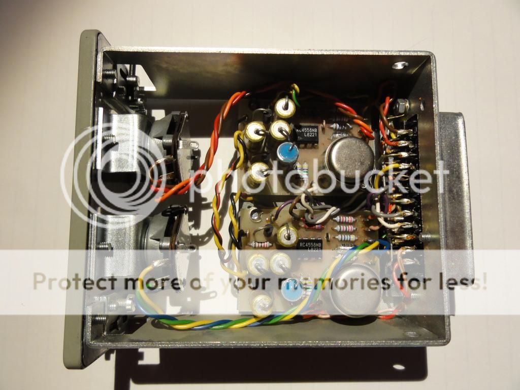

Hi, I read a lot of things but can't figure what would be best to have pads on the input and output of my AM16s
I read I would need a "T" pad, but then read other thing which say a "H" pad is needed to keep it balanced...
All I know is the AM16 want to see 600 ohms all the time at the inputs and outputs to perform correctly
Any help please?!!
Best regards
CJ

AM16 can be strapped for 3 different input impedances, and at least 2 different output.  The manual can be found online if you don't have it.  At 600 out strapping it likes an output load between 600-1K, higher and it has a large treble boost from ringing.

> make input and output unbalanced
It's transformer FLOATED. Not intrinsically "balanced".
Unless you need incredible precision, a simple pot is fine.
At the input, if leads are just a few inches, a 1K pot is fine.
Considering the OUTput level, and modern gear impedances, I'd use 620 ohm 1/2W fixed and a 10K pot across that to trim the delivered level.

I used this output attenuator that Winston O'Boogie drew for me with my AM16. I used the right hand one with the 301R resistors, eems to work fine.
If you short pins K & H it puts it into high power output mode (+24dBm as opposed to +18dBm), but that also doubles the harmonic distortion & unsurprisingly doubles current draw from the PSU, therefore making the AM16 run hotter.  In the manual it says to keep them ventilated.

I do not think this is possible with a transformer wired to 50 150 and 600 ohms.  If Im understanding your question correctly.
This is how I wired my in the past (left side unbalanced). I also used a stereo log pot.
I think the right would be the same as putting a 620ohm between pins 2 and 3.  I am trying it this way with a 10k log pot to match the modern equipments imp. If the math is right this will give me between approx 585 to 600 in adjustment.
I also have a Mallory T Pad 600ohms (someone is selling a bunch on ebay right now). I may use this if I can get it to fit. Probably not though (its too wide).
The input pad is where I get confused. JLM has a variable pad with a 1k log and a resistor...  I know its simple but Im having brain fatigue from reading so many posts.
Also, has anyone added a pot to R1 to adjust gain? Is a 250ohm pot too much?

A fixed, switchable 20db 'U' pad is your best bet.
'Usually you see a switch which adds a 620 ohm in series to each
balanced input wire and a 169 ohm that shorts between the two.
This will give a 20 db pad. '
It's the best match and is recommended as the most transparent option.
There's a discussion here
http://groupdiy.com/index.php?topic=139.0
