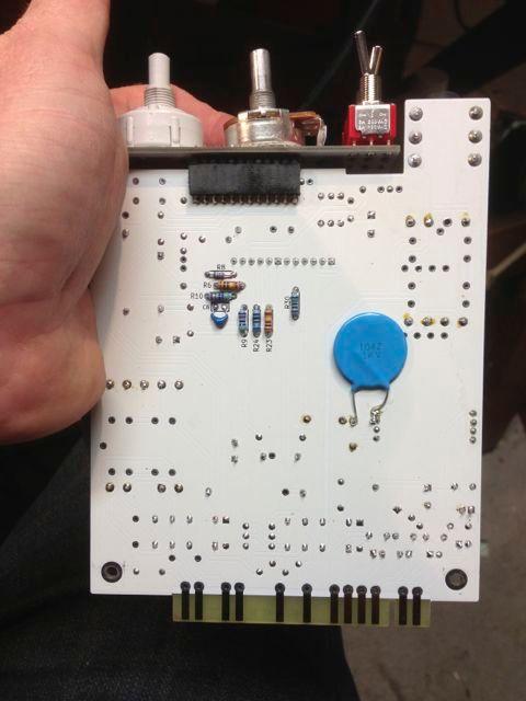

Now the control board-
READ ME!!! This is important! There are two SPDT toggles, one of them is on-off-on, the other is on-on. The one with only two position is SW4. It goes on the right side. The on-off-on is for the HPF and goes in the middle.
Also make sure to have all the notches on the switch bushings going the same way, so it doesn't drive you crazy later. ...because it will.
Stuff all the resistors and the two HPF caps FIRST. This PCB will hold all our front panel controls, so there's really no need for any of the anti-rotation locating tabs that come on the pot and rotary switch. Just snip em off.
That little round peg needs to go.
You will ruin everything if you don't do this and I'm not going to feel bad for you.
[Note: The alpha switch version of this switch will also work. It's from Taiwan, but personally, I've been seeing better quality with them than with the Lorlin switches.]
Now, I had soldered the big rotary switch in first, but you could probably do them all at once. AGAIN, stuff the resistors first, despite what you see in these photos. It's not a game ender, but some of the resistors are close to the rotary switch. You'll end up melting some plastic, and that will make you look dumb if you ever want to show off your handy-work.)
Remove all the nuts and washers from the toggles, except for one, use that one as a stopper to get the right clearance between the pcb and faceplate.
Bolt the faceplate to the switch, this will help you line up all the toggles in their holes.
Double check everything (triple check that the on-off-on switch is in the middle, not the right side!) Solder them in.
Remove the faceplate from the switches. Grab your metal bracket (if you have one) and place the potentiometer (sans locating tab) through it and into the faceplate hole. I made these hold snug on purpose, BUT- it appears that the fab house won't be winning any awards for precision there. Some of them are very snug, so you can actually thread the faceplate onto the pot bushing. I actually prefer this but this will possible create a NEW problem: While the main board will be serviceable and removable, the controls board will be stuck onto the faceplate and bracket permanently. I'd double check your gain resistors for errors and check the soldering joints. If this is something you don't want to worry about, you have to open up the hole a tiny bit with a drill (just use it as a reamer) or a small round file.
Get the pot flush to the faceplate or bracket, you will see that the pins look like they're too short. Stop whining, they're not too short.
Okay they're kindof short, but they're just about flush with the back of the control pcb. Solder them in place with plenty of solder. A cold joint here would be easy to accomplish if you have a dirty tip.
Not pictured (because I forgot to take a picture of it) is the SIL connector on the control board. It goes on the back side facing the rear of the unit, in case that was not obvious. Now you're done with the control board.
Populate the main board with all the small components- caps, resistors, relays, for now just ignore the two pads marked "FIL". Also, do not solder in the instrument jack just yet.
I cut all my leads very very short after soldering but this is especially needed in the power cap section, more specifically c26 and c27. They will be awful close to the bracket mounting legs and while they do not touch on my build, they can and WILL cause a dead short to ground if you have a long lead sticking out into it.
See here:
Nothing touches, no shorts. Make sure all the leads are cut as short as possible! Double check with an ohm meter on all the power rails to be sure you have no continuity to the bracket.
Now, before you solder the instrument jack to the board, make sure it's perfectly flush with the front edge of the PCB. Bend the leads so it will hold itself to the board, and tack one of the leads closest to the bottom edge. You may want to test fit it in the bracket/faceplate now. Don't use any of the supplied black plastic washers, just the one bezel for the front. Just mount it hand tight, then check PCB alignment.
The mounting holed should all line up perfectly. You may go as far as screwing down the rear of the board to the bracket. Then if an adjustment is needed, just reflow the one tack you did and get it all straight and legit, son. The board should be flush to the bottom of the jack.
Everything all lined up:
The mounting holes in the bracket on the rear legs are just the right size to hand thread a 4-40 screw without a nut needed on the backside. Thread it through and cut the excess off so they don't interfere with other modules in your rack.
A couple notes on the main board:
1) Mounting the tube board to the main board: The outline on the main board shows exactly where the tube board should be located. It needs to be very flush to the main board, no space under it or you'll be penalized for going out of bounds. A SIL12 90 degree header could work here, but the plastic retaining block will get in the way. I just used solid core wire, or a bunch of little resistor leads off the floor.
2) The pin head under the main board, which connects to the control board IS meant to be a 90 degree SIL12 header. Plug it into the header socket on the control board, THEN move the main board into position and make sure everything is fit correctly. Also make sure you've stuffed C10 first, and that it's leads have been clipped as short as possible or you'll run into trouble.

Do i understand correctly that when finished the control board will be removable by was of the SIL socket, but the tube board will be soldered onto the main board due to clearance considerations?
"it was like heaven on earth, all those transformers" - cj
gemini86
Re: [BUILD] GIX-51X tube preamp
« Reply #18 on: January 10, 2013, 01:54:09 AM »
Yes, the control board plugs into the main board underneath, and separates, but the tube board does not unplug from the main board, this is for rigidity. Once everything is bolted together, the tubes can be pulled out and put in without anything flexing or breaking.
- Rodney
