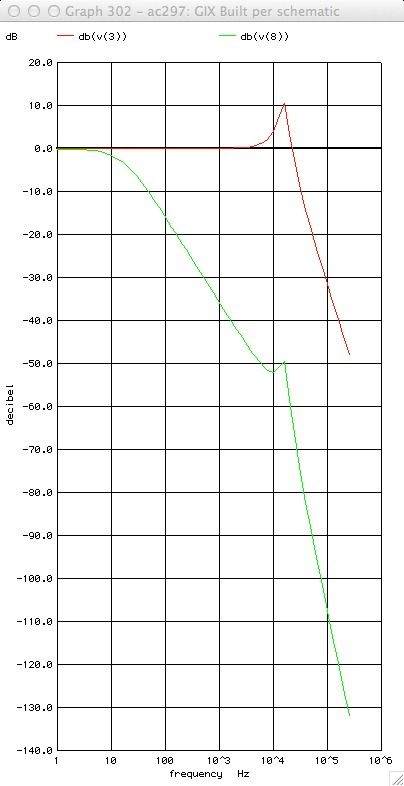

Updated table with more data
The build as designed and specified works fine!
I got a personal message from one builder concerned that he was biting off more than he could chew, and I realized that my obsession with PSU noise might be disruptive.  So by all means build this lovely project, it is really a nice bit of work. The "Stock Build" works fine.
Most of us with GDIY 51X racks have gone to the trouble of building big linear supplies and keeping switching noise out of the system, and this HV supply is necessarily a switching supply, so what I am trying to do is to mitigate any effects of putting this in my GDIY 51X rack, but I admit most of the noise I have detected so far has been on the bench and NOT on a set of speakers.
The relatively high noise levels in the B+ power supply is mostly not audible.  There are four noise sources I am working on:
  • Fixed by the "Rodney Cap" mentioned here: http://www.groupdiy.com/index.php?topic=51020.msg649756#msg649756. This is a nearly triangular Low Frequency Oscillation in the 60Hz to 100Hz, very audible.  This goes away with the Rodney cap (which BTW can be a low voltage cap 6V or more I used 50V)
  • High frequency noise of the same frequency range as the Switching Frequency.  Generally I want this frequency to be higher and variable (white noise), so that the noise is farther from the audible spectrum because I am concerned about harmonics.  This noise can be heard as a very low level hiss and whine (with the gain at MAX) I have heard it in the stock build Update: I think that this was radiated noise being picked up by my signal generator..
  • Noise induce into other components by the radiation of the inductor, which is substantial. This is a high gain preamp and is susceptible to radiated noise. Depending upon build, and transformers, and caps I have heard this feedback as I move objects closer and farther from the inductor, and this is why I have been working on shielding.  That said, some of the PSU builds don't have this problem. In this video you can hear it yourself, just recorded on my phone. http://s1221.beta.photobucket.com/user/Bruce0/media/G1X%2051X/IMG_1542_zps9f9d1029.mp4.html
  • A gentle LFO at 4 to 7 Hz. :-X. Note: This LFO does not exist, it is noise induced into the oscilloscope probe from the field of the power inductor
I don't have enough experience with the G9 to have an expectation with respect to noise level.  In fact I have a rack mount G9 I am building to try to find this out, but i have been delayed by the Par-Metal puzzle.
I bought an assortment of inductors and Sense resistors, and I have fried a couple of MAX1771's (ouch) and here is a summary of my testing, and some test data:
I have a longer writeup of this, but in general it is a balancing act. Smaller inductors generally lead to higher frequencies but if they are too small the regulation feedback pin never gets near enough to 1.5V to trigger, and if it gets too far out of whack it defaults to the maximum (16.5usec - 46K Hz) or sometimes to non-oscillating continuous mode ("Amplifiers do, Oscillators don't"). Larger Sense resistors generally increase frequency but to a point, but interfere with regulation, and tend to produce consistent frequencies.  I am searching for a balance of high frequencies (100kHz to 300kHz) that vary like white noise.
Update: Note that the ripple current increases as the inductor size decreases, and can get to be a very large current.  It is better to use larger inductors if you can maintain the voltage and frequency.
All of these measurements are taken with the HV jumper configured as a 750 Ohm resistor, and the regulator set for 255V.  All tests from J onward had the Rodney cap installed (.1uf 50V MLCC)

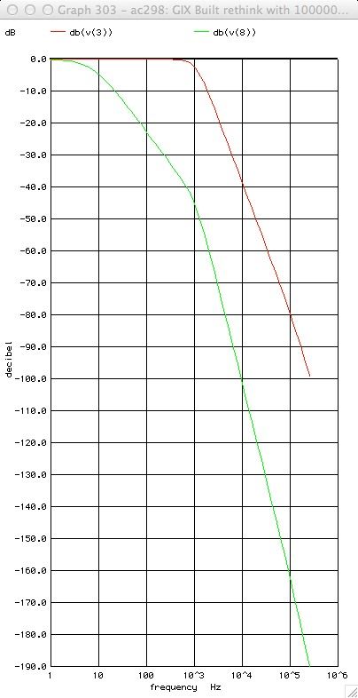

Parts
I did my final build with the following:
L501            330uH (as originally specified) (Updated)
Rsense          0.250ohms (as originally specified)
L503            1200 uH Bourns 652-RLB9012-122KL
NEW CAP         Tack a .1uf ceramic capacitor (350V) between the end of that inductor and the HV out on the boost converter on the back of the board.
HV Jumper       200ohms ( I used a 1/2 watt, I don't know why Gyraf specs the R31 at 2 watts, it sees 5-7 mA and has a 5 volt drop. What am I missing tube guys?) (update)
C507            22uf I used EKXJ351ELL220MJ20S, it fits fine.
C25             350V 22uf also fits EKXJ351ELL220MJ20S (update)
C25             350V 10uf 350V 10uf, if you want to be true to Gyraf design 647-UVY2V100MPD (HV card exceeds 250V on startup)
C503            350V 10uF 647-UVY2V100MPD (HV card exceeds 250V on startup)
C508            450V 1uF version RDED72W105MUE1C3A (HV card exceeds 250V on startup)
R502            300,000 ohms
R504 + R503     A single 1800 ohm resistor (measure these with a DVM, a small difference on this part makes a big difference in voltage)
R33 and R34     120 to 140 ohm to reduce current use
C509            I built mine with this omitted.  I found it makes no difference. (Update)
Shield          I put a shield on my HV boards, if you want I can upload a pdf template of it.
You can use a bigger resistor for the JV jumper and get better filtering, but I find it is fine for the noise frequencies present and it keeps the supply impedance low.
The smaller inductor was my bad idea.

The improvement that can be made is in the filtering.  All the "design tips" documents on boost converters say you need to put an LC filter after the boost converter.  In the schematic, that LC filter is formed by L503 with C507/C507.  The general recommendation is to have the LC filter frequency at 1/10th the boost converter frequency, and this is where we have diverged from the recommended design. Our boost is running at around 15K, and our boost is running at around 100-120K.
Here are Spice models of the frequency responses at the Driver and Gain stage anode for the original schematic and one using the filter changes specified above. Red is the Driver Stage, Green the Gain Stage.
Note: There are other LC filter arrangements that work, but this one fits best.  You can use much smaller inductor like a 22uf axial cap which fits pretty well across the top of the relay, but you still have to bypass it with a low ESR ceramic and that fits on the back,  so I chose this approach.  If anyone wants I can provide the various options.
Are you just hanging another .1uF on the output or is this after L503?

Well the inductor replaces L503.  I updated the post where I said L502, sorry for the confusion.
Note: In the picture and only for test, L503, and L501 and the HV jumper resistor are mounted on long lead's, tacked on. This is so I didn't have to keep soldering and unsoldering the boards which would surely have ruined them by now. For a build you should mount these properly although you can see that the inductor is a close fit and may need to be angled depending upon your choice of part.  (Also note C28, the 48Volt filter cap, is a 63V 100uF panasonic which I squeezed in). You can also see the Blue 450V C508, and the 350V C503, and the tacked on Rodney Cap.
The new cap goes on the back of the board.
As far as the part selection for that inductor see the note at the bottom.
All this L503/NewCap filter does is lower the filter corner down to about 1K, and puts it 40dB down at 13K where before there was a 10dB peak.  See the compared Spice model plots in previous post. The 8ohm HV jumper (I used 8.3 ohm that I had lying around from discrete opamp builds) makes an RC filter with C507 that smooths out the peak on the LC filter.  You can put more RC filter there, see my note at the bottom.
So instead of Boost Converter->LC Filter->Anode. you now have Boost Converter->LC Filter->RC filter->Anode.
In the MP 66 Schematic there is a 10uH/22uF LC filter (L3/C31) filter that does the same thing followed by a 2.2K/22uF RC filter  (R30/C17) (which is easier to fit without API format space constraints) which is down 60db at 10K Hz, and has large voltage drops and current limits.  By omitting and equivalent to C31 and R30 on that schematic the GIX-51X essentially runs no RC filter to the driver stage and has a 16.2K resonant peak (as seen in earlier posts).  All the boost converter guides say you have to run an LC filter after the converter, you can use big F small H, or big H small F.  The latter fits better as a retrofit to the GIX-51X.
LC filter part selection: You could find an axial inductor that can handle the .41mA ripple, but probably not that short.  You could take a long axial and mount it vertically (like the resistors on the HV board) and it would fit but a lot of the axials seem to be low current.  The one I tested with is a rewound version of an extra L502 part I had ordered (the 47uH one).  I rewound it with about 7 feet of 32 gauge magnet wire to replace the 22 gauge that was there,  pulled off wire till it measured 995uH, then soldered on leads and mounted it (see picture).  I had to lean it away from the HV board so it would not contact.
One thing you may need to be concerned with is Q factor, which i frankly don't really understand.  Some of the Boost Converter notes mention the following fact.  This filter will filter the same frequencies that are "seen" by the FB voltage divider, so a "High Q" filter (I think this means a steep filter) may interfere with regulation or cause some problem.  I did not have a problem with that, but I don't really know the Q of my Inductor (I am thinking it is about 50).
More RC filtering: I put an 8.3 ohm resistor in the HV jumper. A larger resistor in there fits easily and dramatically improves the RC filter, but causes a bigger voltage drop. I saw 5 volts drop from a 750 Ohm resistor so there is about so it must be around 8mA or so.  If you do that you need to run the HV card above 250V, which works fine (R502,504,503 of 300K, 1500R, and 282R worked perfectly with a 750 Ohm HV jumper).  Do that and you must run 350V caps for C503, C508, C509 and for that matter C507 and C25 which I recommend anyway because the boost converter as originally spec'd always exceeds 250V on startup until the heaters warm up.  Those parts are available and do fit, C508 is RDED72W105MUE1C3A where you have to bend the leads because it is a 5mm LS part).  I put the smaller filter there because I couldn't measure an improvement with more, and it would allow folks to run at 250V if they already bought all the parts (albeit exceeding ratings briefly on startup).
