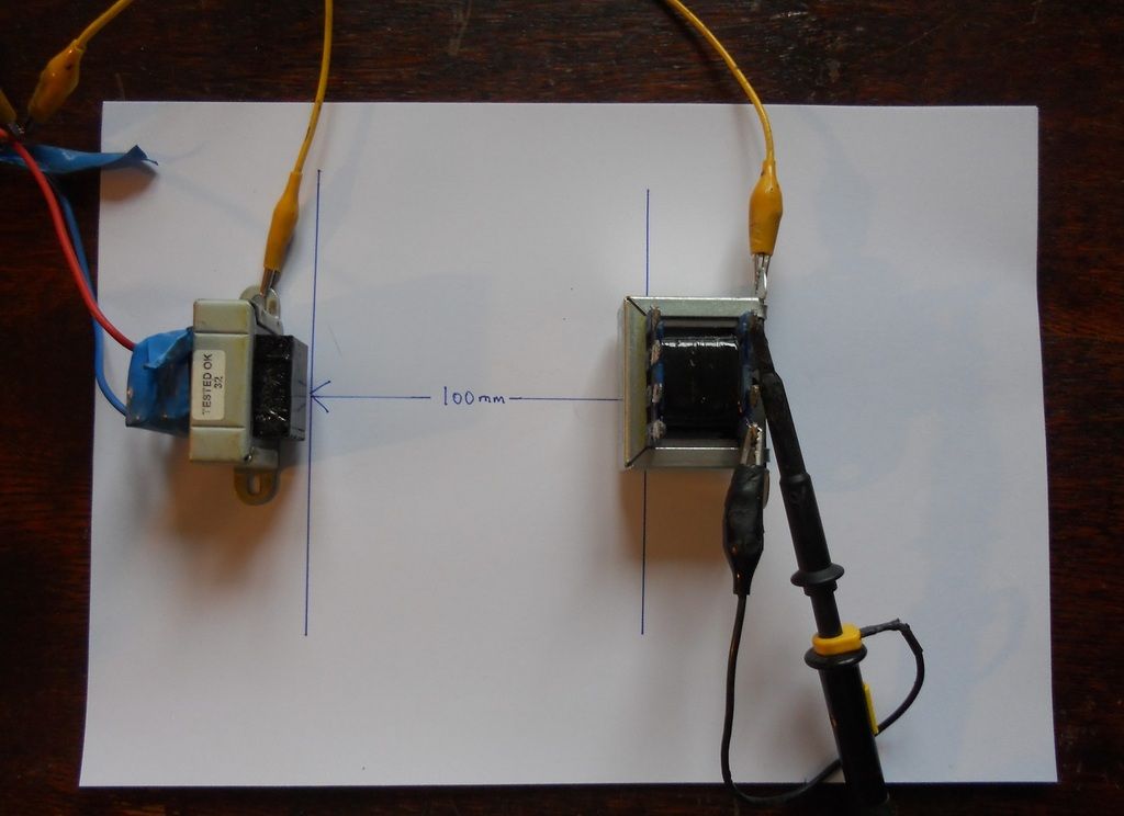

Transformer screen test
For this test I have used a small 6VA mains TX  as a source of hum radiation.  As I'm in France, the mains frequency is 50Hz so the hum comes up at 100Hz on the scope counter.   I have put the scope leads across one of the windings of an Edcor XSM15k/15k TX, the set up looks like this:-
This is what the trace looks like:-

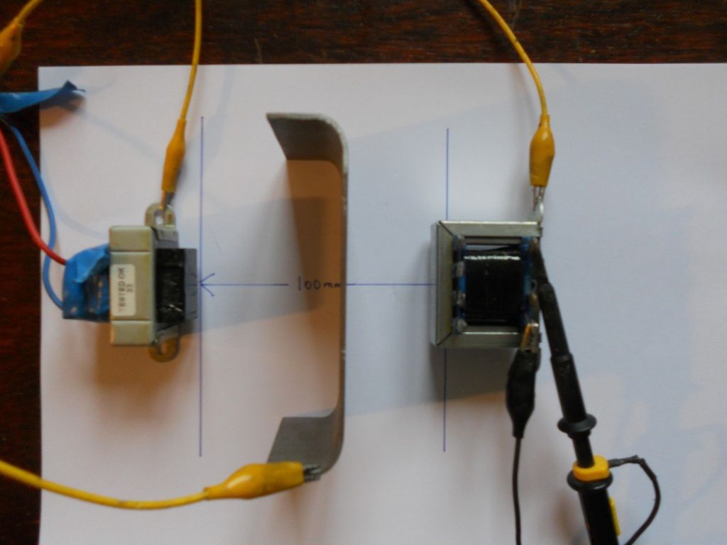

The first test was to vary the distance,  I measured the induced voltage on the scope peak to peak while changing the distance from 10mm, 20mm, 50mm, 100mm through 200mm, this produced the exponential chart (attached)  because I can't upload pdfs to Photobucket and can't convert an excel chart to jpg, technology still has a long way to go!
The next test was to keep the distance at 100mm but put various metals in the way,   The reading with nothing was 3.6 but with 1.5mm thick steel it fell to 2.4
with a 1mm thick Aluminium sheet it was 3.4
with two Aluminium 1mm sheets it fell to 2.8 but with the steel as well it went down to 1.8.  This proves that a sandwich arrangement is better at disrupting the magnetic lines of force than a single metal sheet alone.
I shall bear all this in mind when designing the layout.  One final point, it did not help to turn the TX through 90 degrees which surprised me.
best
Soundcloud: Delayed Action.

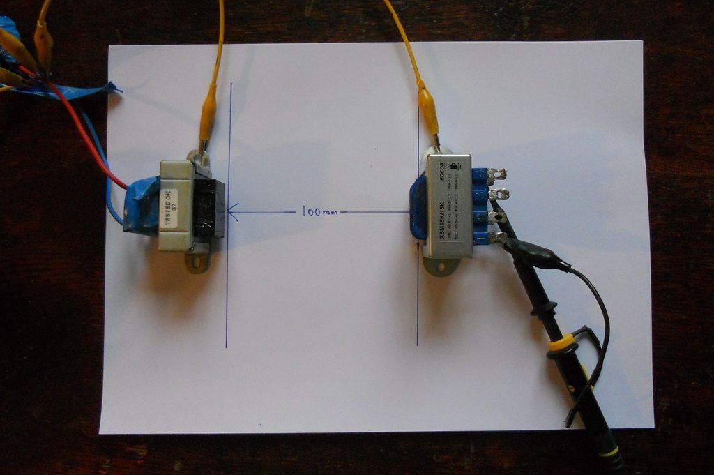

« Reply #7 on: April 26, 2015, 10:52:15 AM »
OK, Lets put this data into context.
The input to a U73 is nominally +6dB, so if we say that we need a minimum S:N ratio of 70dB it tells us the  level of screening required.
+6dB is 1.55Vrms and 70dB is 3162.
The maximum hum we can tolerate is therefore 1.55V/3162 = 0.00049Vrms
To relate to the peak to peak voltage we have been recording from the scope we need to multiply by 2.828 which gives us 1.39mVp2p.
Here's the distance v mV chart (copied and pasted Doh)
We can see that we need our input TX at least 200mm from our PTX (distance is the best insulator) and that it will need screening as well.  The voltage at 200mm was 2.1mVp2p.
The steel plate managed to reduce the voltage to 67% so it would reduce our example to 2.1 x 0.67 = 1.4mVp2p, this would almost give us our target but we have to go further than this.  The U73 has an input pad which reduces the voltage from 1.55V to 155mV so we have to find another 20dB of screening from somewhere or lose the pad!
best

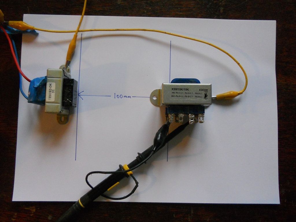

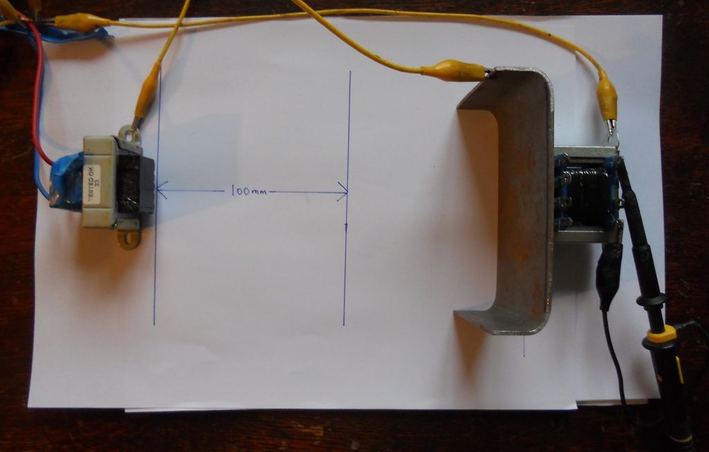

« Reply #8 on: April 26, 2015, 01:48:37 PM »
Now for some weird stuff!
Just to remind you, this arrangement produces 3.9 @ 2mV/Div=7.8mVp2p
Turning through 90 degrees on axis makes no difference!
But turning the axis through 90 degrees drops the hum to 1.2 @ 2mV/Div=2.4mVp2p, and reduced the hum to 30.7%
Now comes the weird stuff.   When I put the steel plate next to either the source TX or the XSM TX it made no difference!
But moving it near the middle finds a null point and the hum drops dramatically to [email protected]/div =0.5mVp2p, that's a hum reduction to 6.4%
The croc clips are to earth all the metal work.
To go back to our previous example,  we now have 0.5mVp2p which is 177uVrms.
With 1.55V that is a S:N ratio of  78.8dB and with 155mV after the pad its 58.8dB, but that is with a distance of only100mm.
If we take the distance back out to 200mm,  then the hum falls to 0.7mV with no screen, but after finding the best placement for the screen the hum has disappeared and only hiss is visible on the scope.
These measurements are not absolute but they are all completely relative to each other and we can learn the following from our tests.
1. The distance between the PT and the IPT should be as long as possible.
2. Screens work better when sandwiched with dissimilar metals.
3. The axis of the IPT should be 90 degrees to the axis of the PT.
4. Screens should be placed after trial positioning for lowest hum.
This is the end of the transformer tests, I'll now get on with the layout.
