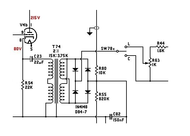

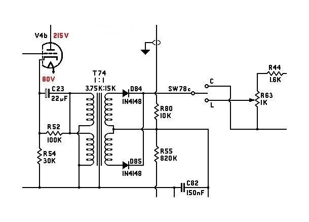

Re: U73b from scratch
« Reply #45 on: June 23, 2015, 07:27:56 AM »
I have just finished my work with the mock-up compressor.  It all hinged on problems with the way the side-chain was configured.
This is the original circuit configuration.
I was able to try this with one of my modified Edcor 15k:15k transformers mentioned at the beginning of this thread.  Notice that there is a step-up of 1:2 in the voltage and that the 100k resistor is in parallel with the driving cap, putting a small amount of DC through the windings.  It also means that the impedance of the primary is 3.75k which turns out to be too low. 3.75k:15k.
The symptoms of this are as follows,  you can set the compressor up for small inputs and it follows the correct output reduction characteristic until the cathode follower can no longer drive the load.  The output then shoots up in an uncontrolled manner.  After I sussed this out I tried it wired as 15k:15k and it was a little better but again the same thing happened.  This time it was not because the load was too low but because there was not enough current and or voltage being transferred.
The 6BJ6 tubes need to be able to run to cut-off to reduce the output properly, so if there is insufficient voltage or current then there is insufficient gain reduction.  The next thing I tried was to put a diode bridge in place of the CT diodes in the original schematic, this worked too well and the gain reduction started way to early and put it out of spec.  Finally I adopted the following configuration and it worked perfectly.
This seems to work because the primary load is high enough (15K) for the CF to drive it through the full range of inputs.  But the voltage is not too high as there is a 2:1 reduction in voltage before the bridge multiplies it by 1.414.  As the voltage on the secondaries is halved, the current is doubled, so this again helps to drive the diodes to produce sufficient CV to drive the tubes to cut-off.
You will notice that the original CF used 30k//100k which is 23k (hence 22k).  I am not sure what the purpose of the 100k resistor is, but it may be to do with interference reduction or frequency response smoothing, if anyone out there has an inkling then please let me know.  The TX on the original U73b was probably nearer 40k:40k which would have made it 10k:40k in the original configuration which the CF could have driven successfully.  Unfortunately we find it difficult to source such transformers nowadays, whereas the Edcors are both plentiful and affordable.
best
I imagine its to minimize the resistive load. I had no problems with the original side-chain circuit. My transformer primary inductance is about 50H and I measured the frequency response with the secondary disconnected from the rest of the circuit to make sure its reasonably flat with no resonance.

While you are here, do you know why the original circuit has a 100k resistor in parallel with the C/F Cap?
This is the only part of the circuit I don't get.
Best
At first I thought it would serve to damp the VLF resonance of the xfmr/cap combo, but it just doesn't click; the value is too high.
I can only guess and suggest some conjectures:
a) Having the magnetic core premagnetized in one direction makes it more prompt to respond to peaks of a certain polarity. Such a scheme would not be incongruous in an AM broadcast situation, where positive peaks are prohibited.
b) The small DC current (0.8mA) in the primary reduces the nominal inductance of the xfmr, making it less responsive to low-level LF. That may reduce LF modulation distortion.
c) There's a mistake in the schemo
d) The designer thought it would improve operation, but it does not, however it is so imperceptible he forgot to remove it
There may be a couple other stupid explanations, and there may be a good one, but I can't figure out what.
PRR may have  a better opinion...
Thanks Abbey,
I think you may have cracked it with reducing the LF response.   Remembering that the original schematic included LF cut in the audio path, (FR 40-15kHz) it means that they balanced the side-chain with an equal cut.  There is no feedback path with a feed-forward design so balance is important.
This solves my final question because there is no LF (or HF) cut in my version, so I will not be including the 100k in my circuit, but I will have to reduce the 30k to 22k to compensate for the lack of a parallel 100k.  Great! ;D
Thank you very much.
