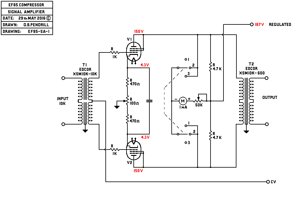

I have been working on the design for the signal amp, this will be similar to the 660 with 4 tubes/side.
As I mentioned in the drawing board post, I have 10 x Siemens and 10 x Mullard EF85's to choose from so I set up a test to get relative data for them all.
I tested each tube with a 4.8k plate resistor and a 517 ohm cathode resistor, these values were chosen because they give 150V on the plate and 8mA current when the supply is 188V.  With 4 tubes the plate resistor is 1.2k (4.8/4).
What surprised me was the consistency of the Siemens production and the lack of it with the Mullards.  I should also say that each tube was tested with exactly 6.3V DC and the Siemens also had more consistent heaters as well, the Mullards needed much more adjustment every time to bring them to 6.3V.
These are the Siemens test results and the tubes I chose for the left and right sides are shown with the combined currents and gains which both have to balance as well as possible.
These are the Mullard results
You can see that compared to the Siemens tubes, they draw less current but have higher gain.
The gain figures were without bypass caps but with a cap they are all about 2.3 times greater.  Remember, they are triode wired with a very low value of plate resistor as in PRR's original post.
I set them up with 4/side and they balanced very well at quiescent gain and current.  I next have to test them through the range with negative grid voltages.

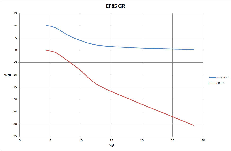

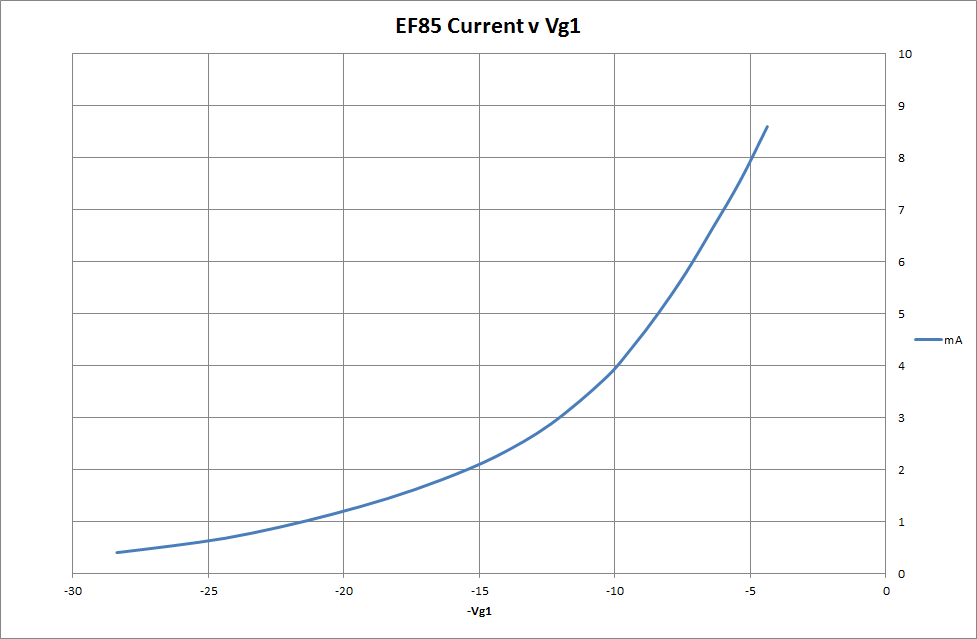

Re: EF85 Compressor from scratch
« Reply #7 on: May 29, 2016, 03:45:41 PM »
I made one of my dangerous mock-ups with croc clips  :o with 4 tubes /side and although the gain and current draw were fine at idle, they went out of balance with increasing negative voltage on the grids.  There were also potential instability problems due to having over 24mA/V gm!  These are TV tubes remember.
I decided to start with a more practical approach with just a matched pair as this provisional schematic.  This is almost exactly as PRR's original post.  I have put a copyright sign on all my circuits because I don't want them ripped off by kit builders, but anyone on this forum can copy them for personal use.
I am using just a 10k: 600 Edcor for the OPT at the moment, I have some other impedances on order to try.  Notice the way the OPT is connected, there are no coupling caps to charge and no current through the primary either, when in balance, which is virtually always.  This is definitely well within the 50V spec for this OPT.
I have tested the current versus the -Vg1 voltage in the following chart:-
I have not yet tested the gm against current, but the gain and gain reduction are shown here:-
This shows that 30dB of reduction is possible with -28V on the grids, pretty much as PRR predicted.  This has happened with about 8.4mA of idle current rather than 10mA as in his example, which should make the tubes last a little longer.
The gain is lower using the OPT direct coupled because there is a degree of negative feedback going on between the phases, the loss is more than just from connecting a 10k load.  I will be testing the frequency response with the other OPT's  later.

I have finished a design for the signal amp and would welcome some expert comment.
The main issue turned out to be the need for a low output impedance to drive the output transformer to a decent frequency response.  I have used a direct coupled CF for each output and its flat from 20-20kHz.  If I had used multiple tubes, then the output impedance would have varied by too much under GR, this way it is constant at <100 ohms.
I used a pair of excellent TV pentodes 6JC6A triode wired.  These frame grid tubes represent the state of the art in 1966 and give a gm of over 10 at half the maximum dissipation, the mu is 25 so this is where the low output Z comes from.
I have tamed all the grids of these TV tubes with grid stoppers to counter any parasitics, the FR drops slowly after 20kHz then picks up again at 50kHz drops and rises again at 100kHz, this from a $13.95 Edcor TX. 8)
There are no intermediate caps to charge and the 15mA of current has no problem with the output caps.  As PRR said, the voltage change with the GR tubes is only 40V, so the CF's can easily cope with this amount of movement, which is, in any case,  limited by the regulated supply.
Best
Soundcloud: Delayed Action.

« Reply #9 on: June 06, 2016, 08:49:20 PM »
I like it Dave    :)   I've done similar with a pair of directly coupled cathode followers after the gain cell pair albeit using different valve choices.   Not much of value to say but, fwiw:
Won't probably sound or measure any better but you could lose a cap by trying it with just one 4.7uF between the OPT centre-tap leads?
I used squalid-state constant current sinks under the followers but... ?
Elevate the heater for the 6JC6's.
Protect the 6JC6's by limiting the grid to cathode voltage at turn on -    Zener. Neon.
Edit:    Actually, looking at your schem., I would be tempted to try it with the cathodes directly connected to the OPT and then use a CCS  on the centre-tap...  Maybe another 6CJ6A?
Anyway, just thoughts, looks good as is too, cheers.

« Reply #10 on: June 08, 2016, 05:40:20 PM »
I will try one cap and no caps as you say.
The heaters will be elevated on the 6JC6A's.
The grids come up slowly with the regulated supply which gives a soft start effect.
These are my provisional timings which were also used on the Group DIY comp.
Any comments welcome
