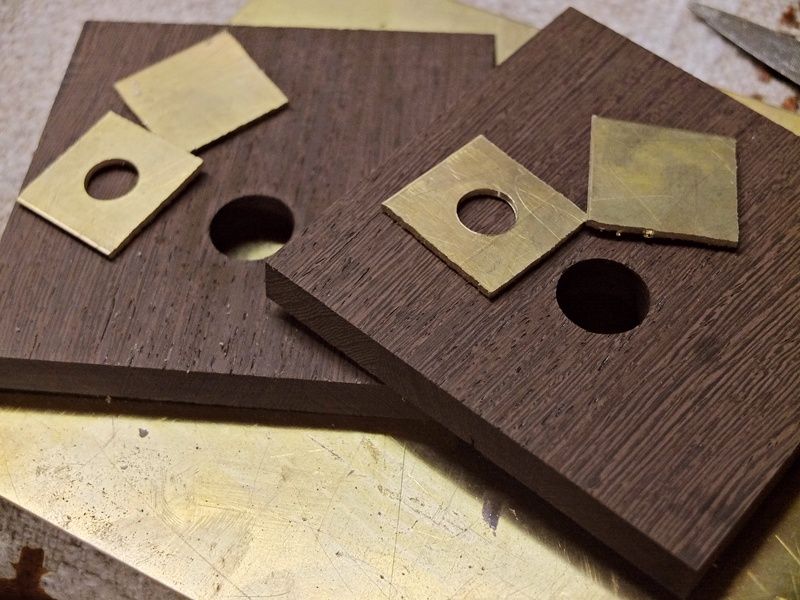

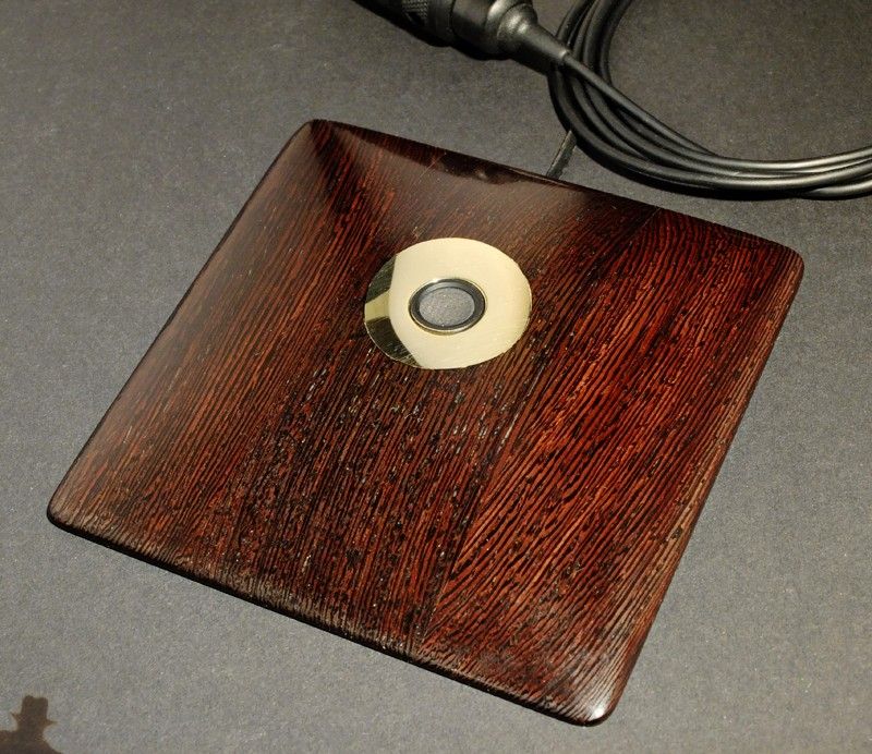

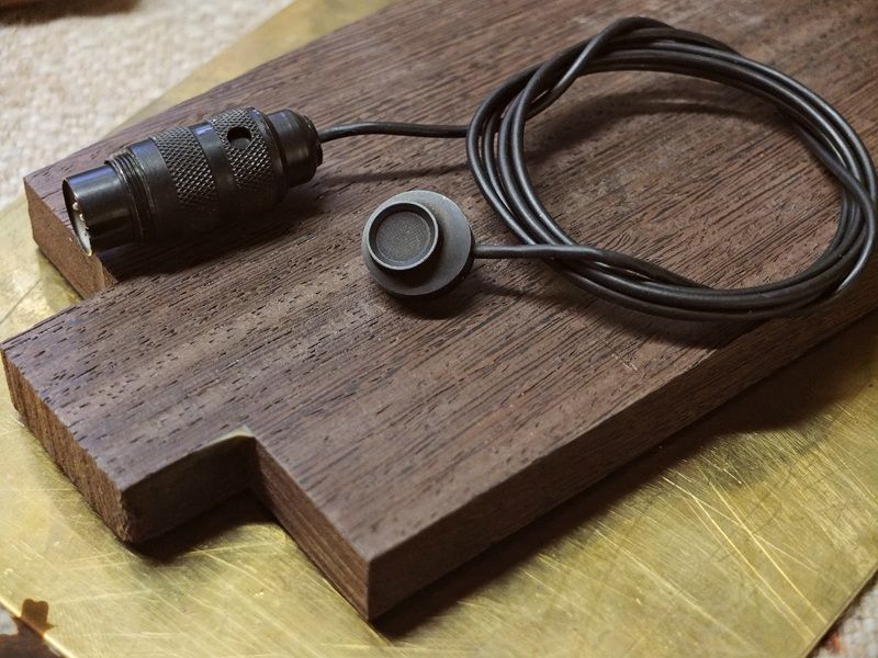

I started with a Sennheiser MKE10 lavalier mic, a scrap piece of Wenge-wood (think Warwick bass necks) and 1,5mm brass sheet.

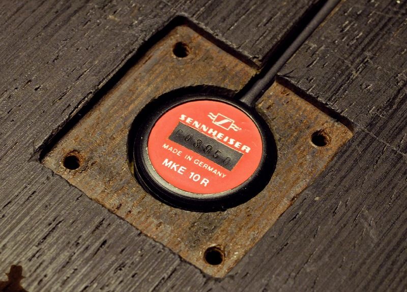

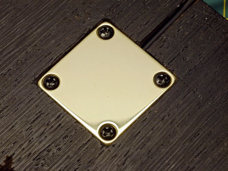

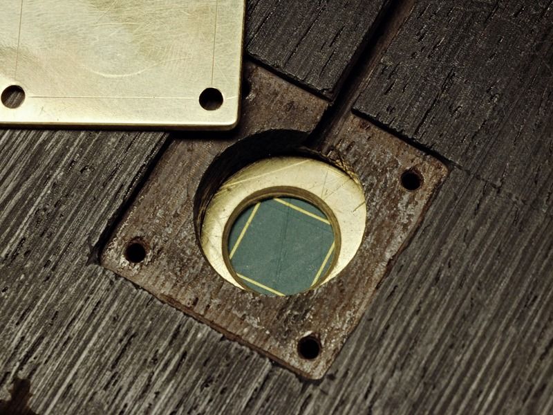

I then routed the cavity for the microphone and a cover to hold it firmly in place. I don´t have a milling machine so I used a Dremel mounted on a small "router base" as sold through Stew Mac guitar shop supply. A handy little gadget.

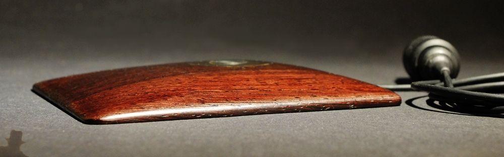

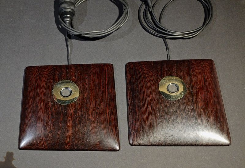

And the finished PZM
Since I had sufficient wood I made two of them. Those mics are nice for stereo recordings.
Professional PZMs have irregular shapes and the capsules placed out of center to avoid audible artfacts caused by diffraction of sound waves from the plates´ edges for example. The Neumann and Schoeps PZMs were constructed using computer simuation. Mine were made using just improvisation by hand  :) I simply made one and used it as template for the second one.
Wenge is a very hard (reflective) wood. I made the surface directly surrounding the caspule from brass to give it even better reflective properties for the highest frequencies. Again those brass disks are not round but have a slightly irregular shape.
I´ve done test recordings at jam sessions and I´m positively surprised about the sound qualitiy these mics are capable of.

A little extra on wenge. It is indeed a  very dense and hard wood. A possible con is that is has really large pores.  Those can be filled (to some extent at least). And the brass insert here seems like a good idea to me.
Also, wenge is among the most resonant of woods, on par with some of the rosewoods. This can be a good or a bad thing. If the wood is loosely placed (not fixated) on a flat surface, it will start singing when the main resonance/frequency of the piece happens to hit it. This might be something to watch for. That said, metal can be pretty resonant, too.
happy new year!
Yes, wenge has quite large pores, they can be seen well in the first pictures above.
I filled them with epoxy on the reflective upside of the plates, sanded and polished it for a smooth surface.
I thought about glueing brass sheet on the bottom to make it more sturdy and decrease possible resonance effects. But before thinking too much about possible theoretical stuff I simply did a real world test run.

I don´t notice any disturbing resonance artifacts.
The mics lay on the floor on their bare wood surface, not even felt padding in between...
Works for me.
