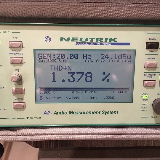

I've got some nice transformers from forum member Andrej (AVD Audio) here and did some measurements and tests. I'm very pleased by the built quality and how they perform.
All tests were done out of circuit. I've just inserted the transformers in one of my ADT-5MT consoles channel strips and measured with RMAA.
Part two will be in circuit (Varimu compressor triode push pull circuit) in comparison to other candidates from Edcor and Sowter. I'm going to attach some PDF files and pictures later.

bernbrue
Re: Testing some AVD Audio input and output transformers
« Reply #5 on: April 11, 2017, 01:03:33 PM »
Here are the results of my "in circuit " test. It's a 436 style varimu triode push pull circuit.
Bernd
