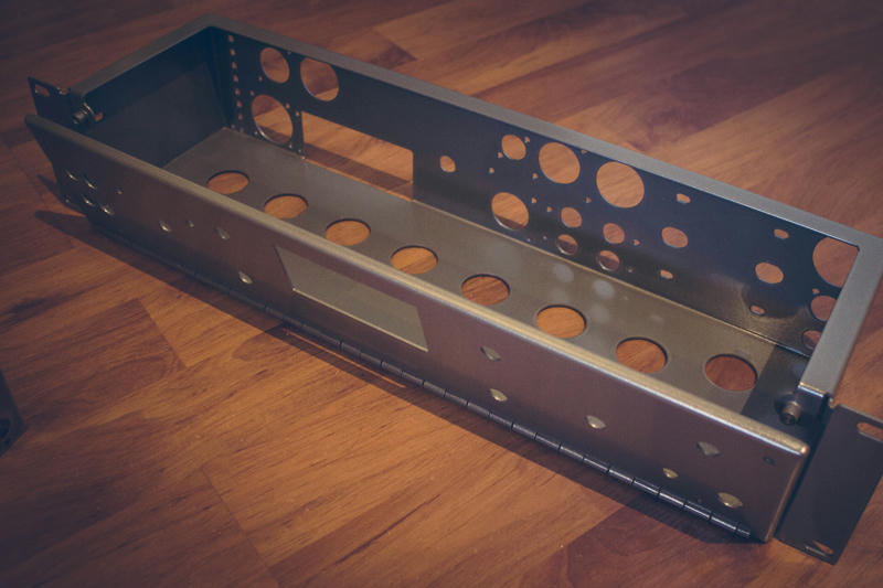

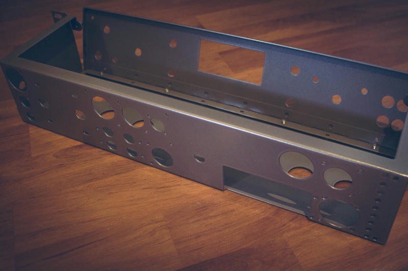

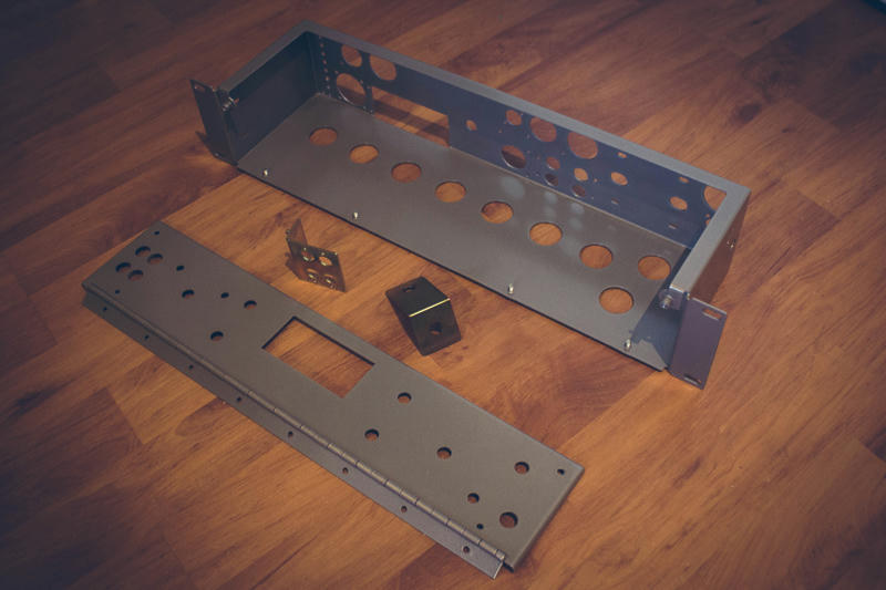

Sorry for the delay again folks,
In the meantime, after having the faceplates manufactured for the 2nd time I went through every single panel - and still more than 20 were not living up to my expectations.
So I had them re-done - for the third time(!)
The manufacturer told me that they were delivering German industry standard (which is actually rather high), but if that wasn’t enough for me, I should look for another supplier in the future...
Anyway, I received word yesterday that the 3rd run of faceplates was finished and the quality is supposedly very good.
They are on the way here now.
If they are all ok, the entire bunch is going to the printing house again and hopefully ready for shipping end of next week.
We’ll see. After all I went through with this project, I still try to stay optimistic.
So far it was the most obstacles I experienced with any of the projects I did so far.
The good thing is, that the chassis came out absolutely perfect - powder coating is flawless & the overall quality is outstanding!
To shorten the wait some pics of the actual production chassis with mounting brackets for the 1/4" jacks and the meter switch - I'll take some pics of the turret boards and pcbs when I'm at the studio tomorrow :)
