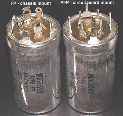

  I already sourced most of my critical parts, have to start thinking about those can caps now. I realise some of these are multi section but which  one is which? Is it too early to ask which cap positions relate to the schematic designations/values. Just to get my head around it. Personally i would use all new caps but i guess this will be thrown to a consensus at some point as to what is available,  as Rainton has done in his other project threads.
Yes we have 3 multi-section can caps in this circuit - two of them being located in the PSU. C11 & C8 to be precise.
C11 is a four section cap with 4x 20uf/450V of which 3x 20uf are connected in parallel to give 60uf + 1x 20uf, and C8 is a 2x 20uf/450V.
Both of them are still available and I'll point out where to get them in the BOM later.
The 3rd can cap is C9 which is 2x10uf and a little harder to come by - especially since the original one was a PFP cap.
Here's a pic so you know what that means:
On the left is an FP chassis mount cap - those kind of can caps are still available new. On the right is a pcb mount PFP can cap which are not being made anymore:
Well this particular cap (C9) is soldered directly to the pcb (you can see it in some pics that show the back of my unit - it's the can cap on the right sticking out through the rectangular cut-out in the chassis)
For the prototype Livingnote and I agreed to keep the original footprint on the pcb, but instead of just putting holes in the pcb to mount a PFP type can cap, Livingnote cut in slots to hold the FP type terminals.
But to be frank mounting that cap was a drag, and we're still figuring out a way to make it easier. Especially it's a lot of extra work to cut these custom slots in every single pcb...
I'll let you know when we did ;)
Anyway we'll include the option to mount 2 regular electrolytics in this spot, so you could always go that route.
I would highly recommend NOT to look for vintage PFP type can caps to use for this project as that's asking for trouble.

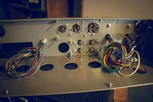

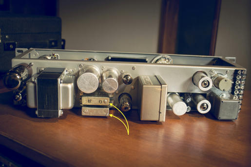

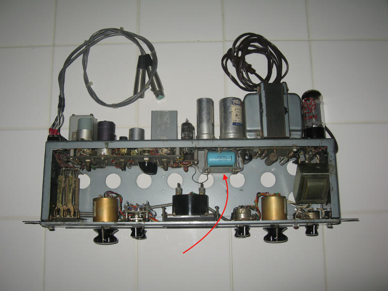

These are oil filled 0.5uf 600V caps (C6 & C7) and extremely hard to find.
Here's a pic of a very early state of my build that shows the terminals of these caps from inside the chassis:
Anyway - there were also many models of original 175b and 176 that had film caps in this spot - mounted inside the chassis with the help of a small turret board and some spacers:
Thus, the chassis doesn't feature the 4 cutouts for the terminals of the oil caps as you can see in this pic:
Since these oil filled can caps with the exact physical dimensions needed are pretty much unobtainable and there were original units with film caps instead,  I will design the chassis for the use of film caps here and most likely add a turret board to let you mount (whatever) film caps (you like).

The problem is guys, that they all have different dimensions and that makes it close to impossible to design the chassis for them (fora production run)
The one Phrazemaster posted is smaller than mine and the terminals are closer together.
And the one craig posted won't work at all - unfortunately - since it has the terminals on one side and the mounting brackets on the other side - and apart from that the size appears to be different, too.
The ones I used look pretty much like this:
But like I said - since the original units also were available with film caps I wouldn't bother.
I could design the cutouts into the chassis but the possibility that the caps you'll find - if you find any - won't fit is like 90%
