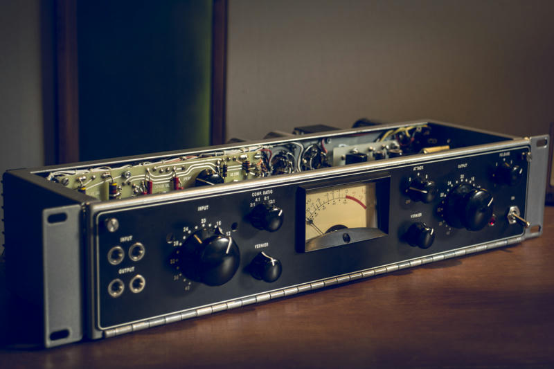

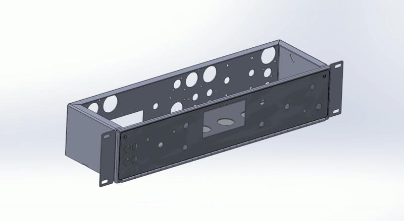

Ok let's get serious  8)
Here's the basic prototype chassis - all powder coated with the closest match I could find to the original color:
Even though it has no lid it is the most complex chassis I've done so far - also due to the top edges of the back chassis as well as the the top and side edges of the front panel are folded inside, the seams in the corners are welded and then smoothed before powder coating - you can see it very well on this pic:
The hinge is welded to the front panel and then powder coated as well:
In these pics you can see even better what I meant by the folded edges. The front panel is actually not just a flat panel - also, you can see that very well on the first pic, the bottom of the front panel has a cutout to exactly fit the hinge  :)
Both the 176 as well as the 175b actually feature 2 front panels - the first one is made of solid steel all powder coated with the hinge welded to it, and the second is sitting on top of the first one - a very thin black panel with white silk screening...you'll see that very soon ;)

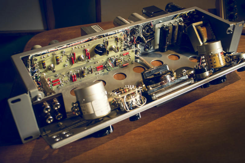

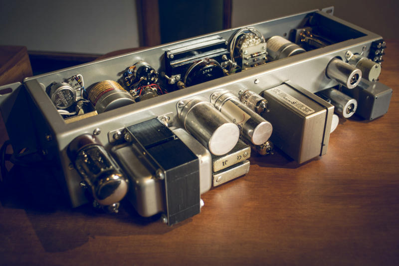

Today I finished the 2nd pcb as well as mounting all components to the chassis. Here's the 2nd pcb - it's not as crowded as the first one, but it has a can cap soldered straight to it:
I'm not quite sure how to solve this in the kit version later. The actual can cap used in this spot was a Mallory PFP:
They're pretty much unobtainable nowadays - especially the value needed here. The FP ones with 2x10uf 450V are not unobtainable, but also very hard to get - and I wouldn't recommend using vintage can caps.
In the prototype I used a FP style cap, so the circuit board was prepared with slots to fit the wider terminals .
But frankly it was kind of a drag to mount, and solder it, and we'll have to figure out a way how to do it later in the kits.
I'm thinking about at least adding the footprint of 2 regular modern electrolytics so you guys can choose (?)
Anyway, here's a pic of all components (except for pcbs & tubes) mounted to the back of the chassis:
and another one:
I  already started to wire up the PSU section and the other transformers, so the pcbs can finally go into the chassis very soon...

Just finished the PSU section  :)
The pics I found show a small difference here between the UA175b and the UA176.
That's mostly due to R39 being located on the PSU turret board of the 175b, but in the 176 it's located on the ratio turret board mounted to the rotary switch on the front panel, where it's one of the 4 different resistors for different ratio settings (while the 175b is limited to 12:1 ratio only).
I followed the 176 component layout, since that's what I'm building:
gyraf
...beautiful work...
..note to self: don't let Harman run your company..
