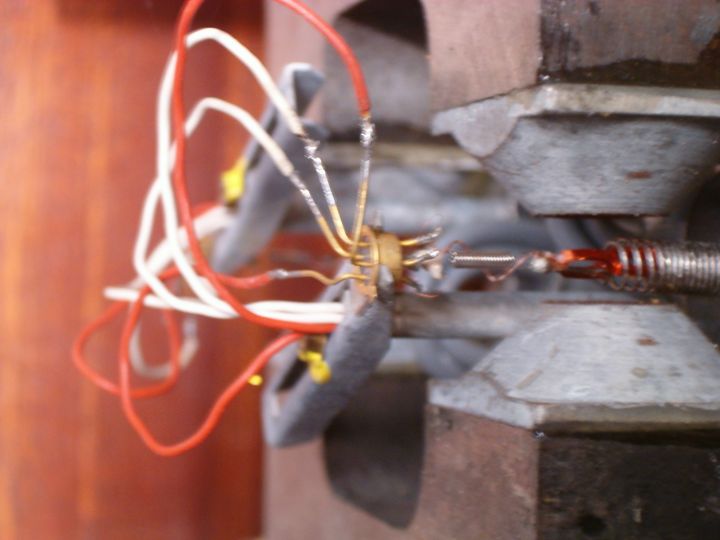

Someone mentioned the AKG spring reverbs in another thread and how the dual driver/recovery coils at each end of the spring are used to cancel out correlated signals and thereby leave only the signals with no coherence whatsoever. That is fascinating. I found a document that describes this [1]. Here is a quote:
As can be seen from the block diagram (figure 6) the electronic portion, for each channel, consists of an input amplifier, an output amplifier, and two attenuation amplifiers. The spring is excited by feeding the original signal into one coil half of each of the moving coil systems arranged at either end of the spring.  o The "dry" signal is fed in phase, to each moving coil half on the ends of the spring, the reverberated signal is picked up by the two remaining coil halves, amplified, and connected in opposite phase. In this manner compensation of all interdependent and related Signals is achieved, TTL being a reciprocal and passive transmission system.
To illustrate this: If the circuit were to be applied to an ideal line the reflections would all be in phase at the output and would be cancelled by the out of phase connection of the output. However, since the transmission properties of the spring are statistically changed, it produces irregular, statistical, frequency independent reflections which appear at the ends of the spring with no coherence whatsoever. Therefore, these signals will not be cancelled at the out of phase output.
Note: There are no figures in the document but you can find pics in Google Images.
However I don't fully understand this because I would think that any signals would be convoluted by the spring by the time it reached the other end and so there would not be much correlation between the two ends anyway. Can anyone explain this cancellation a little more?
I wonder how effective it really is and if it could somehow be employed in a custom unit using conventional music wire springs. Of course one would have to craft the very small magnet wire coils that make up the transucers suspeded between the C magnets but there are folks around here that are good at making coils.
[1] http://lcweb2.loc.gov/master/mbrs/recording_preservation/manuals/AKG%20BX%2020E%20Reverberation%20Unit.pdf

They're not interlinked. The document I linked to explains:
Each moving coil system consists of two coils which have a rigid mechanical connection between them and which vibrate in a strong magnetic field. The two coils are electrically and magnetically decoupled. The signal is fed into one half and picked up at the other.
They do look like links in a chain but I don't think they can be interlinked because that would make each the core of the other and they would be very much coupled magnetically. My guess would be that they are simply held together end-to-end using epoxy. Or maybe there's a bit of plastic or something to relieve the tension.
To make one of these driver/receiver transducer coil pairs I would just wind a small chain-link style coil with epoxy around an flattened chain-link shaped mandrel that the epoxy will not stick to. After it dries, it slides off.
Then they look like they are epoxied together end-to-end but rotated at 90 degrees. I guess this minimizes magnetic coupling? Now you have 4 wires sticking out that attach to what at first glance looks like an old TO-1 IC can:
But my guess is that it's really just an insulator that ensures the 4 wires are held close to the axis of rotation and don't hinder the rotation of spring.
Now do this at both ends and you have a driver and recovery transducer at each end. With proper C magnets that would be enough to at least study the circuitry that does the out-of-phase cancellation of correlated signals.
To make a real solution the spring would have to be very long and change diameter and wire thickness and there would need to be mechanical dampening disks. Difficult but, with the right tools and skills, not impossible for an individual.

At low frequencies, the springs have similar transmission properties and in fact most of the initial transient response is very similar, because it's mainly related to the spring length and sound speed in the spring material. The output of the spring is a combination of correlated and uncorrelated signals.
This can be achieved using standard Accutronics tanks, using two tanks driven by identical signals and connecting the outputs out-of-phase. That won't be as efficient as in the BX20 because the manufacturing tolerances are much less stringent than they were at AKG.

Although the BX-2 tube used in a number of AKG reverbs looks like it only has one transducer coil and not the two used in the feedback drive of the BX20E:
and those units sound pretty good. There's a u tube video of a BX-15 that sounds pretty amazing.
I think it could be worthwhile exploring the coil suspended inside a magnet arrangement instead of the usual Accutronics transducers. But it is a very delicate arrangement. That and patents might be why Accutronics used the alternative mangnet suspended inside a coil method in which case doing it the AKG way might turn out to be better in some way.
Can you cut a neodymium magnet? More specifically, take a ring shaped neodymium, clamp very securely to some kind of metal cradle and then pass it into a metal blade on a table saw very slowly with lubricant that might make a good strong C magnet.
The dampening disks would be a problem though.
