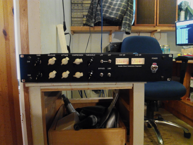

Here's something I'm working on right now.
http://ghr.fi/varimu/varimu2.pdf (couple resistor values are wrong on the schematic. I'll upload corrected schematic later.)
No input transformer and the control voltage is brought to cathodes. Impedance for the control voltage is very low but it's not a problem for solid state control amp. Only transformer used is on the vari-mu stage plates. Input stage is cross-coupled NE5532  and it drives the vari-mu stage differentially. If one input is grounded the gain goes down 6dB. Other than the input stage and the CV to cathode there's nothing unusual going on.
I got the circuit complete enough today to do some testing and it seems to work very well. For these initial tests I used Edcor XSM 10k/10k as the plate transformer and I can't understand how anyone can use them in their builds, they pick up hum and buzz like crazy. I would need a huge chassis to get them far away enough from the power transformer. I'll replace the transformer with Lundahl 1540 later on.
I don't know if anyone has done a vari-mu with CV to the cathode. To me it seemed like the easiest way to get rid of the input transformers, keep fast attack times and make a cheaper vari-mu with better performance. It works great, even though some purists might object to the use of op-amps and transistors. I'll do some more testing and measurements and post some specs later.

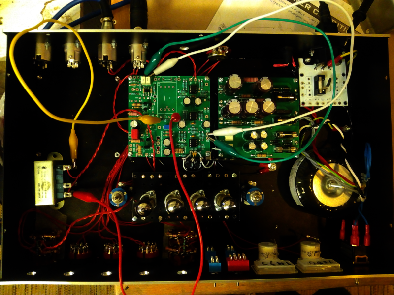

Finally got back to working on this one. With LL1540 transformers the hum and buzz issues are gone. From a box of 100 6K4P tubes it wasn't hard to find bunch of pairs that matched very well for gain and low thump. It was pretty hard to find matches for both channels to have same distortion figures at same amount of gain reduction. I'm not sure if most people go through the trouble of matching both channels for distortion.
Some measurements
Frequency response 20 - 20kHz ± 0.5dB, stays pretty much same even at deep gain reduction.
At +10dBu out and 10dB gain reduction, THD @ 1kHz < 0.25% (mostly 3rd harmonic)
At +10dBu out and 10dB gain reduction, CCIF IMD < 0.15%
I still need to measure CMRR of the input stage. I used 1% resistors so worst case scenario might be 30dB CMRR.
Distortion and frequency response are similar to my 6L6 compressor and to my ears they even sound very similar. I'm not sure I can hear distortion <1% when it's mostly 2nd and 3rd harmonic, so the sidechain probably has the biggest influence on "sound". My 6L6 compressor has almost the same sidechain, except control voltage goes to grid and is negative.
The negative side of cathode CV obviously is the large current needed for CV but I think it's worth it. Good input transformers are expensive and with cathode CV it can be replaced with cheap fairly simple circuit.
