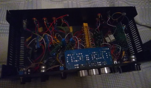

« Reply #126 on: September 19, 2020, 07:41:31 AM »
Stuff that's been changed :
-all the channel preamps (incl. master) now use 10-pin bus connectors except the mic channel (ie. they can be replaced with jumpers or another compatible module, line preamps have breakout wiring to the trim controls)
-stereo to mono summing where needed uses 10kOhm resistors
-HP out is now modified to use a cue/pgm blend (the grey pot next to cue select)
EDIT : here's what it looks on the inside:
The modules on the left are input channels (the blue things are the bus connectors, not the two which are in the front panel, they're mic on/off and EQ bypass switches).. the yellow "bar" in the middle is the summing bus. The master output preamp is next to it on the right as are the output transformers (the aluminium boxes), the PSU is the green PCB on the far right. The EQ is the blue PCB attached to the front panel.
EDIT 2 : I also bought some shrink tube which I was thinking of using for the PSU/mains wiring etc.. they're mostly hot glued for now. There's a bit of other mechanical stuff to tackle as well like securing wires, PCBs etc
« Last Edit: September 19, 2020, 03:53:05 PM by efinque »
