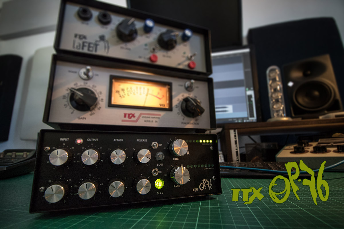

1176-flavoured FET compressor with opamps - PCBs for an easy build without (almost) any wiring
Oh no, not another 1176?! I know there are a lot of 1176 projects out there, but this one is not meant to be a 100% faithful recreation but merely a great sounding tool, that is quick and easy to build. The reason for this thread is to gauge the amount of interest in a run of PCBs for this compressor project. The pictured boards are revision 1. The next version (that I'm about to sell if there's enough demand here) will add a few new features and overall improvements.
Similar to my TG1 Zener Limiter project this one started out as a PCB design for my own use at my studio and for live work. I already had one Mnats 1176 revision D but I wanted more channels of 1176-style compression with a smaller footprint and without the hassle of long-winded and error-prone wiring. Two stacked boards easily fit into Hammond Steel Instrument enclosures (1458 series) or side by side in 1U NRG Cases by frontpanels.de - or even better; two stacked pairs side by side in a 2U case for 4 channels ;)

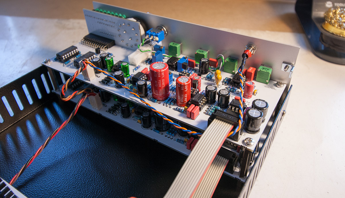

The circuit is based on Igor's opamp version of the 1176 with quite a few changes. The signal preamp expands on a mic pre design by Samuel Groner. The noise floor is much lower than on an original 1176, distortion is about the same (after all - it's a FET comp  ;) ). Compared to my RevD it definitely has the same character minus transformer colouration. All-buttons-mode is also included using an illuminated switch. Input and output are electronically balanced, gain reduction metering is provided by eight LEDs and a couple of comparators. Personally, I've found the boards very easy to stuff and setup and there are no unusual, expensive or hard-to-come-by components involved. The calibration procedure is basically the same as for an original - the video tutorials for e.g. Mnat's versions also apply here.
The next revision of the boards will have optional pads to connect input and output transformers (and in this case omit active components associated with I/O) and exposed pads for an optional LINK switch and the sidechain HP filter. However, all of those options include additional wiring or even additional components/circuitry. When built as originally intended, there's only one 10-way ribbon cable for I/O and a connection to the PSU board.
The complete PCB is a panelized board that includes the main compressor board, a power supply PCB (which can easily be modified for different AC input sources), metering PCB and two different I/O boards; one with XLRs and one with TRS jacks (both Neutrik) - whatever is preferred. Price for one panelized board (which is one channel) is 35 Euros plus shipping.

Nice work, didn't know about those cases, but they are very nice!
How tall/ wide is the main board?

Thanks! The main board is 196 x 75 mm (7.716 x 2.95 in). The height of the assembled board with attached ratio switch board is about 32 mm (1.26 in) without standoffs. I'm using 8mm standoffs on the bottom and 30mm between two boards.

The PSU can be configured for the use with a simple AC (!) wall wart or your usual center tapped power transformer (2x15VAC). In case of the 9VAC wall wart (which I'm using, because that's what I had laying around here) there's a voltage doubler that provides the bipolar +/-17 volts needed to power the circuit. With a couple of simple changes this voltage doubler can be bypassed and you can use an AC wall wart with 12-15 volts. On the other hand, for the use with a center tapped transformer there are other simple changes needed. All this will be documented in the guide. Nothing more than omitting a few parts or putting jumpers in place of a component or two...
The options for input and output transformers are just connector pads on the main board. The idea was to omit the components for the input (and/or output) section and connect your favourite transformer to these pads. Personally, I didn't bother too much for transformer colouration, so these pads are provided 'just-in-case'. Right before the output section is a NE5534 which can easily drive down to 600 ohms. You just have to keep that in mind when choosing the output tranny. For example, a massive step-up wouldn't work too well ;) Depending on your choice of transformers, there should be plenty of space within the enclosure where they can be mounted. You also need to wire the transformers manually, so there's a lot more wiring involved as well  :-X

Will a second PSU be needed to power four sets if one wanted to fit that many in a 2U chassis?

Two boards draw about 190mA of current. Depending on your input AC voltage, one PSU board should be able to power four channels but the ripple might go up a bit. You could increase the filter caps to compensate and make sure your power transformer (or wall wart) can handle this.
