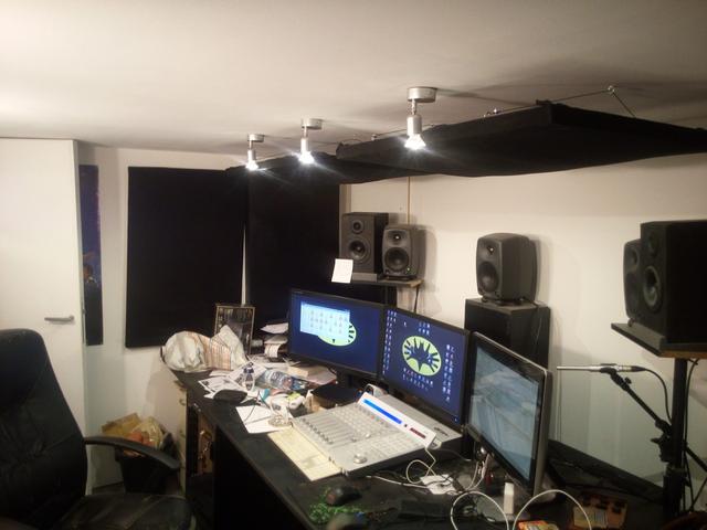

Here are a few pics of what I did :
Control room: it's abotu 9 m^2 (squarred meters) by  2m high, so VERY small...
I put 6 Flat panel absorber (front corners and behind listening position) and 4 Mid/High absorbers (2 top, and 2 sides aiming at first reflection). Please don't look at my mess...  ::)

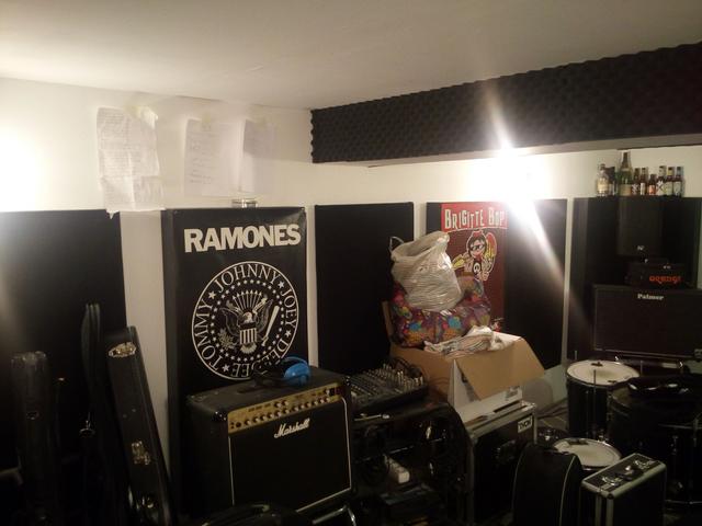

And my studio. It's about16m^2 by 2m high. I've recorded 3 discs in this room, before and after treatment, and it's like Night and Day... I've put as many absorbers as i could, alternating between Flat panels for Low and High/mid absorbers.

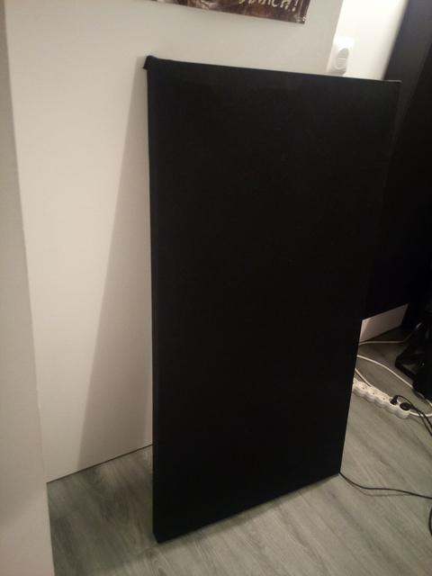

Here's a pic of a Flat Panel Absorber:
It consists of a box of wood 120*60*10cm  filled with rockwool (leave 2 cm of air between diaphragm and wool to let it vibrates)

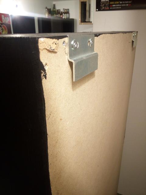

And what i call High/mid absorber. Tha very famous concept of wooden frame filled with glassfiber, coated with fabric.
to fix it flush on the wall: very easy, there's a rail on the wall and those 2 shaped metal things on the back of absorber.
If you have enough room, leave some space between absorbers and wall. Much more efficient, and better in low frequency.

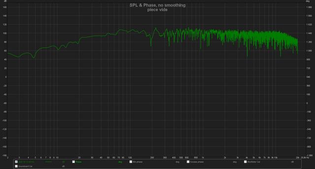

Finally, here are 2 measurements of my control room: (i might make more in the future, but don't have time for now)
First one is without any absorption. Notice the big 40db differential around 200Hz. that was getting me mad at the time.

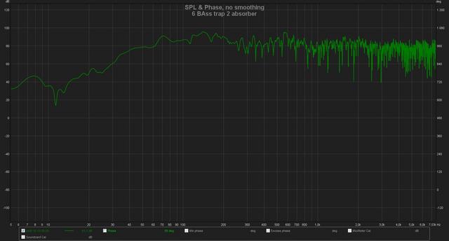

And now with the 6 flat panel absorbers (no High/mid treatment).
The room isn't perfect for sure, but much better. With High/mid absorption at first reflection points, I gained a much better stereo image. And with all that, now i can move my head a few cm and here quite the same thing (before it was dramatically different).
All this treatment cost me about 500€ in France, so it's definitely budget. And it doesn't require many tools to build.
