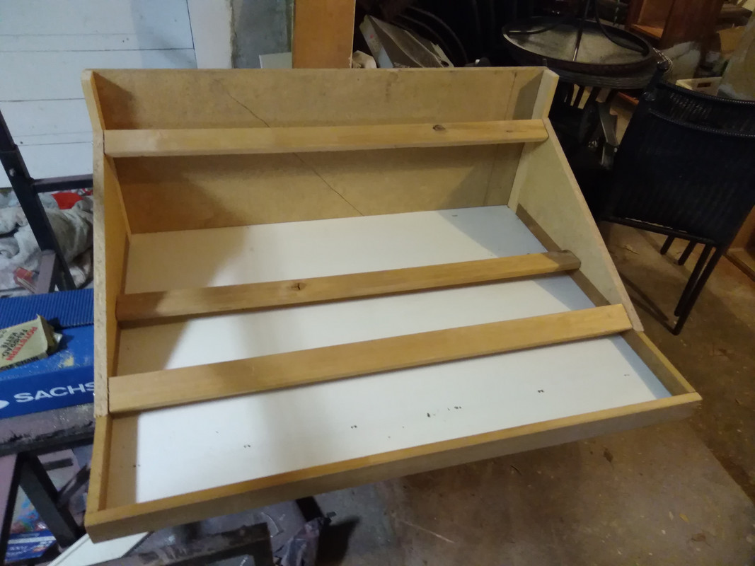

I've been planning a mixing console build for a while now. I started putting the frame together just yesterday from leftover wood I had from various speaker builds.
I'd figure it needs at least mic preamps, low cut, mute and EQs per channel, direct in/out routing, aux buses and some sort of monitoring capabilities. I've been thinking of a buss compressor and a meter bridge too. Initially I've been looking at 12-16 channels with 2 or 4 aux. The frame dimensions are approx. 980mm/780mm/390mm (WxDxH)
So I'm asking for advice and ideas from experienced builders.. also ideas on sourcing components/kits etc, tips for wiring and making the build a bit easier are welcome.

HI,
don't do the same mistake a made in my first mixer: think about the master module's and control room module's  dimensions before committing, especially if you are going to use transformers in it! otherwise you may risk to find yourself out of space for components.
Paolo
++1
I'm living this lesson presently.  I get that building the frame gets you motivated and on the path. It's what I did. However from PCB design to ergonomics to scope of functionality, all gets constrained or relaxed by the frame, and the frame of course does not care how many features or mistakes or blinky lights you discover are necessary or want to account for along the way. Therefore build the channel first, keeping spacing of components you'll be touching at the top of your decision making process. Once you've got a working channel with a black plane that fits well, with all the bells and whistles you want, wrap those beasts in a frame that fits the circuits.
boji said:
++1
Atm I'm trying to approximate the BOM for a single channel and multiply that with the number of channels.. and hell no I'm not rolling all those caps, this isn't a sweat shop and they need an active stage to drive them.
Ok let me be more...blunt.  Chop up and set fire to your wood frame.  Remember in your mind's eye the angles you find appealing but forget the space it occupies for now.  Let the features that you'll discover or modify along the way determine the final geometry.  If you don't you'll just have to take my word on it that it will cost you weeks, or in my case,  months of finding 'solutions' to problems you didn't know you didn't know you had in the first place. This includes assembly of all the channels.
