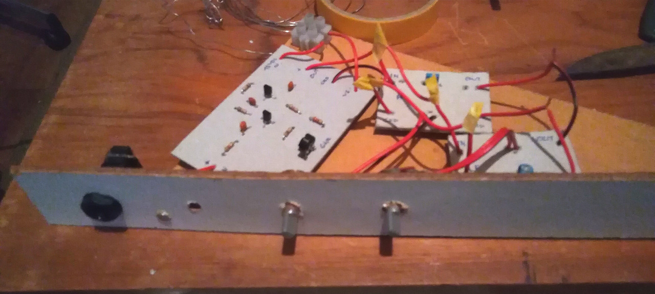

« Reply #75 on: January 02, 2019, 01:07:13 PM »
Here's a pic of a prototype channel strip in the making..
Is this circuitry functional, and does it meet your criteria of passable quality?
If yes, then I think you have much more room inside your mixer frame than you'll need, even if you wind up having to squish those parts together a bit more. Though I'd certainly add my voice to the chorus regarding shielding, at least line the cavity with some aluminum foil.
I'm sailing a similar craft in that I also have the hard limit of an exterior shell I'm planning to fill out, in my case it's an old Tapco 6200 enclosure.
But I'm going to run into spatial constraints really fast, as I'm planning on starting my signal chain with a dumbed down Jensen 918 based discrete operational amplifier:
All of that functionality (make signal bigger now) could fit on a postage stamp with room to spare these days. But, my design goal is pretty simple. I want six mic preamps in a box with balanced direct outputs, and the added functionality of a dirty mix, so I think I'll be able to sleep at night when it becomes imperative to use some monolithic ICs for other stuff in the summing and sending stages.
Regarding the original post/title, I'm reluctant to offer advice on your build as it seems you are not receptive of ideas that are not loaded with confirmation bias - but I am happy to say that if this project is performing to your needs then you're on an okay path that will probably not be followed by most (which is where culling technical advice in the face of a problem becomes quite tricky).
Belay that: is there a trimpot labelled "Gain" on your input circuit? Why is that not a panel mount control?
Please do not confuse anything I say with good advice.

Re: Advice and ideas for a mixing console build
« Reply #76 on: January 02, 2019, 01:45:24 PM »
It's a prototype.. like the circuitry itself.
Better to have enough than run out I guess.. makes troubleshooting easier too once (or if since I'm really busy) it's assembled.
It's a prototype for testing purposes.
« Reply #77 on: January 02, 2019, 01:49:47 PM »
In my experience a prototype is useless if not functional.
Does your prototype work, or is it just conceptual eye-candy?
RMA
machine (b)log
« Reply #78 on: January 02, 2019, 02:09:33 PM »
Well, iirc it passed audio.. that's about it. (edit : there was something wrong with the filters I guess)
To save space I would rather use a separate, bypassable mic pre module about the size of a matchbox. The idea was to see how the modules would fit the channel strip, and they did; the problem is lack of resources and time (note that I'm also building a PA system)
