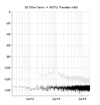

I don't have a mixer but I have been a little psycho about measuring noise so I can tell you what I would do to evaluate honestly.
First, I would measure the noise of your converter by terminating an input with 50 ohms just to see what the absolute floor is. This is what I get with my MOTU Traveler mk3:
However, I always make noise measurements by using a tone to find the clipping point and then I turn off the tone, record silence and then plot that with GNU Octave. So 0dB in that plot is actually the clipping point and not 0dBu. I can always adjust for that later but I actually don't recall what the clipping point is on my MOTU. I think it's in the +4dBu range. Actually there is a control in the MOTU software to adjust the input level pad that you will want to try if you have it so that you can put as much signal through your desk as possible before clipping the converter. So assuming it is +4 then that plot should be adjusted upward +4. So it looks like the noise floor of conversion is still well below 120.
Then I would measure your mic pres but use 150 ohms term because that is more realistic for a mic. I have a DIY API pre that looks like this:
Again, this has to be shifted up ~+4dB at least because of how I make noise measurements.
You can see how it's useful to look at spectra because the mains hum will push meter readings into the 90s but thats not really the "noise floor".
I think -90ish is pretty good in practice but I would want to see high-res spectra to "see" for sure what's going on.

One thing you need to be very careful of is that the value of the level shown in a spectrum plot is not the rms noise floor over the full 20KHz bandwidth. What the spectrum shows you is the noise per unit bandwidth.  The rms noise is the sum of all these noises over the 20KHz bandwidth. Good spectrum analysers will have a function to convert this into rms noise over a given bandwidth.
Note that if your spectrum analyser shows the noise per root Hz then you need to add 43dB to this value to get the rms noise over 20Khz (which is what you actually hear). So if the spectrum bumps along on the -140dB line, the actual rms noise is about -97dB.
