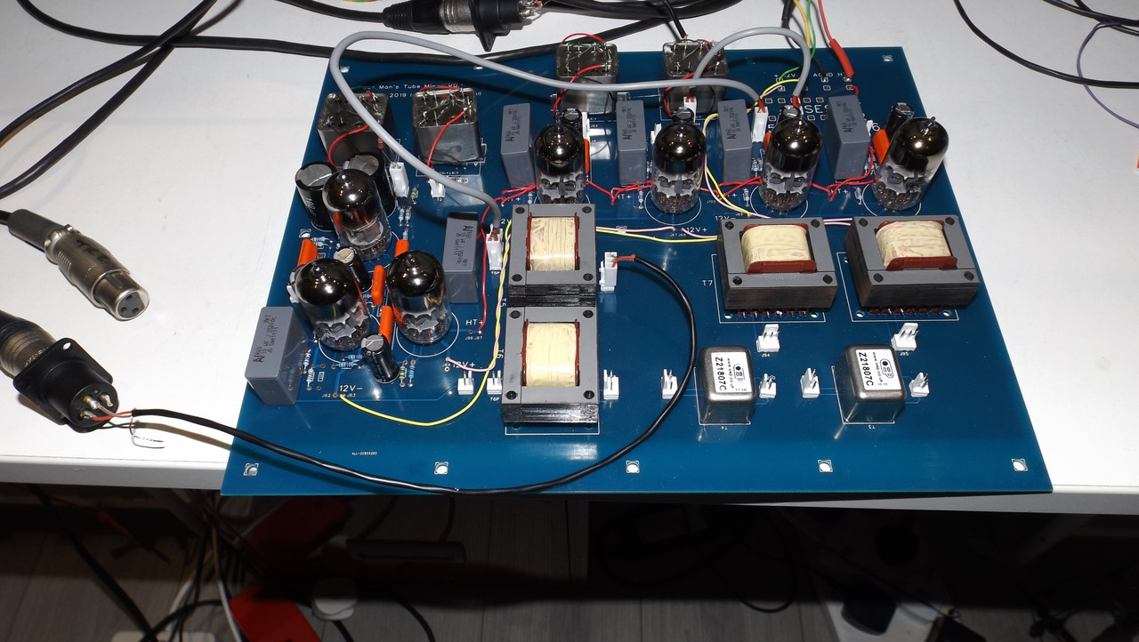

Quick update. I found a satisfactory method of mounting the input transformers on their backs so they could still be used on the prototype despite the  cock up on the PCB footprint. Tested one and it works OK. Next job is to fit the other three. Also discovered I managed to wire in one of the output transformers in backwards. Should be fun getting that out.

I have now glued all four  mic input transformers upside down on the PCB and hand wired them in (due to the error I made in the transformer footprint). This evening I connected each in turn via one of the mic pre amps and verified they are wired/work correctly. Laos checked overall gain via mu follower stages is 42dB (with input and output transformers). Rough noise measurement indicates EIN is in the -122dBu region.

The poor man's tube mixer (PMTM) is a work in progress, in fact it is in the very early stages of development. So far, the PCB you see is all there is. This is still being commissioned and tested and it contains known errors. Once that board design is complete there is still have to design the front panel PCBs on which the various controls are fitted. There will be several of these to allow builders some flexibility in configuring their mixer. The there is the rear panel to do. Then the whole thing needs to be built and of course there is a power supply to design and build. I expect it will be several months before I am anywhere near to releasing the completed design
