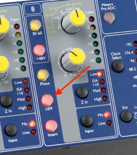

Hi Guys,
anyone know who makes the illuminated push button switch for the Focusrite Isa series?
I've been looking everywhere and I can't find anything similar.

I‘m pretty sure they‘re made by EAO. Could it be this one?
https://www.mouser.com/ProductDetail/EAO/19-431035?qs=2pKMaj72wiF%2F8smYrHEAFw%3D%3D

Thanks for the info.
That's exactly the switch used in the Red series.
But the new Isa series uses a smaller cap. EAO switches can be ordered without the cap. Focusrite probably had one made for them...
Scratch that... it's the same switch. The cap is 7.3mm but the switch is mounted behind the front panel.

Yes thats what i thought as well
