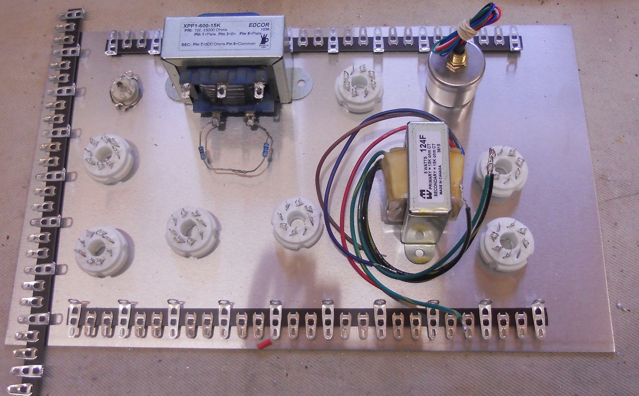

This is a schematic I have used several times (660's) because it's simple and it works.  Because the current is around 70mA it's asking a lot of an EL34, but I have several 6080's and one of those paired up will work fine.  The original 96A used a separate power supply, but this chassis is big enough to take it onboard.
I use several 240 to 2x55V 50VA toroids for this design as the under used regulation  gives a voltage boost.
These are the provisional values of the components, some may need tweaking on test.
Soundcloud: Delayed Action.

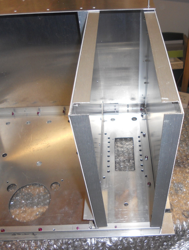

I have made the sides and power supply wall and the removable base plate so far and I'm preparing the back panel to take the various in/out sockets.  This is the view of the base.
The accuracy is about 0.25/0.5mm which is the best I can do with hand tools in a reasonable time.  This is the power supply housing where the toroids are mounted vertically.  I will assemble the transformers on the side plate as a complete unit before attaching to the rest of the chassis.  Connections will be accessable via a removable back panel.

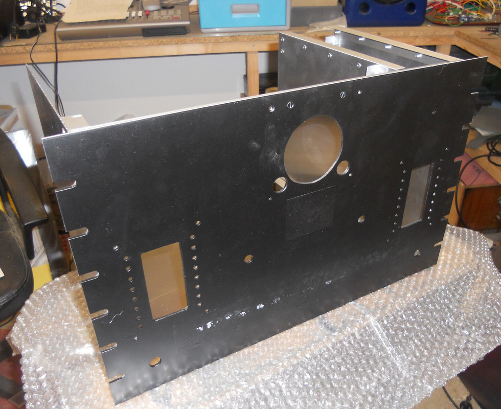

This is the front view showing the large size of the 96-A, and my version is several inches smaller!  Ian  wants to rest another unit on the top so I will provide a top to go over it.
The dimensions are all settled now, although not all the panels have been cut to size yet.  I can now work on the physical layout of the components on the main chassis.  This can't be rushed as you have to imagine all the connections and components in place.

All the panels are now cut and fitted so the chassis is now finished.........
The large back panel gains access to the meter and switches, and the ventilated panel on the left is for access to the power supply.
