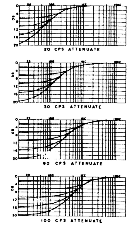

Re: Pultec EQ - High Shelf possible?
« Reply #9 on: April 28, 2020, 05:03:33 PM »
As has been mentioned, there is no accepted definition of the 'frequency' of a shelving EQ. If you look at the 100Hz cut curve of the picture below, which is taken directly from the Pultec manual, you will see that at maximum attenuation, 100Hz is 3dB before the flat part of the curve.
All shelving EQs have two 'turnover' frequencies. The first is where the response starts to change and the second is where it starts to flatten out again. As you can see from the Pultec curves, these frequencies are about a decade apart. The frequency where the response starts to change is fairly constant but there is no point labelling this as the frequency of the EQ  because it is far away from the frequencies at which any audible effect occurs. However, the frequency at which the curve begins to flatten out varies a lot with the amount of boost or cut selected, indeed it is by varying this turnover frequency the  the EQ operates.  So which of these many frequencies should you use to label the EQ?  Pultec seems to have chosen to use the frequency where the boost/cut is 3dB from the maximum when the boost/cut is also set to maximum. In my version I decided to do the same.
If you compare the Pultec low shelving and boosting curves with this in mind, you will see that the turnover frequencies for a given labelled EQ frequency differ between boost and cut. This is deliberate because the boost and cut have separate controls. If they both operated at the same turnover frequencies they would effectively cancel each other out. Instead Pultec separated the frequencies with the result that if you apply both boost and cut you get the well known Pultec bump.
