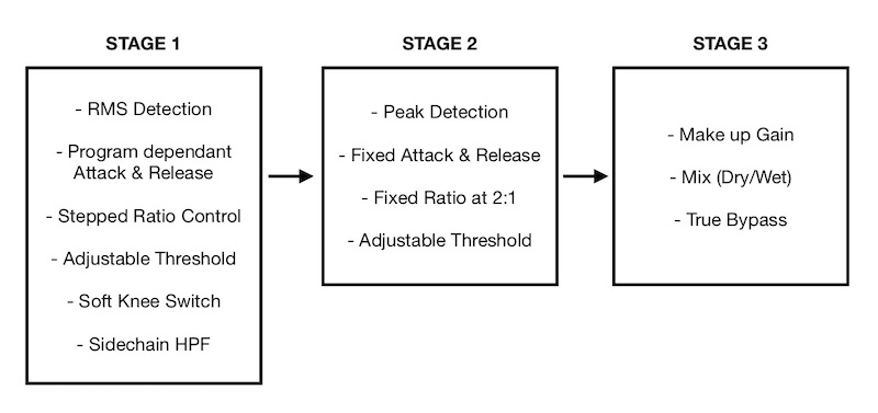

Let's start with a bit of history. Some of my friends and colleagues are dialogue and foley recording engineers. They have been asking for a transparent compressor that could adapt easily to the incoming signal and help control wide dynamic range recordings.
The first prototype I made was a VCA compressor with RMS detection. It worked beautifully on vocal, but the foley guys needed something to tame the peak as well... So I added a second stage of VCA compression with peak detection. This is not a limiter, but more a peak attenuator. The ratio is fixed at 2:1, Attack & Release are also fixed. You simply turn the knob to the desired amount of gain reduction.
Here’s a small diagram showing the configuration:

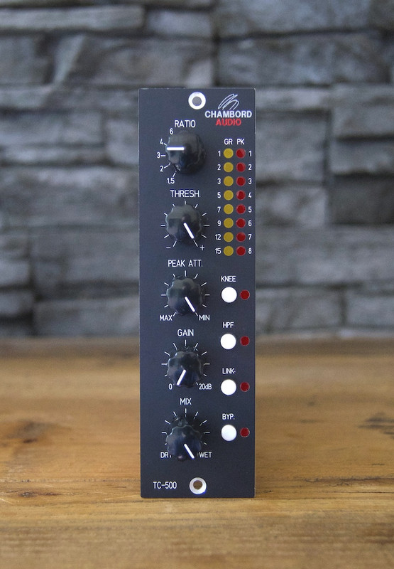

The goal here was to make a versatile compressor that is easy to use and gives great results fast. I’m really happy how it turned out :D
It’s already in the recording chain of two local studios and it saved numerous dialogue takes from clipping the converters.

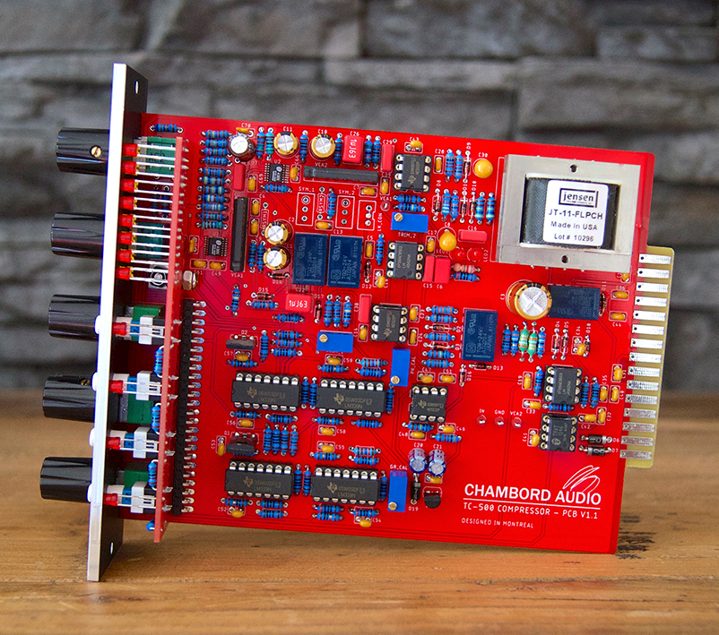

p.s. please try to include the jensen xformer
Looks amazing.....
One thing you could try is to put the Peak Limiter before the compressor. I have found in the past that this "helps" the Compressor stage. It seems to allow the Compressor to work more easily and just compress the signal and not have to deal with extreme transients.
I used to have 2 dbx 165s and the first just did some slight Limiting, trimming the peaks off, and the second 165 was the main Compressor. Sounded absolutely gorgeous. The 165 internally is set up as compressor first and then limiter.
It even works in the digital domain as well. In my Protools template I have all my channels set up in this way, Limiter first then Compressor. I find the Compressor sounds more natural and nicer.
