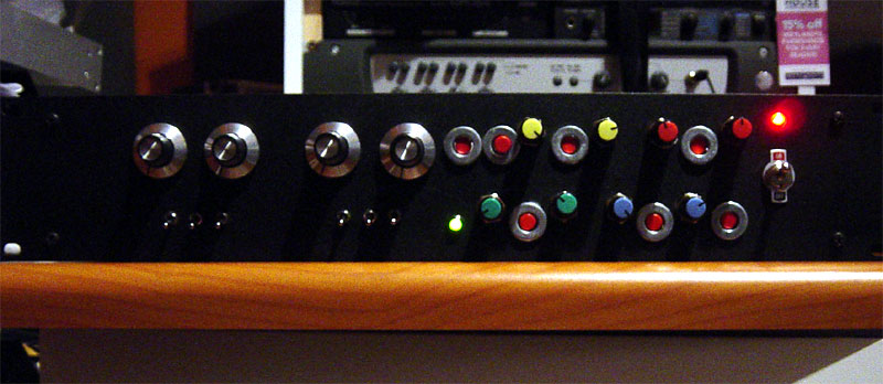

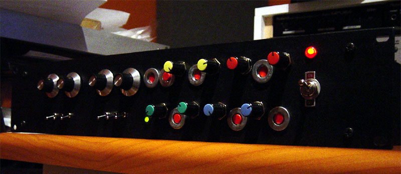

It is finished! Behold the Ghetto Rack, master of low cost DIY and sucky metal work, but boy does it sound sweet  :thumb:

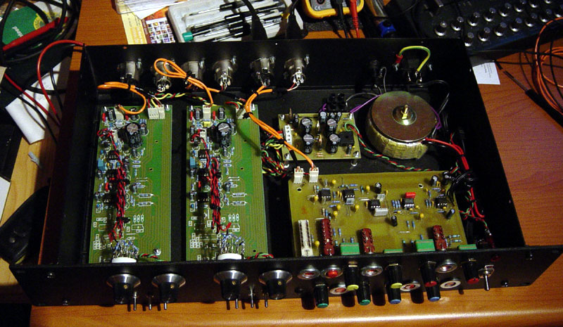

I have been working on this for far too long. The initial plan was to build a channel strip comprising of a Green Pre, What Compressor and Calrec Eq, each with independent I/O that could be patched through a Patch Bay.
After building one V14 Green Pre with better quality parts from my prototypes I decided I just had to have a pair and so the channel strip is now a pair of Greens and a Calrec Eq, and the Comp was lost.
The electronics were the easy part! My metal working skills suck, so pardon the homebrew front panel? I couldn?t spring for the cost of an engraved panel, but kind of think it looks retro this way.
I must thank you all for your support, I could not have done this without your help, guidance and willingness to share. I want to thank Peter C for the boards and flury of e-mail responses to my questions and 2 dear friends, Fabio and Nino for their support in the creation of a channel strip.
There are too many other to name, but you know who you are :thumb:

Very nice job! I love those big latching buttons (if that's what they are :oops: ). It's all very colorfull.....

Thanks guys for the kind words. Radiance, they are indeed latching switcheswit some good old Red Buttons, they came out of an old MCI tape machine I think, I got them and the board from Peter C who had it lying around.
I drilled oversize holes to get them through the panel and then picked up some galvanised washers and glued them to the panel to make the buttons look a bit more elegant and to cover up my bad metal work :green:

I was just wondering on this channel strip, where exactly does the Calrec EQ circuit get inserted?
I was thinking of building a 1272 with the Calrec EQ.   My guess is it would go after the BA183 output and before the Output transformer.

Hey Mike - your BA183 needs to go straight to the o/p transformer... there's a bunch of DC & a feedback loop going on there (or something like that  :grin: ) that needs the gapped transformer to work properly.
So the Calrec would go after the transformer.  You may find it a little difficult combining those 2 in a box - the Neve needs 24v DC & the Calrec is +/- 15-18v DC I think!

After further thought...Perhaps it would be best before the preamp circuit?  Otherwise wouldn't I be entering the Calrec with too hot of a signal?
Agreed that it would be tight in one box!  Perhaps the power supply would have to be outside the box.   I'm really just brainstorming right now as I have just built my first dual 1272.
The thought being that the Calrec looks much easier than the 1073 or 1081 type eq to build.  thus I could still have a [email protected]@ish pre with a 4 band parametric at a fraction of the cost. And hopefully fewer headaches.
