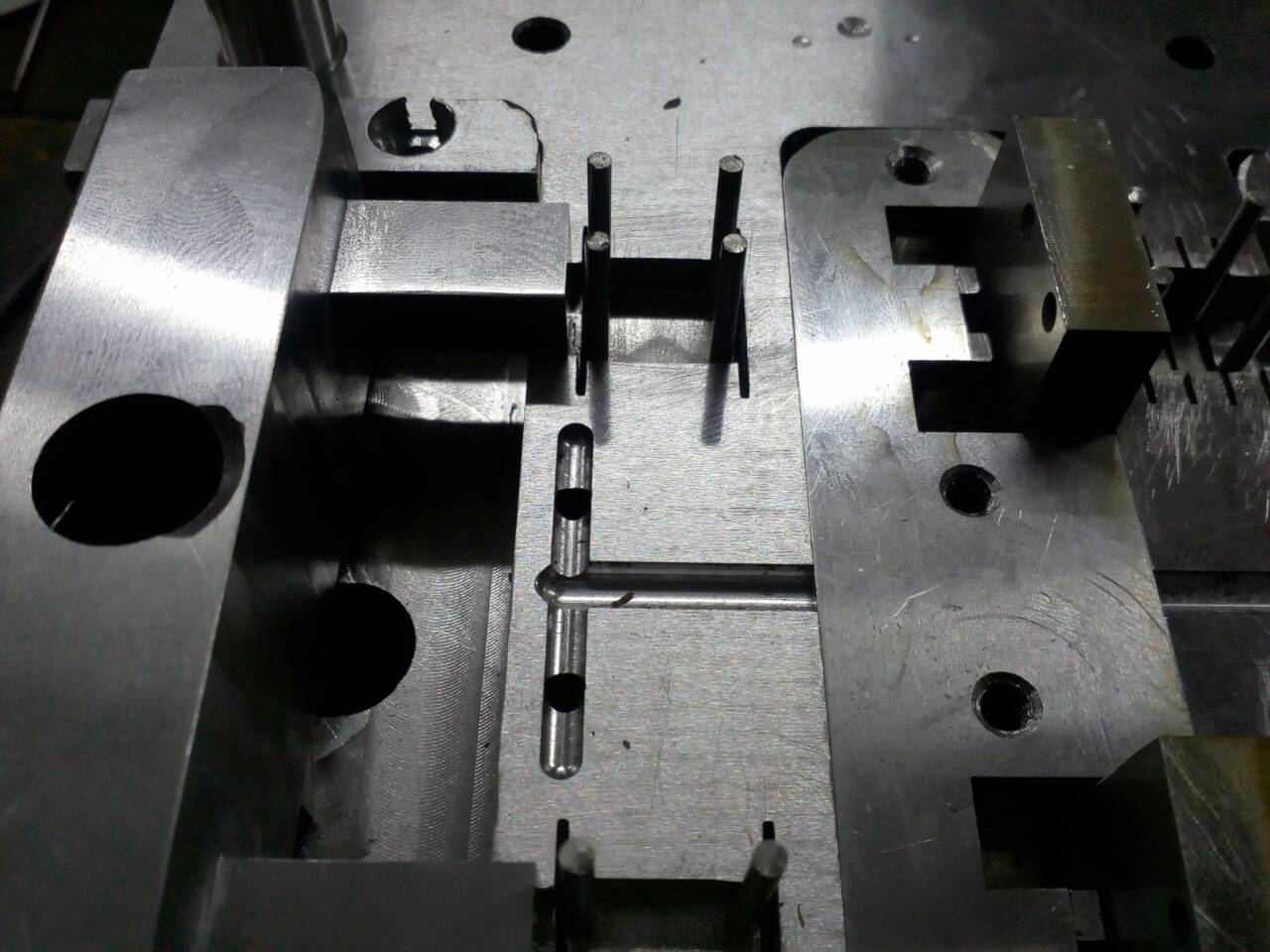

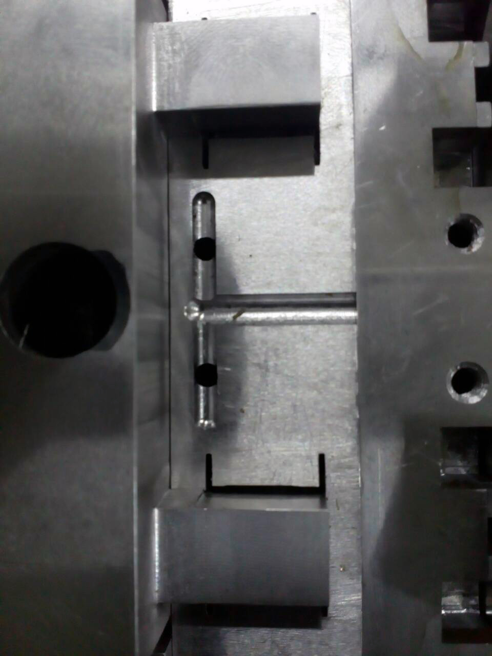

Hey guys, I started this thread to keep you informed about the progress and later for support in assembling, experimenting, etc.
As you probably know, the most challenging part of this project is design of the bobbin tool and it took me most of the time to make it perfect. Actually, I used the local tool maker shop service and they are still fighting with some minor issues.
Alternative option was 3D printing, but I was not so happy with that option because it doesn't look as the original and the material can't be the same.
So, here are some pictures of the tool. Wish me luck, I expect some good news today because they do corrections in  the design and I expect after 2 months of waiting to be as done.

So what exactly is this "bobbin tool" for? Making the bobbins themselves, or winding them, or..?
Making the bobbins.
Edit:  Neumann used custom shaped, non standard bobbins in their UI30/25 transformers range. All todays recreations use modified or similar shaped bobbins (withouth 4 chambers or with inserts). This series will use original shaped and more important original material bobbins. But it has a price. Custom plastics injection tool.... ;)

Hey, thanks for asking, happy new year. Its moving slowly. Finally toolmaker sucseed with bobbins. I wait for the right material version (it has to be transparent) and winding will start.
    90.5 KB
If you want to see some more progress photos, please check here.
https://photos.app.goo.gl/YeFuQGEWlrvVNo6O2
Mostly failures,, but thats usuall with plastic molding tools.
Checked out the Google drive photos and this is amazing!
I know nothing about plastics so I Googled it to get an idea. Plastic pellets into your injection tool that heats and injects the molten plastic into your bobbin tool?
Does your tool do two pieces at a time? How long does it take to cool before you can repeat the process? I'm super impressed.

thanks. 4 pieces at once. It goes very fast :) just a  few sec to cool down.
