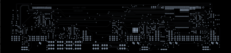

Hi DIY people,
For a new project I'm building a small Orion console from some spare channels that came with a bigger unit. I have all of the required parts (extra master etc.), as well as new PCBS so I can build some extra channels (to get up to 16, or 24, (I have 15 spare channels, and 6 stereo returns).
I would really like to add one particular modification to this small console (seeing I will be making new faceplates, and can accomodate controls on a new (wider) faceplate).
The modification would be adding two pots (or a push pull...?) for variable Q shaping of the two mid bands..
Stock, every channel has a high and low shelf, as well as two mid bands, but none are variable in shape...
The EQ is good, but it's often too narrow, or wide, depending on the situation. (I'm only looking to change the mid bands, the high and low shelves are fine.)
Obviously I'm under no illusion that I can figure out exactly how/what to do myself. I have only (relatively) recently started my DIY adventure, and although I have purchased a book on circuits and design, and am trying to learn, I am not yet capable of this.
Therefore, my idea was to ask a professional to perform this mod to one of my channel (or show/mark exactly in the schematic/on the PCB what to do where) and create a small BOM with required parts, I could then easily perform the mod to all of the other channels I'd like to modify. (Provided the BOM is there, and I know what traces to intercept where, or what jumper go where...., etc. etc.)
I'm quite sure it's not as easy as replacing a resistor with a pot... for variable resistance....
I would love to know how realistic/feasible this mod is, so I can ask someone, perhaps someone knows a good person to ask..? I know it might be hard, but I just need to know how 'possible' it is given the layout and circuit.
Maybe (if it requires an additional op-amp, or whatever), I could get a small PCB made that attaches to the main board via jumpers.
When it comes to where to fit it physically, I have a few ideas, but for the purpose of this post, don't worry about whether there is enough room.
Below I have attached the main schematic, as well as linked some more relevant info.
I really appreciate your answers and time!!!

You would need at least a dual opamp for each band plus some extra components. Have a look at the mid bands of the SSL EQ to see one way of doing it.
It's a very extensive mod. You would have to use a different topology. You would need to depopulate the existing EQ, install an add-on PCB, and establish all the necessary connections.
It's so complicated it's not worth doing it, particularly considering there are inserts on this mixer, that you can use for additional EQ if needed.

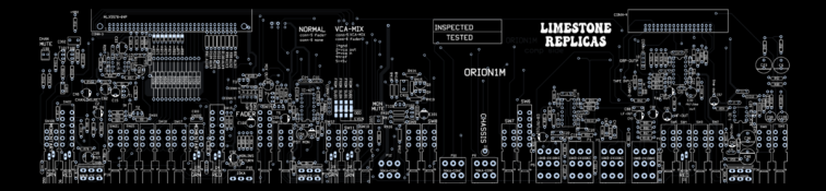

Thanks again for your insights, in case I'm coming across like a stubborn ignorant newbie, I undoubtedly am, and again appreciate your insights as someone who actually knows what they're talking about. I really don't mean to be disrespectful, and understand it gets tiring replying to these types of post all the time! I have read many archived threads where people propose cool ideas, but are obviously not skilled enough to actually complete/realise them, and am aware it is not an easy undertaking. Hopefully this won't become one of those threads, and there will be progress posted in the months to come on this EQ mod. As I mentioned before, I'm not designing it myself, I want to employ someone to do this, and then follow the BOM/example/manual provided by them (assuming I find someone who can figure out how to make it work).
This (the tiny orion project) is a long term project, that will hopefully be finished in 1-2 years, not something that will be fully finished before the end of summer. As I mentioned it's definitely a I want to do this and it will be fun and a great learning experience type project, not a, great value for money invested project... haha
The original console is modular, so the 'left over' channels I have, can (and are normally) connected by Ribbon cables, nothing else, it's a very simple design compared to other console I have seen. I know this because I have the actual complete larger Orion, in which modules can be clicked into the ribbon cable, and pulled out and moved around, wherever you want (as long as the jumper settings for the floating subgroup are correct).
So there are separate LED meters, channels, stereo returns, and a master etc., all connected to a ribbon cable.
Because the 'tiny Orion' will consist of some newly built and already existing channels (I have spare 15 existing channels, 6 stereo returns, and a master, and a PSU, mostly NOS), I was going to need to make new faceplates anyway for the extra channels. This sparked the idea of modifying the faceplates to be wider (see below as to why), and then I realised this would also free up space for the potential bandwidth controls. I am currently in the process of assembling the reverse engineered rev. 1 channel PCB (visible in the photos above), in order to ensure it works properly before I progress to the next stage. I am also making a frame for this 16 or 24 channel desk (I'm still deciding how big I will make it), but I will only start drawing this when I know the dimensions of the final modules of course. This also means that I can accomodate the size/shape of channels and controls. Ideally as I mentioned, I really don't want to change the main PCB, as that would allow me to use the existing spare channels with a different faceplate, and I wouldn't have to build 16 channels from scratch. As I already mentioned, I either want to build 1 or 9 channels, so I can get to a total of 16 or 24. I'm not modding the master, stereo returns, or led bars etc.
I have had the existing faceplates 3D laser scanned by a local business and have editable DFX and Autocad 3D files which I can use. My family member is also able to edit and use the software (solid works, autocad, etc.) I'm making the faceplates wider than they are now anyway, so I can put my 500 series racks (I own already) directly under the channels in the frame I'm building, and have them in line with the channels. These will just be connected to the inserts, not integrated into the circuit in anyway, just so they are easy to reach and physically positioned directly under the channels.
Before I have the new faceplates made, I would obviously make sure the modification and extra adapter PCB that will be installed work, and that there is space, also within the frame, so it can be integrated into the faceplate design.

OK, got you. It's not really modding an existing EQ. You want to by-pass the existing midbands and graft a parametric EQ.
You have some choices:
State-variable, like SSL, Urei
Twin-tee, like GML
CAPS, as in Steve Dove's Studio Sound articles
Wien-bridge like Audient
You must make a choice. If someone tells you they all sound the same, don't belive them, but if someone tells you X is the absolute best, he'd better have stronger arguments than "it sounds better".

It's the ratio between the two caps in the modified Wien-bridge. A true Wien-bridge has equal caps and res. Increasing the cap value in the series leg increases "Q" (decreases BW) but also increases Boost/Cut.

With most EQ topologies (except SVF), the interaction between BW and max cut/boost is absolutely impractical.
For the Wien bridge, all other things being equal, a caps ratio of 1 results in max B/C of 9.5dB, 14dB for a ratio of 2, 17dB for a ratio of 3, and 36dB for a ratio of 30.
The ways to achieve complete independance of Q with B/C are rather complex.

You cannot easily modify a wien based bandpass filter to switchable/variable Q, the Q is a function of the ratio of the capacitors, as obviously is the frequency range. You also have to pad the input to the wien (with the higher Q) to maintain the +/- range, so the amount of switching that has to take place.................... No thanks!!
C. Having said "none" however, you could do daughter board(s) that replaces the wien with a SVF with switchable Q. The switching is simple (changeover/shorting out of a resistor). This would be a pull-pot on the level pot, (cheaper than on the dual RA frequency pot). 2 dual chips.
The point of the SVF is that the 3 parameters are independent (in theory).
This is how a Nashville based manufacturer did this. You either ordered stock EQ with wien circuits or enhanced EQ with SVF sitting in the same place in the circuit. The inverting pass amps were on the main board, the tuned circuits were on daughter boards.
