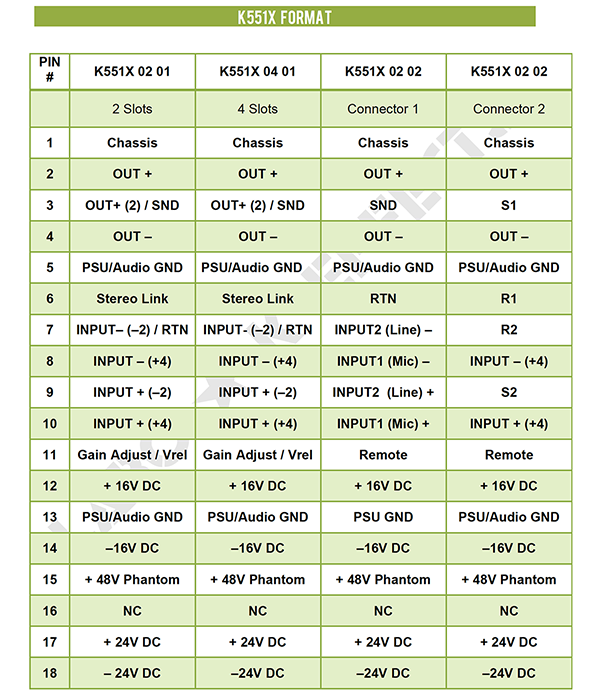

The 15 pins of the connector provide the standard +16V/-16V and 48V for phantom power. A balanced input and output as well as a link for the compressors.
There are still some pins used by some PLC modules (2nd unbalanced input/output for 512 preamps, gain resistance for 515 modules etc.)
A new 51X standard has been introduced to provide additional options by using an 18-pin connector. This allows to add the necessary +/- 24V voltages to some modules while keeping the compatibility with modules typically in 500 format.
Indeed, the 500 modules only use 15 of the 18 available pins.

If I understand your idea—in order to go into or out of this novel linked module mode; must one pull the modules out of the rack  and change switch settings?
The module must be planned or modified for this purpose
The Master module must include an Insert switch that controls the backplane system (by connecting pin 11 to the GND)
The master module signal and the slave module processing part must be directed to the special backplane. (pins 3 & 6) and (pins  3-6 & 7-9)
The special backplane is equipped with 2 relays that when not activated behave like a true by-pass. The signals of the 2 modules return to them.
When the Master Module Insert switch is activated, the relays are also activated and the processing part of the slave module is inserted in the Master Module path.
