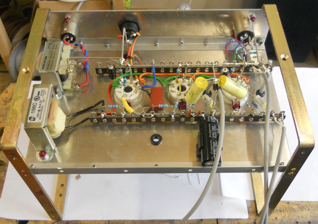

The original steel chassis was pierced all over so it was easier to make another from ally sheet.
It has an interesting design as the whole thing is secured by four screws on the front panel to the main steel box.
The ground, B+ and 6.3V for the heaters comes in from a separate box via the Bulgin plug and socket.
The supply is DC so no need to twist, hopefully these measures will give better hum performance  than the original.

The pre-amp is nearly finished with most of the components in place.

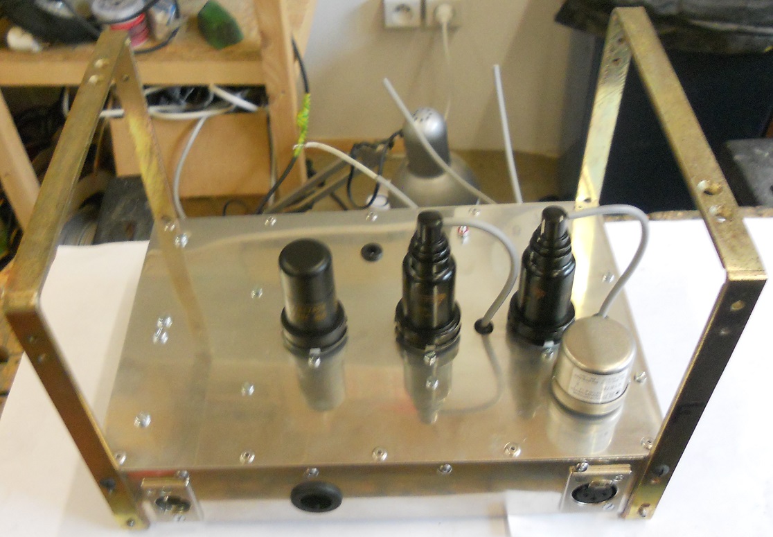

I found some neat grid caps on ebay for the 1620's,  These tubes are from Heintz & Kaufman who made transmitting tubes in San Francisco, I'm not sure if they are RCA rebranded or made in-house.  This is an original interior (courtesy of Retro Gear Shop) it looks very busy compared to mine with modern components.
Here you can see the Hammond 156C choke and Edcor OPT.  Because the output Z of the 6J5 is much lower than that of a 6J7, the inductance can be lower to allow use of this choke.  The OPT is parallel fed so an Edcor WSM15K:600 does the job.  I have connected it so the phase between input and output remains the same.

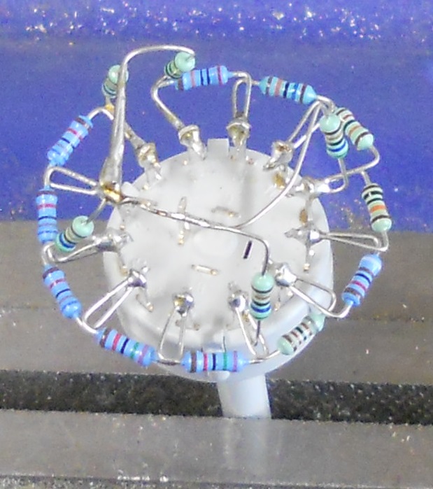

The gain switch was quite easy to make using 0.6W mf resistors, I just tied the ladder "rungs" together for the earth connection, this will come from just one screened cable to avoid hum loops
I now have to paint the front panel before assembly.  I don't have time or inclination for an exact copy, which is not possible because I have put the sockets at the back anyway, so it will be an "homage" to the original.
