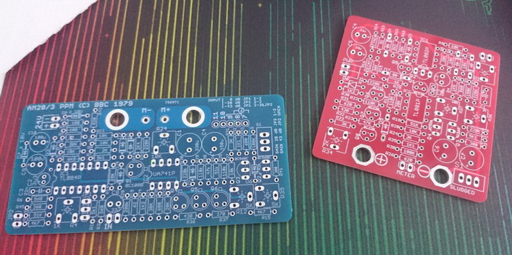

I decided to allow myself multiple choices. As a consequence, having some spare time this year end, i designed also a pcb using the schematic from the BBC paper.  I also refined the surrey ppm3 clone and sent gerbers to a Chinese fab house. I plan to have one of each populated, tested (hope i did not mess the designs) and come back with the result.  If the designs will work as expected i will have a bunch of extra boards for both designs. If anybody wants one i will be happy to give them away for free  ;) ... if they work...
I also updated the content (eagle files) on the link for anyone interested.
BBC AM20/3 pcb
Surrey PPM3
Both surrey and BBC schematics have a SPDT switch  labelled normal/slugged mode.  In slugged mode it switches a pair of caps in parallel with the meter witch i believe dampens the motion of the needle.  I really don't know the use of this, maybe there is someone here who does  :D

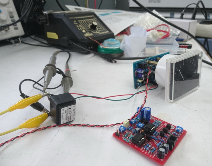

Hello to all,
One week ago i received the pcb's from China. So far so good, i got some time and populated one of each. Without a signal generator i powered on the first board (AM20/3) and looked good - no smoke. I terminated the input with 600ohm and set the 0 trimmer. I was delighted.  same with the Surrey based board.
After another day i borrowed from a friend a signal generator and started the test.  The needle was resting left on any signal..not good.. and both drivers behave the same.
I switched the meter polarity after following the schematics using an oscilloscope and checking every stage of the signal... and finding negative voltage on the meter + terminal. Duhhh... I failed to pay attention on the meter polarity and assumed wrong based on the schematic position (-10v above the meter, 0v below).
The meter drivers are working awesome , both of them.  In order to mount the board on the meter i had 2 choices - first to rotate the driver 180deg , but it would not fit the case.  Second choice - to make some brass spacers (given that the parts are now on the meter side of the board... )
I made a passive monitor controller and included this nifty gadget. Now i'm happy.
I learned a lot doing this project  and now i feel a little bit more confident on my electronics skills (i usually design buildings ;)).
Same link as above, i put some pictures and videos of the build.  Also, as previously stated, if anyone wants a free pcb (i have available 8 of each) please pm the mailing address - i'll be happy to post them.
