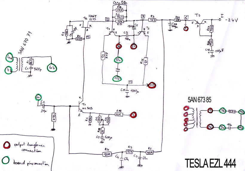

Here is the schematic I draw :
My guess is 4a and 4b are the inputs and 9b and 9a are the output pins.
12b, 12a and 2b are connected to -24v and 1 is connected to ground.
I think 6b should be connected to 6a (directly ? with a resistor ? with a capa ?)
I don't know if 10a, 10b, 9a and 9b sould be connected anywhere.

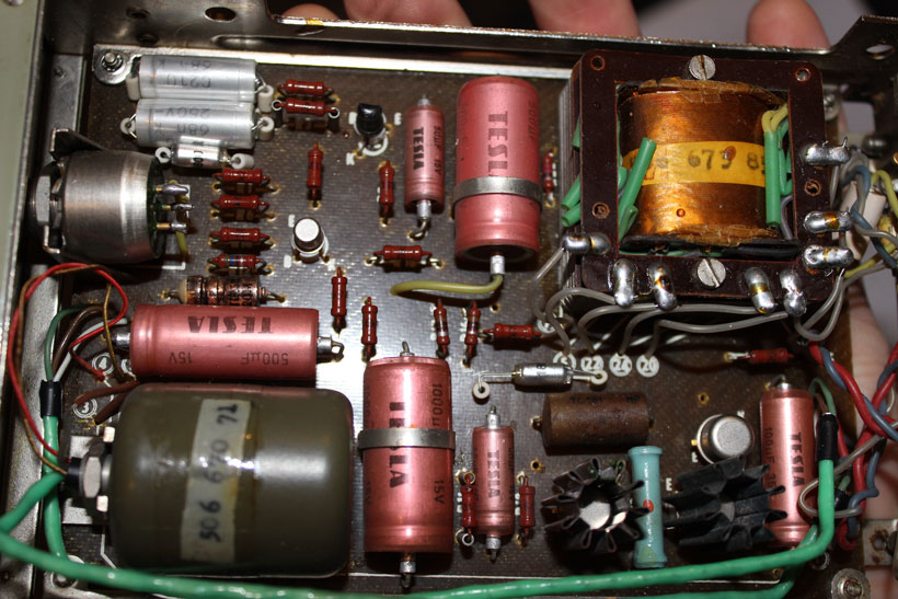

There seems to be 5 connections on the output transformer's primary and 2 on the secondary.
The primary connection on the board are 5, 7, 20, 22, 24 and the secondary are 1 and 26.
The output tranformer is : 5AN673 85 2+2+1:1 výstupní linkový 1,55V, pult EPP102, jednotka EPE401, EJV441, jádro M12
Google translate says : "2 + 2 + 1: 1 output line 1,55V, counter EPP102 unit EPE401, EJV441, the core of M12"

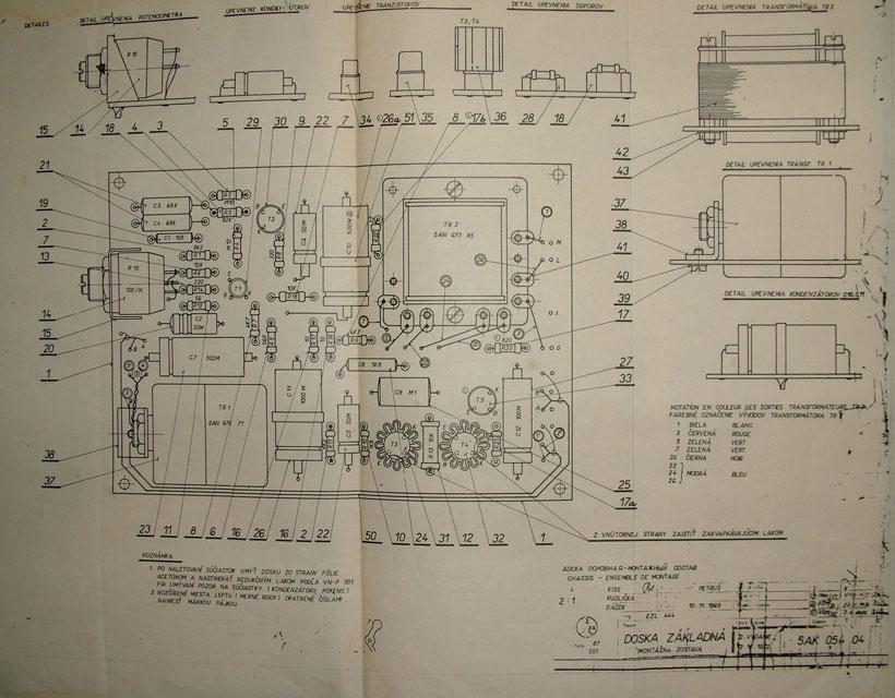

Here is the only document I found on internet about this preamp :

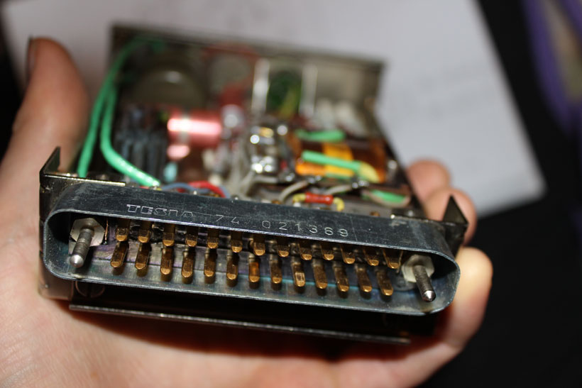

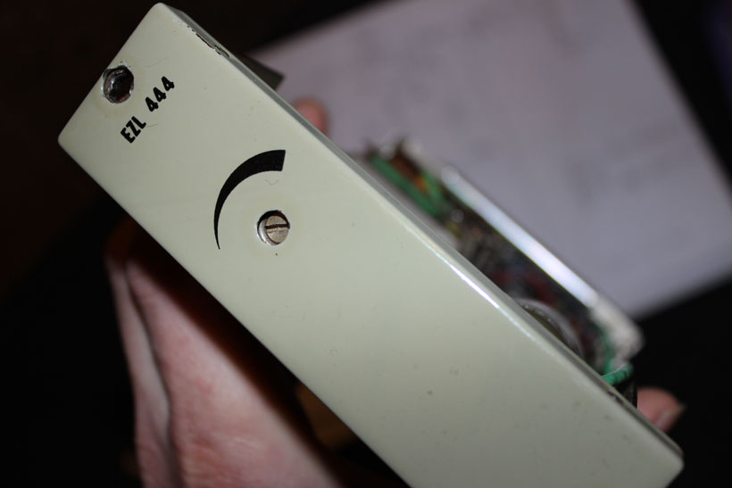

And a few photos :
