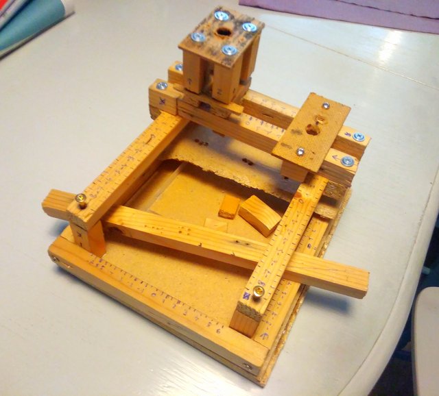

Last weekend I built a small router prototype to work with wood (it works surprisingly well with engraving/cutting plastics too) :
It's only capable of x/y axis (ie. perpendicular lines, so no 45deg angles or circles etc unless the workpiece is rotated) and a 30mm z axis (depth) with a work area of 160mm x 120mm (the overall footprint is 230mm x 200mm)
I added some stuff after taking the pic like clamps, a semi-disposable MDF work bed and a tool holder for hot glueing etc (the ~6mm hole for the drill bit/soldering iron gets clogged with the nozzle I have)
EDIT : it could use a ceramic/metal tool mount for the soldering iron (wood/plastic engraving).. so far I've tested it with a cordless drill using 5-6mm bits but I'm afraid they break easily when routing (I was thinking of making a larger one for a hand-held 6-8mm router but the z axis is limited to 35-55mm from the router/tool base to the workpiece with the available options on the market to avoid the tool bit from breaking, so using 18-21mm plywood it may lack somewhat in z axis)

EDIT : here's a more recent pic :
There are screws and pieces of wood that limit the x/y axis movement so the gantry doesn't fall/come off and to prevent milling the rail by accident which reduced the work area to 125x85mm (somewhat poor engineering on my part but I kind of saw that coming, I guess it's still useable up to 3RU)
