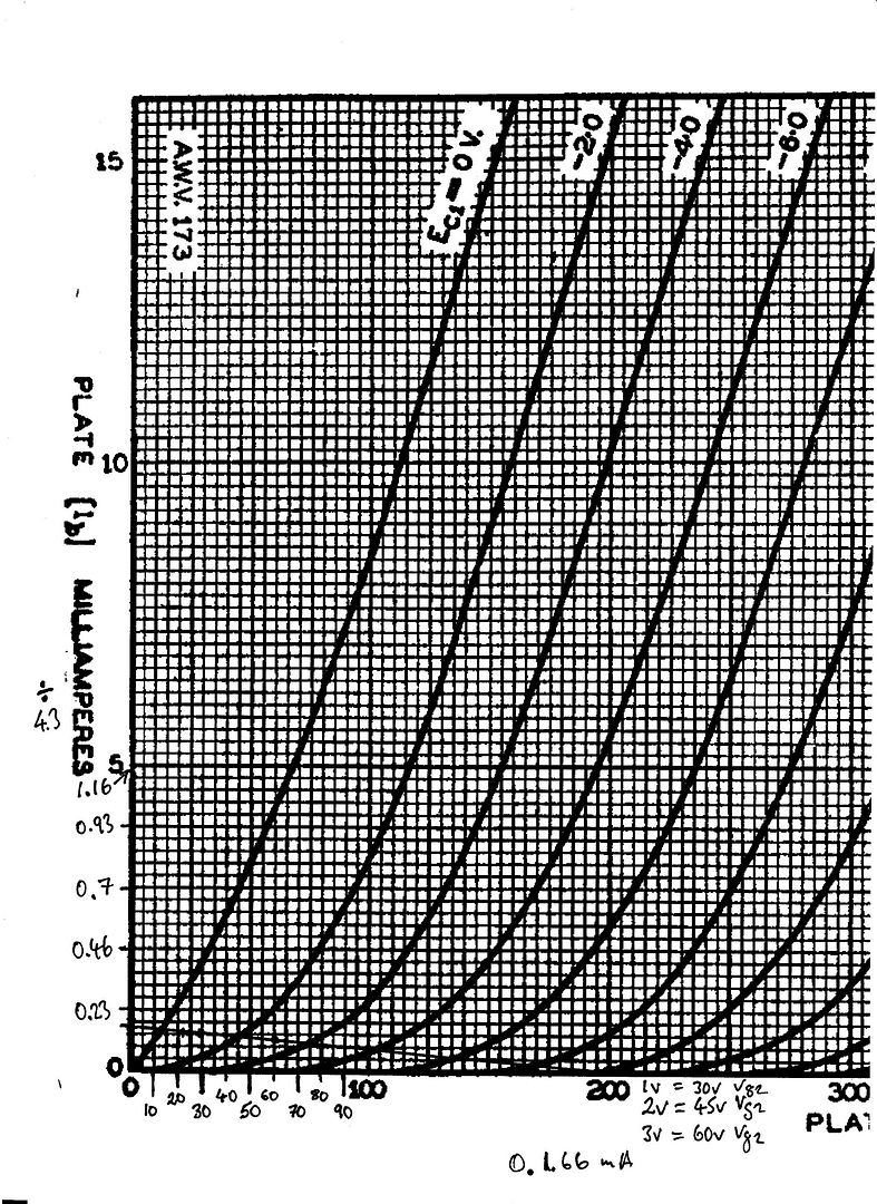

From this chart I decided to use a ratio of 4 for V3 and 4.3 for V1, ( V2 would be similar).  Starting with V1 first, I started a spreadsheet with a range of B+ values ranging from 260 to 200 (for the table I deleted the least relevant).
Next I used the info from RDH4 which shows that the G2 loadline can be drawn on the triode characteristic when you change the scale according to the ratio:-
Here you can see that I divided the current scale by 4.3 to give those odd values and at the bottom there is the 1.2M g2 resistor load line.

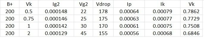

I put the values for 200V into the spread sheet and calculated the voltage drops and hence the current.  You then multiply the g2 current by the ratio to get the plate current.  With the total current you have the cathode current and hence the cathode voltage.
From the table you can see that the measured G1 voltage from the chart and the calculated voltage from the table coincide at somewhere between 0.75V and 0.8V, this seems like sailing too close to the wind to me and I would not have designed it that way myself.  I checked these figures on an actual circuit and they are correct at ~0.7mA.
Actual voltages for V1 are:-
B+208V,  Vp=76V,  Vg2=25V  Vk=0.74,    current ratio=3.93

Back on topic, I don't have a suitable inductance coil to measure the gain of V3 , so I will have to work it out from the data we have.
The DCR is 4k so on the plate chart, it's going to be a near vertical line.  The total current is Vk/Rk which is 2.23V/470 which is 4.745mA.  The screen current is (255V-110V )/130k=1.115mA.  So plate current is 4.745-1.115=3.63mA.
We can draw a horizontal line across the chart at 3.63mA and a 4k load-line from the B+ of 255V, the crossing point is the tube's working point.  The chart is not totally accurate as its for 100V screen current not 110V, but it will be near enough for our purposes.
The reactive inductance of a 400H coil is a massive 2.5M at 1kHz and the rp of the tube is also very high compared to the OPT primary impedance of 48k, so I just drew a loadline of 48k across the working point as shown on the chart below.
From this chart we can drop down verticals to the x axis at 0V and 4V on the loadline, these are the max/min before clipping.  From these points we can see that the choke can swing from 60 to 380V or a total swing of 320Vp-p.  The input for that swing is 4Vp-p so the gain is 320/4=80.  This does not have to be super accurate as it will be going into a feedback calculation with the gain of V2.
