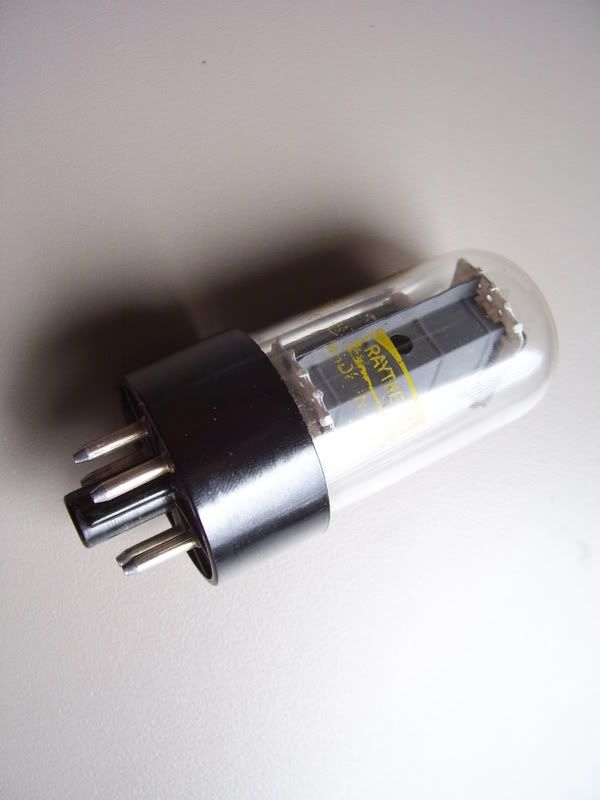

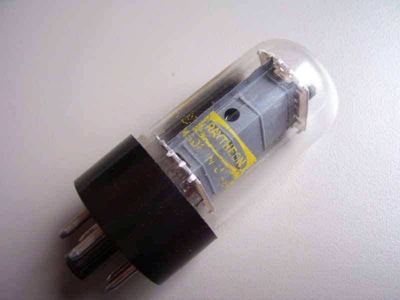

I have an obscure tube labeled "KWBA" made by Raytheon , made in the USA. Used as a power output tube on a single ended tube guitar amplifier. The Amplifier is a Gene Leis model 908, made in Manhattan Beach, California dated 1968. Would love to find a schematic for this amp too. its very simple 3-5 watt amp, kinda like a Fender champ but a different circuit inside. Tube compliment is 35Z5GT, 50L6GT, 35W4, 12AX7A. Filter cap is a 50mfd-50mfd/150V
I have looked high and low and cannot find a datasheet or cross reference on this tube anywhere on the web. It shares same pin compatability as a 6V6 or SL6. However it cannot be substituted for
a 6v6, I have tried to plug a 6V6 in place and it did'nt work on the amp.
Below are some pictures of the KWBA tube. I believe the tube is a
power tube because it is connected to a output transformer that feeds a small 8 ohm speaker. The rectifier tube feeding the KWBA is a 35Z5GT which is being powered from 120VAC line voltage thru a pilot lamp. There is no power transformer in this amp.

tried misting the tube but nothing. It must have been silkscreened but you know what happens to silkcreened tubes after 30+ years - it rubs off in a instant. I would try to picture the stamp on top of the tube but its only barely visible in the correct angle of light with the naked eye.
I will gladly send more detailed photo's of the tube if you think that would improve visibility. thanks for dropping by.
Maybe a 25L6 or 35L6

The RCA receiving tube manual takes a 25L6 and refers it to 50L6GT and rates heater capability at 50v ac/dc .
35L6 Heater rated at 35v ac/dc , these may be the tubes , not sure on that yet. but they are pin compatible octal types like the KWBA in the amp now.
the 35Z5GT is passing 42.9VDC from pin 2 to the "KWBA" power tube heater pin #2. If this helps any ..... basically "KWBA" is getting 42.9VAC.
looks like I'm closer to a 25L6 (25v) / 50L6GT ( 50v )

Bingo .....
Thanks Gus you just helped me solve this. The "KWBA" tube was really a 50L6GT or a 50V version of the 25L6 . I confirmed it by putting one in the amp and running it. It runs exactly the way the "KWBA" tube runs. this little amp really sounds great for low level guitar amplification or recording. It has a nice tube breakup sound when driven up in higher gain settings. It would make an easy inexpensive project for amp cloning.
