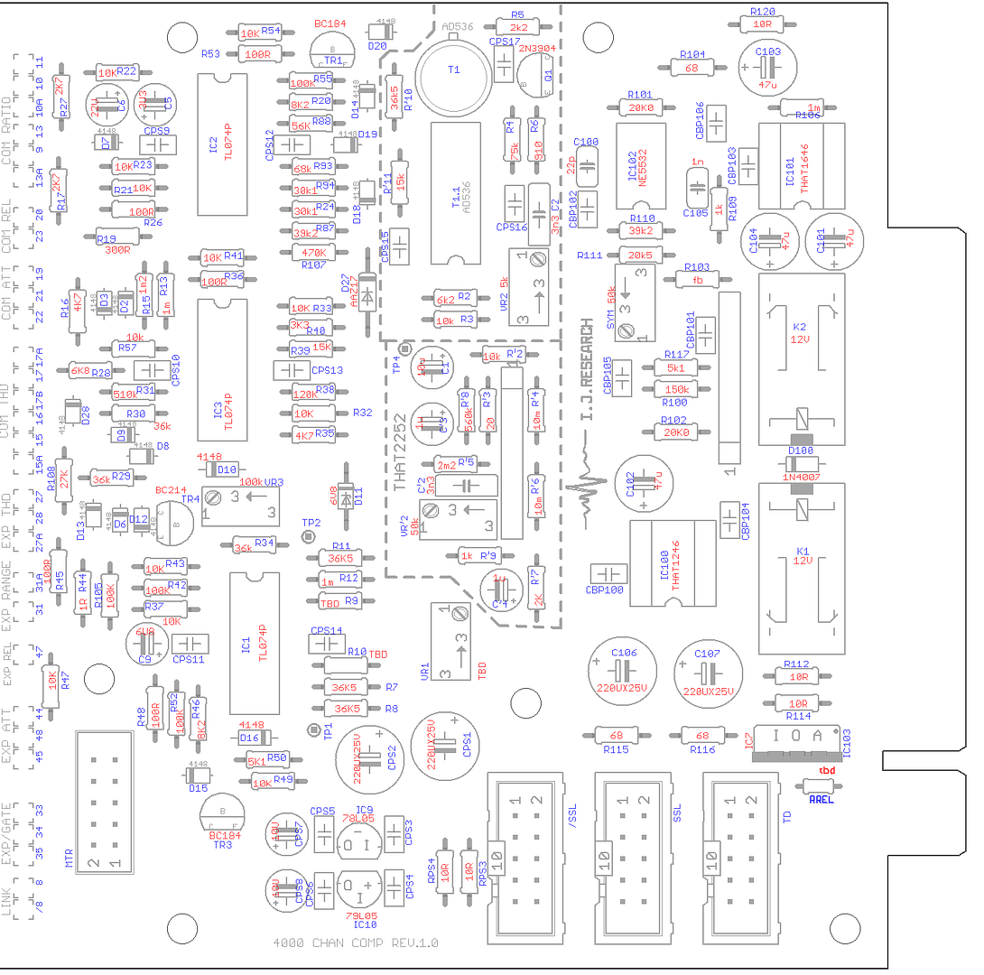

Well... After breadboarding some stuff with THAT2252 and AD RMS/DC converter, (this the HINT),
almost whole weekend was dedicated to draw this PCB:
The person who will give right answer first, will receive first set of PCB's with engraved front/metal work for free.
Features? Well, later)
Well, if so, here is the main thing:

AD536 is pretty pricey, no?  about 3x the cost of the 2522, IIRC.  maybe some can get the AD part but not the 2522 in their area...

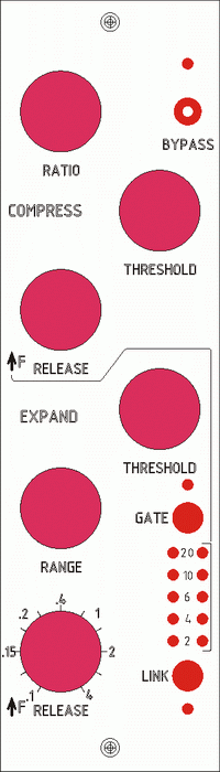

Some sneak-preview....
You see 4 boards, right?
There should be 5th board to make this thing DYNAMICS MONSTER.
The guess is 10-pin connector on mother board.
What is the secret add-on board???
Same, set of PCB's to winner.
Front (the work is in-progress):
Mother board:

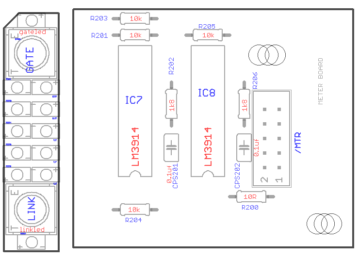

Meter and bypass:
