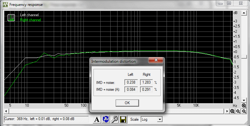

Kingston
Re: M670 compressor
« Reply #47 on: February 21, 2013, 03:18:26 PM »
For Gus,
Left channel: 10k load
Right channel: 620ohm load
Use of 10uF cap is a negligible performance improvement. Right channel then has -0.80dB at 10hz.
Gain drops 4dB at 620ohms (compensated in the above images). Some would think that a problem, but there's actually plenty to spare. And no change in THD%+N.
Kingston
Re: M670 compressor

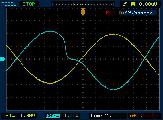

« Reply #48 on: February 21, 2013, 03:45:38 PM »
use of B+ feed R's at T2/T4 without 4.7 cap, so current balance through transformer in play?  Still takes 99% (guess) of current out of transformer.
Left channel: 4uf7 OT cap
Right channel: no cap
That bump in the frequency response is an artifact of the strangely dynamic cross-over distortion at low frequencies. Which looks like this at worst:
(yellow waveform with cap, blue with no cap)
This behaviour is consistent between all transformers and tubes (whether matched or not) I've tried which I've specified at length in previous posts. Looks and measures exactly the same with B+ at OT center tap with no possibility for the capacitor of course.
match loaded T1 secondary versus more lightly loaded?
I don't have a good enough square wave generator to reliably capture differences in transient response. When using 10-30k load recommendation from lundahl datasheet there is no difference in frequency response. My FFT measurement caps out at 40khz. Beyond that, who cares.
In short, Lundahl makes crazy good transformers.
That bump in the frequency response is an artifact of the strangely dynamic cross-over distortion at low frequencies. This behaviour is consistent between all transformers and tubes (whether matched or not) I've tried which I've specified at length in previous posts. Looks and measures exactly the same with B+ at OT center tap with no possibility for the capacitor of course.
Yeah, that looks better.   Addition of cap is also viewed as plate to plate AC coupled feedback, as opposed to DC coupled feedback.  Perhaps there's a feedback scheme across the original T2/T4 plans that would provide a parallel answer, and simple drop-in upgrade to the original.
Here's another one I maybe missed:  Obvious improvement with cap at T4 too?  Matters much there?  I do recall noticing the output amp distortion point in the original design was a limiting factor.  Maybe better with R feed, but maybe C addition makes little difference there?  If so also an easier retrofit.  Apologies if mentioned and braincells fail to recall.
In a way yes, and tied to triode current mismatch (if any!). I think this is the main mechanism for reduction of cross-over distortion, but the math is unknown to me.
Sorry, yeah you asked this already.
I didn't detect the strange cross-over behaviour at T4, so this combo is really a safety precaution with healthy paranoia. It's been a while since I measured sidechain in isolation and I don't have the data saved, but THD+N was way below 1% and since headroom is quite a bit above the vari-mu stage, clipping is a non-issue. In the end, it's just a really fancy battery charger.

« Reply #59 on: February 22, 2013, 05:44:44 PM »
What is the software you are using for testing?
Bruno2000
http://audio.rightmark.org/products/rmaa.shtml
What "soundcard" are you using?
I agree, point to point.
