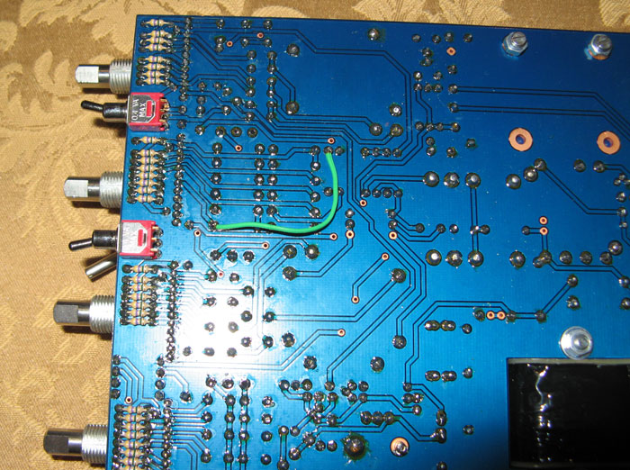

Finally I found time to take these boards out of the drawer and start fiddling around with this topology (bandwidth-limited non-inverting gain stages in parallel with 1st order -6dB slopes).
Am using 50K rev log pots without centre detents and matched and adjusted the pots for centre position (at about 12 o'clock'ish). R30 and R48 are adjusted accordingly (fixed higher resistor and trimmer in parallel to prevent amp from running open loop should trim fail) and centre positions are 'aboutish' spot on when switching internal bypass per board as well as additional relay-hardbypass for both boards. Also stuck a 150pf cap across the 22pf, so 172pf instead of my calculated 155pf, but good enough for my hearing.
I still have to rip out one leg of all filter resistors to measure caps to get all filters (caps AND resistors) as close to ideal values as possible. This latter is the second reason these fully populated boards had been sleeping for so long. Time, time, time is on my side, yes it is ;)

Pulled resistor legs on the PCBs today to measure caps in all filter sections. Then I ran the numbers. The idea was to first put additional small value caps in parallel (PCB underside) to get closer to the calculated cap values without having to add too many trimmers in the filters, which in turn messes with the individual gain stages.
But, turns out that my caps are all TOO good -- something like btw 1.957 to 1.996 for the 2uf caps and btw 196.7 to 200+ for the 200n) -- and calculations tell me I need cap values that are lower. THWARTED !!  Will try to scan the stash for resistors that are so badly off they might actually match the installed caps. I still shy away from adding up to 10 trimmers per channel just for the filters ::)
So, funny circuit this one indeed. Makes me wonder how the original commercial unit (with patent, what?!) could have ever been advertised for mastering in the first place  :o An additional opamp gain stage between each filter section and pot (four or better six amps per channel) might have solved this elegantly. Still an option in DIY though, hmm...
On the other hand, cap values might drift off over time. So being able to trim the HP and LP filters individually is not too bad an idea. Maybe I first focus on the 160Hz and 640Hs only -- as I can even hear one channel being off around there. Unit is gonna look ugly inside, haha !

Matched a total of 20 resistor combos to match my optimum calculated cap-derived values. It took longer than I had hoped but not as long as expected. I used an online calculator that suggests up to three resistors in series and parallel to derive any desired value. The rest is trial and error with real-world resistors.
Examples:
I need 507R on one channel, 506R on the other. Found one of them in the 511R stash. Same with 4998 in the 4K99 stash, I think. Overall  only three single-resistor solutions. A couple of values are two resistors in series. But the majority is two resistors in parallel. I have many resistors with unusual values flying arond, which makes it easier. Luckily, I never had to used three resistors (i.e. all in parallel or one resistor in parallel with two in series).
Deviation from my optimal calculated resistor values is now +0.116% in one of the 640Hz slopes. Finding the exact values turned out to be a slightly tiring (although usually I enjoy my matching meditations) especially in the low resistance value areas, where 126R4 or 126R8 (for the 640Hz slopes) makes a difference when 126R6 is needed (in my case, 126R4 was 1.7Hz off, not much indeed, but once at it, why not go the full way). Same with the 1280Hz slopes (schematic says 64R9, but I need 63R6 and 63R1). This made me think that using lower-value caps for those bandwidth-limiting slopes might yield closer (matching) results.
Trimmers in parallel with a fixed resistor are probably still the better/faster option, but it gets tight on the boards. And for me, this is an academic excercise anyway. So I can't wait for caps to degenerate over time and then having to do the parallel matching of fixed resistors all over again ;)
Now I need to make some time to solder it all in and then, as a last step, figure out how to solve the gain deviations inevitably introduced in all stages. Will probably simply offset the 0 points on the knobs (I have no centre detents), because unit will be used in Mid/Side processing only and I do not need full boost or 'cut' (i.e. boost below unity gain) anyway.

« Reply #1253 on: March 06, 2021, 06:30:51 AM »
Spend some time on getting the gains right using the pots on the front. The best I get is mild dips and bumbs with a max of about 0.2 dB off unity gain. Not bad, I'd think.
For me this was an academic investigation into how well 'filter' frequencies can be optimised using only resistors (not trims). I knew from the start that this was a futile endeavour, because I use pots without centre detents. So it was clear that by the time I screwed the knobs onto the pot shafts, the centre positions would most likely be slightly off again -- yet they are all at about 12 o'clockish now.
Centre-detented knobs are still an option, although knobs without centre-detents and without indicators might even be more enticing to me. With only a few knobs per channel, I now simply dial the knobs without looking until it sounds good (in testing I mostly ended up with mild settings anyway), and if I need zero, I simply flip into full hardbypass.
To anyone who builds this unit in future:
- there is no need for high-precision caps or resistors. Get caps, install and measure them. Then the correct resistor values need to be calculated anyway. Could use resistor combos for that, but trims are probably better.
- meticulously matching of caps makes sense only in the air bands (L and R)
- stepped pots are an option but I'd believe they would require that the gain of the individual stages is spot on before any signal hits those stepped volume switches (probably a trimmer before the stepped volume switches ?).
- full boost (up to 20dB on paper) is most likely not needed
- clip indicators can easily be implemented (using the two unused opamp halfs of U4 for input and U6 for output), but I skipped this as I don't use that much gain in the first place
- a volume knob before the output might be useful (or not)
- highly recommended is being able to hard-bypass (at least my unit sounds a tiny tad 'bright' and/or a tiny tad less 'beefy' in the lower range even in soft bypass -- not necessarily a bad thing though.

Just to finish this off. I had tuned the gain stages using 'filters engaged' versus 'soft bypass'. Also checked 'soft' versus 'hard' bypass. There was a slight offset in AC readings from input to output. Tuned it to exact readings using input trimmer and now the unit 'feels' a tad louder when engaged (could be the two Burr Browns I used as I had not enough NE5532s). Anyway, I guess that a tad more subjective loudness when the unit is engaged turns it into a real 'product' , hehe ; )
