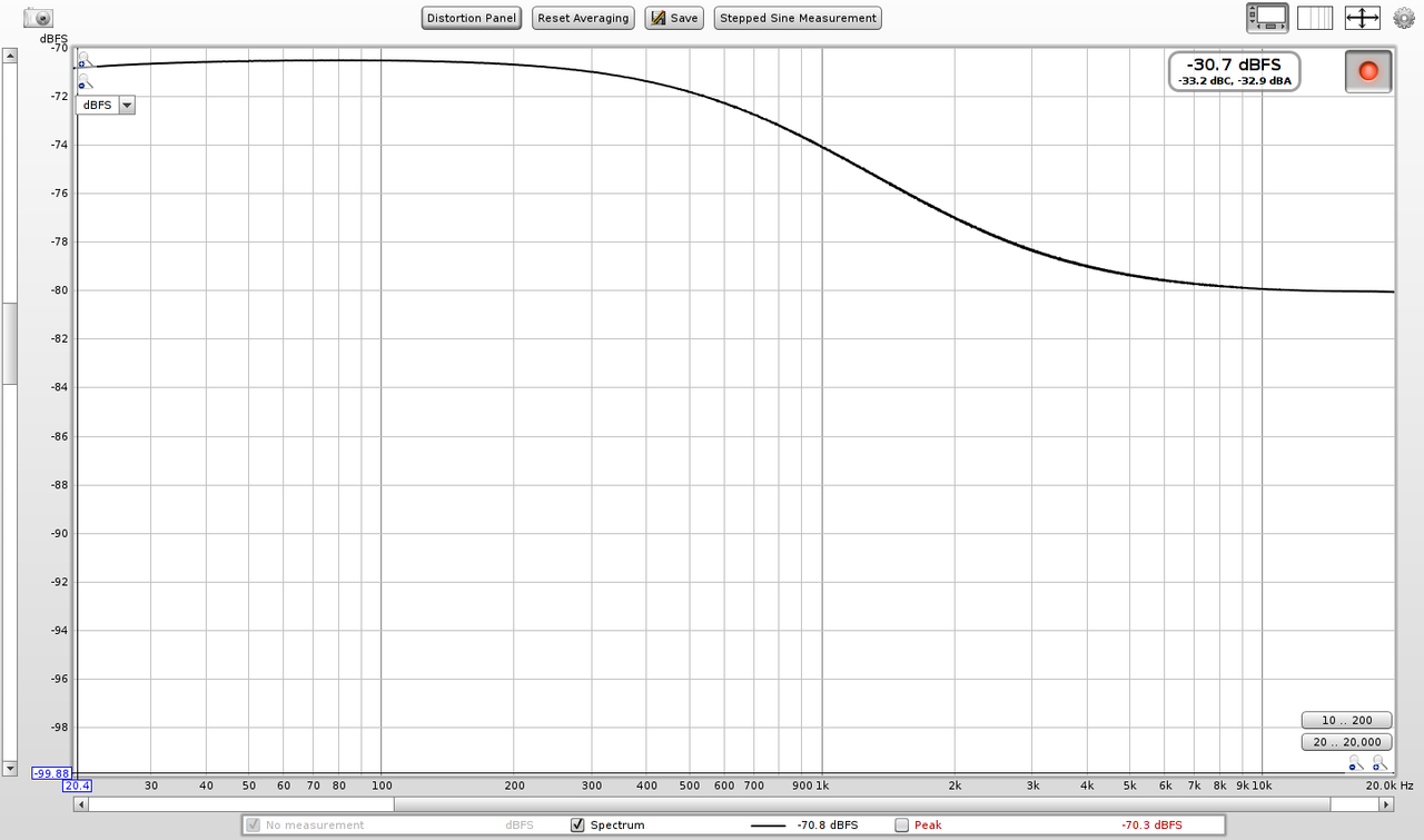

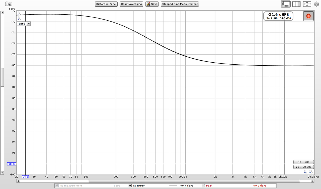

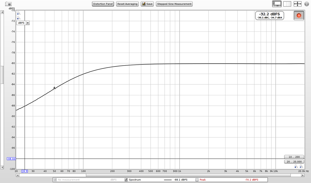

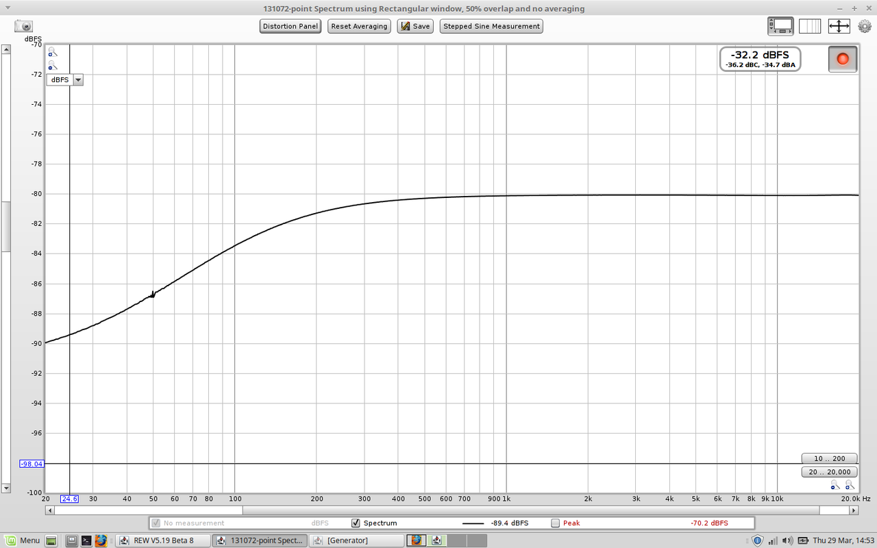

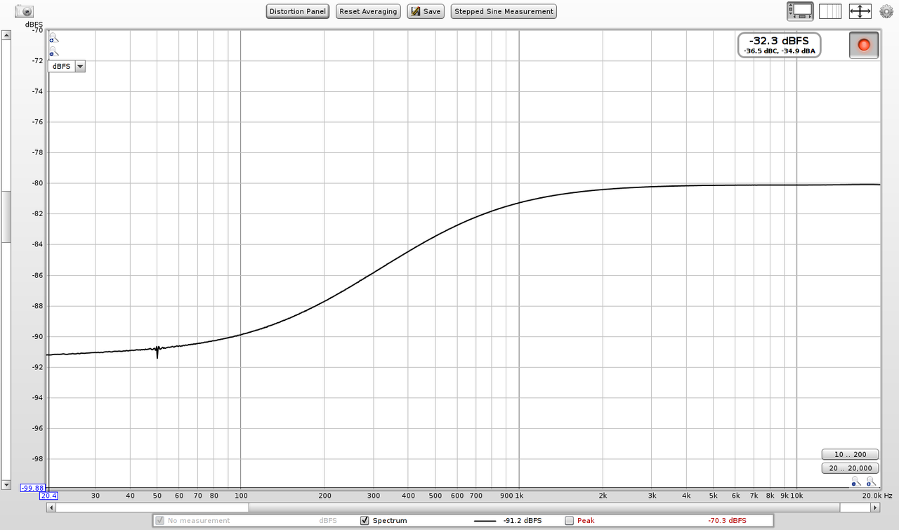

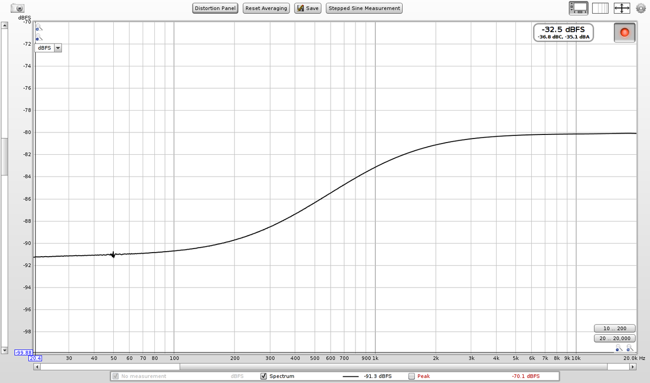

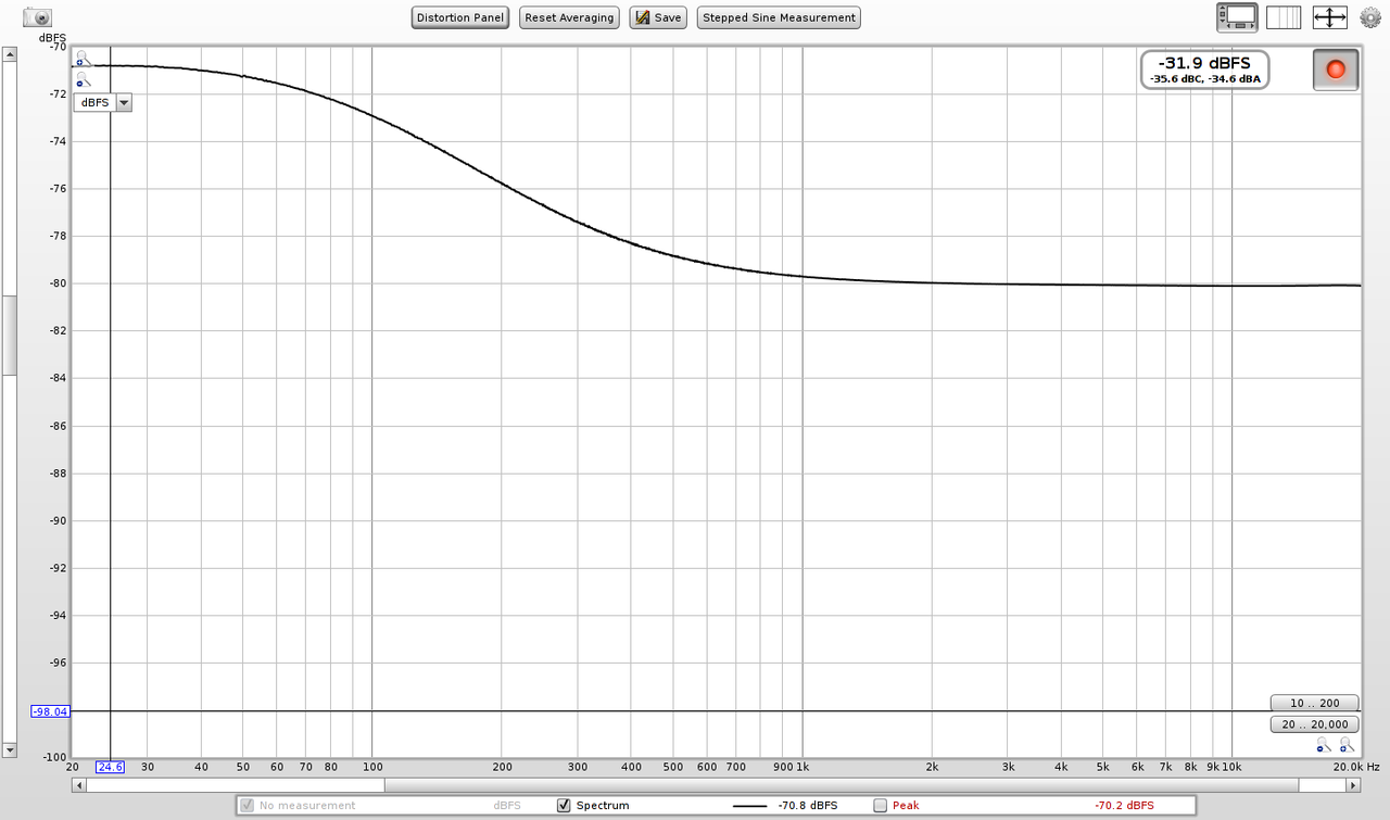

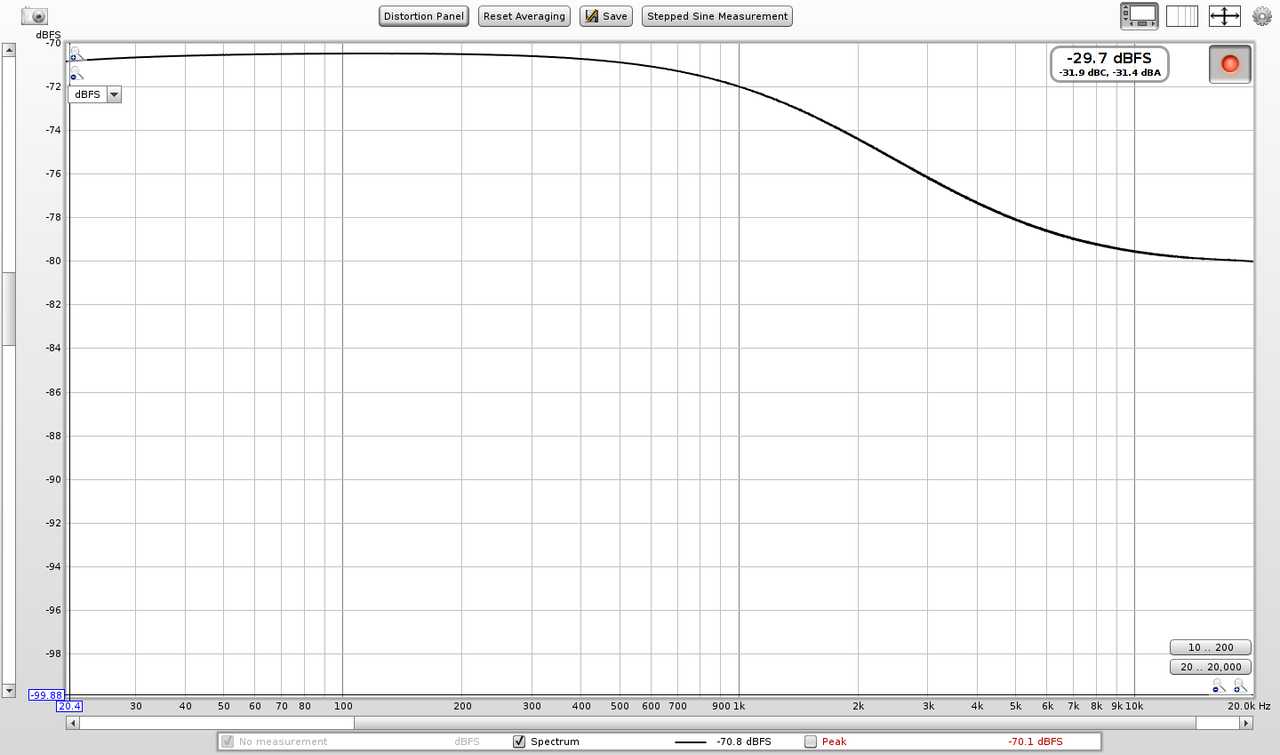

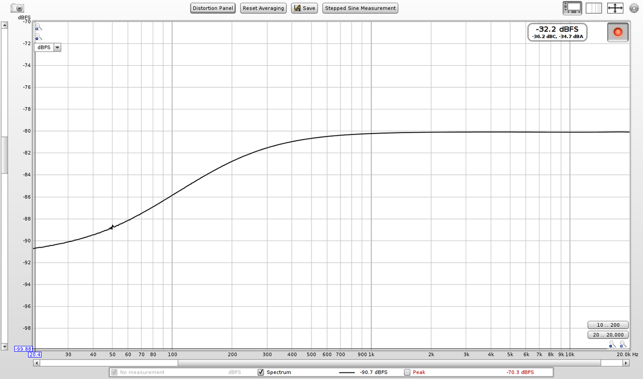

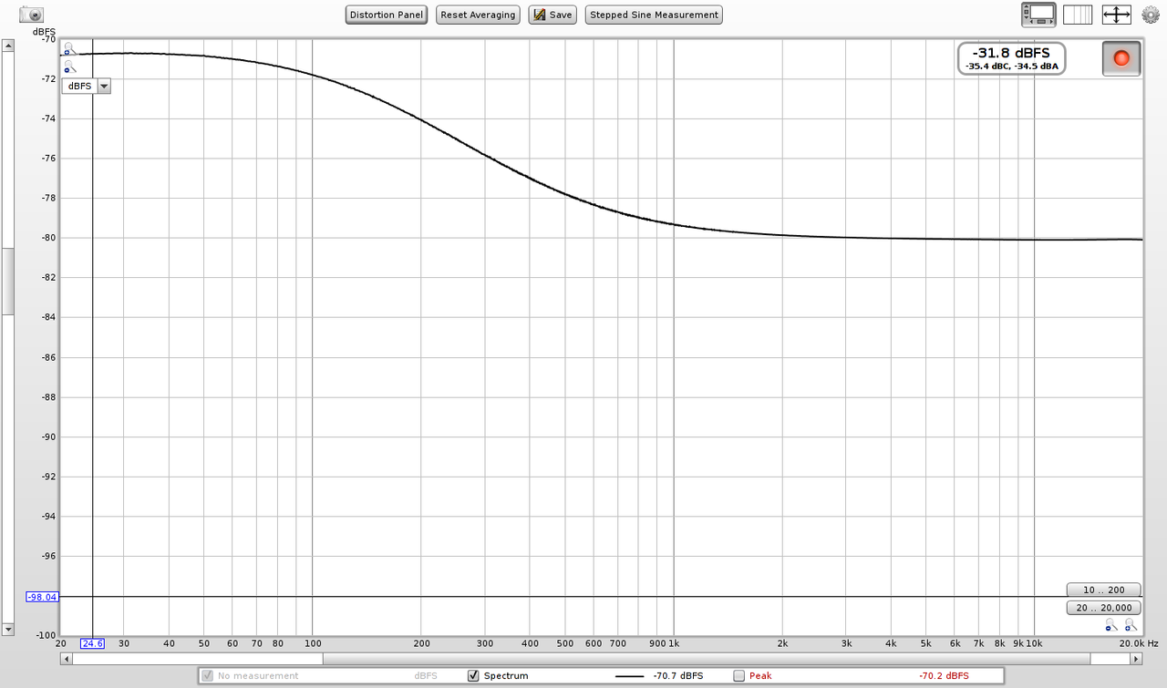

I just finished testing a shelving version of the lowest EQ band, because the first customer wants the bottom most and top most bands to be shelving rather than peaking. I used the same inductor as used in the peaking version but the inductor values may need altering.
There seems to be no accepted definition of the frequency of a shelving EQ so the following plots are listed by inductor value. Draw you own conclusions about how you would define them:
750mH boost and cut:
500mH boost and cut:
300mH boost and cut:
200mH boost/cut:
100mH boost/cut:
55mH boost/cut:
Unlike the peaking version, the turnover frequency is different for cut then for boost. This is because the basic attenuator is 10dB so the resistance of the lower arm is less than that of the upper one.
